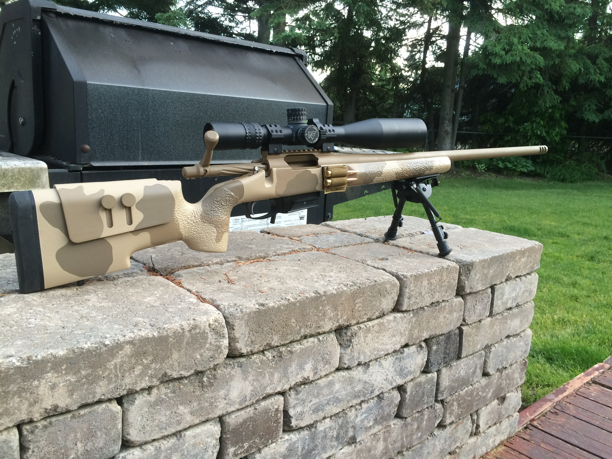

I’m getting ready to start barrel number for for my .260. It’s been a favorite and standby for a number of years now. I don’t think that I’ll ever not have one.
Mine is and has been a 26” barrel in M24/MTU/Heavy Varmint, so far either Bartlein or Rock Creek, 8 twist.For PRS and other field rifle or precision rifle matches, I do not prefer a tight match chamber and had one opened up to right about SAAMI spec. I found the match chamber to be too tight and finicky for reliable and consistent feeding. I still have no problem getting single digit SDs by using very consistent loading practices and neck tension.
I still am using the original Stiller TAC30AW action and AW mags tens of thousands of rounds later and see no reason to change. It sets in an early Manners T4A stock with mini chassis and the forearm is most often supported by my standby Harris bipod, just because it all works. That said, I will likely get another more modern and more expensive bipod someday for this rifle. I already have an LRA for my ELR rifle and an Atlas CAL. I just haven’t gotten used to anything that works right yet.
Mine is currently topped with a Steiner T5Xi 5-25 which works quite well. Had I the extra cabbage, I get one each of ZCO, Nightforce 7-35 ATACR and maybe a Minox to check out and likely use one of them.
All that having been said, I am on the down slide in competition involvement currently and haven’t had either the time nor funds recently to try and stay competitive. So I mostly attend matches just to compete with myself and enjoy the camaraderie.
Oh and also, I recently completed a similarish build in 6 BR, using a 27” M24 7.5 twist barrel. Not great timing considering the current ammo and components situation.
