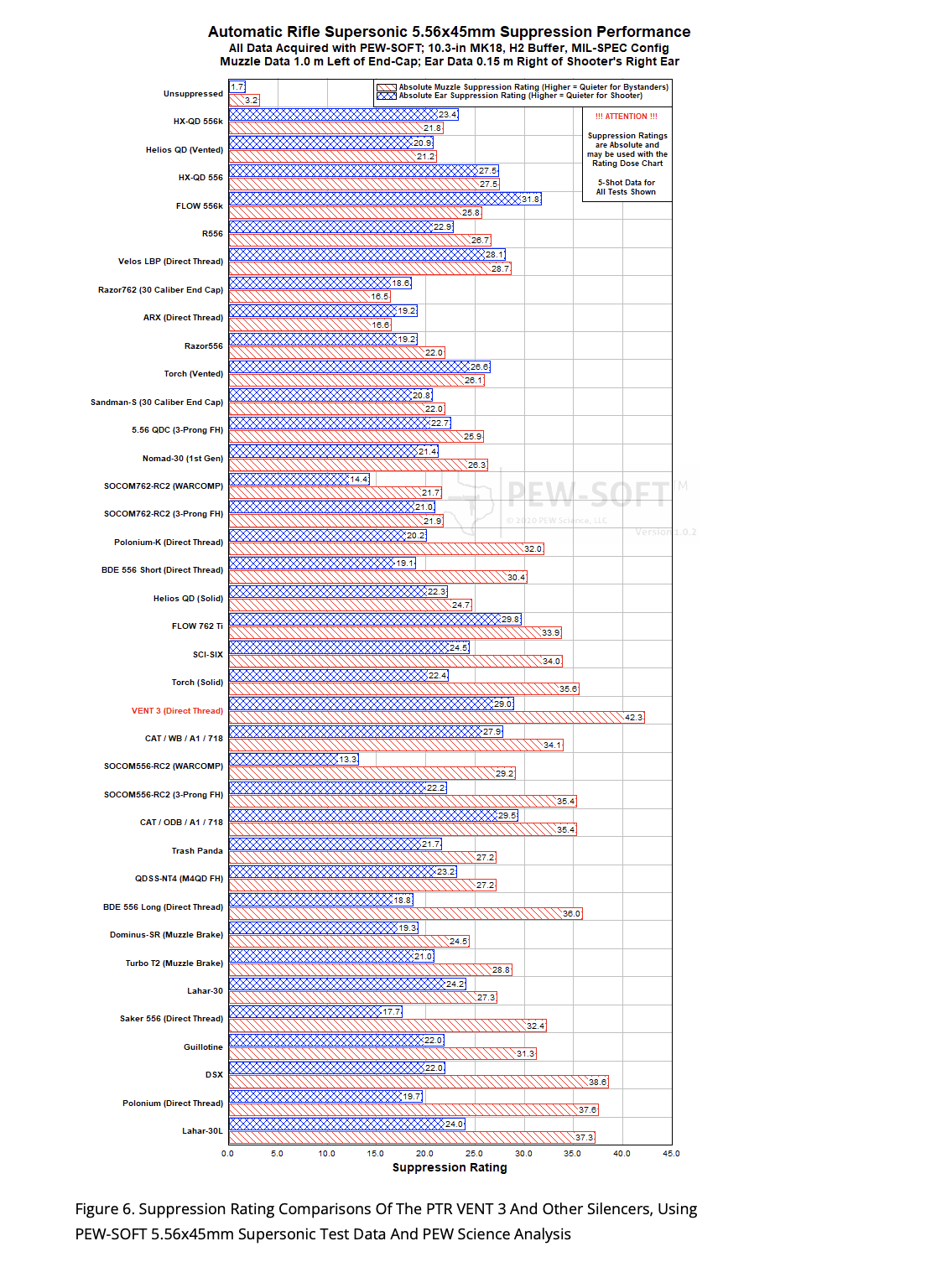

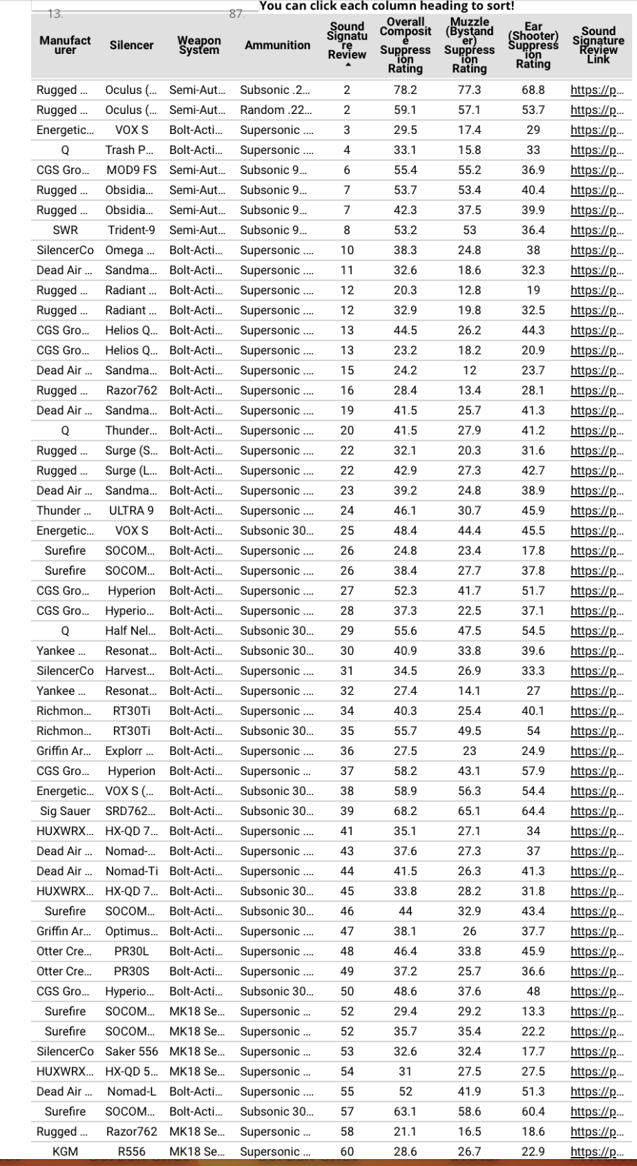

PewScience is a lot to take in- I don't listen to the podcast acts or YouTubes- rather just look at the dbs and back pressure of silencer A vs B vs C, knowing they're measured consistently, see how long /heavy/expensive they are.
Alright, I’ll be the first to mention PewScience…
His “Pew Rating” gets lots of grief, but his methodology and measurements are done with consistency, so you are getting an apples to apples comparison when you’re looking at the numbers posted in the comparison charts.
I skip some of the technical discussion as it’s frankly beyond me, but the summary paragraphs, helpfully in bold type, at the end give great insight into the pros and cons of flow through vs high pressure va newer printed hybrid designs .
His stuff while most likely very accurate takes a translator to understand. So I don't even pay attention to his findings. He needs to put it in layman's terms for the normal guy/gal.
are we at high school, shitting on the smart kids again ?
I'm a layman, the website is clear,- go to the "lab staff opinion" at the end of any review for a quick summation or look at the comparative silencer v silencer ratings...If you're technically minded, all the detail stuff is there - if you can't be arsed to put minimal effort in, or Youtube is peak learning, then throw your money at whatever
or look at the searchable rankings.....
If anyone right now can offer up better/ clearer/ more comprehensive reviews, then they should get on with it, I'll be a subscriber- sure many others will be grateful.
View attachment 8312727 or look at the searchable rankings.....
