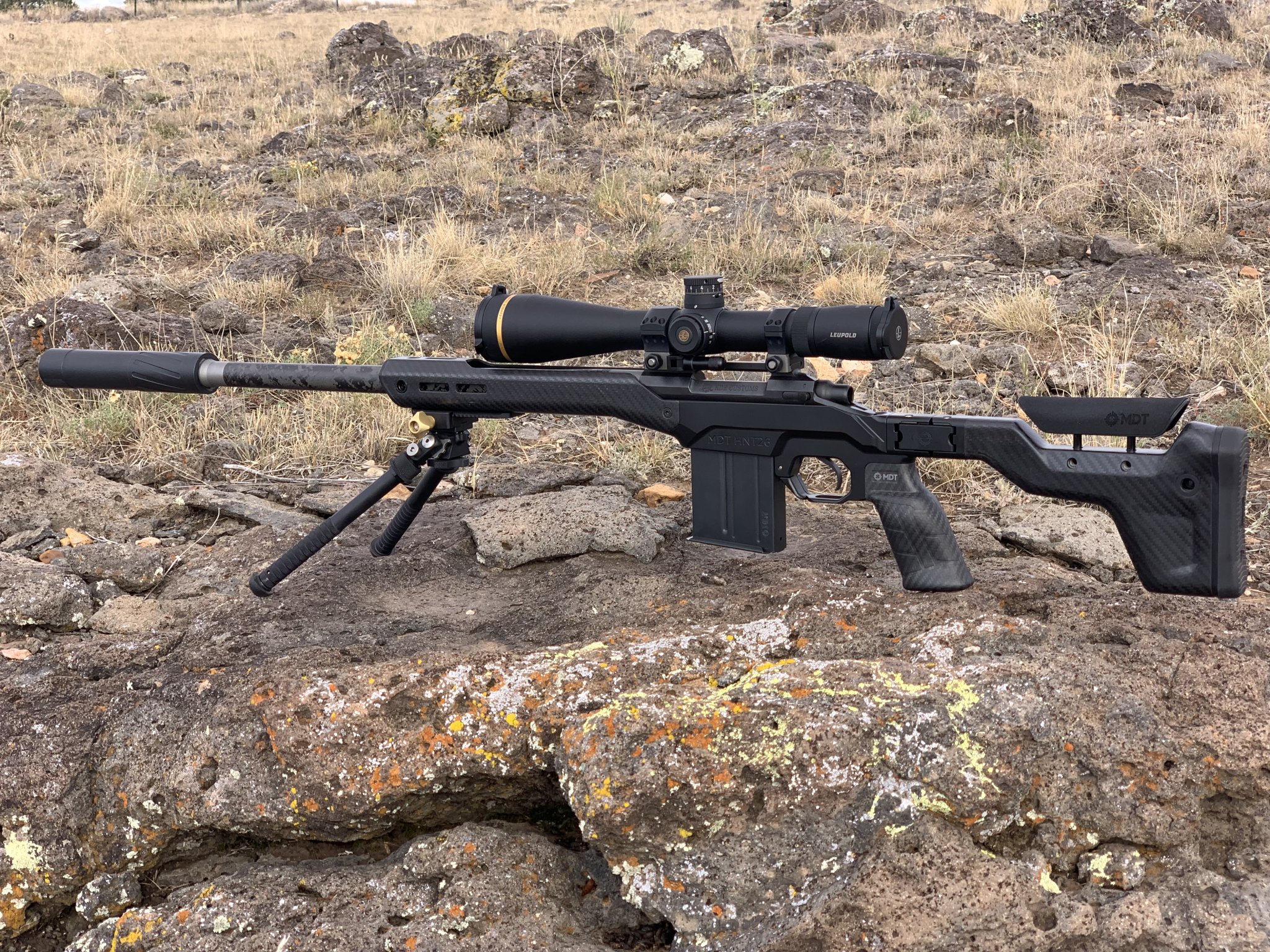

My particular HNT26 twists and flexes like mad on the tripod and bipod. It shows at the reticle and target.
It seems to me like the forend itself is rigid enough, the connection to chassis seems to be most of the issue. I've considered epoxying it permanently if I could figure out good way to remove BA when needed. Almost certainly that would require some material removal from the forend " bridge".
Anyone tried this or have another solution ?

As @Supersubes said, it's more of a perception thing than a functional issue. All of the HNT-26 chassis that we have sold have had the same level of forend flex due to the design of the interface. For some people accustomed to a one piece stock or a very rigid chassis, this will be noticeable, however, it is a tradeoff of the weight savings that we have accomplished. If you are coming from a background of ultralight products and factory stocks, then the flex is less noticeable and more normalized.
Not being a company to sit on our laurels and accept mediocrity, we are trying to find ways to improve forend rigidity, keep the weight the same or lower it and provide the customer with the best system possible. After a few years of HNT-26 production, we've learned a lot and will build off of that knowledge for the currently released CRBN stock, as well as future products!

After MDTs response, I reread this thread and then had to recheck this out. I had an MDT HNT26, Manners EH-1 (with arca), KRG W3, KRG X-Ray, and MDT ACC elite handy as well as an RRS with Anvil30 head.
I’ll say that as a standard practice, I look to establish proper NPA regardless of bipod, clipped in tripod, or bag on tripod/prop/etc, as I’m sure most/all do. When clipped into my tripod, if I really try torque’ing the rifle, I can get about 4mil(ish) of “flex” from all setups, which can be seen as movement of the ballhead - ballhead lock is fully engaged. In real life, if I need that much movement, I unlock the tripod or reposition the rifle. For me, I’m not seeing the issue that is being described. Maybe I’m missing it. I also clip in at the balance point, which is close to magwell.
I will say that I had an out of spec forend initially with my HNT26, and that was noticeably underperforming. Maybe that is a contributing factor for some. Maybe their ballhead, tripod, or bipod are also contributing factors?? Maybe they are clipping in at forend tip for some reason?
I’d have no issues buying another HNT26 at this point, even given MDTs response.

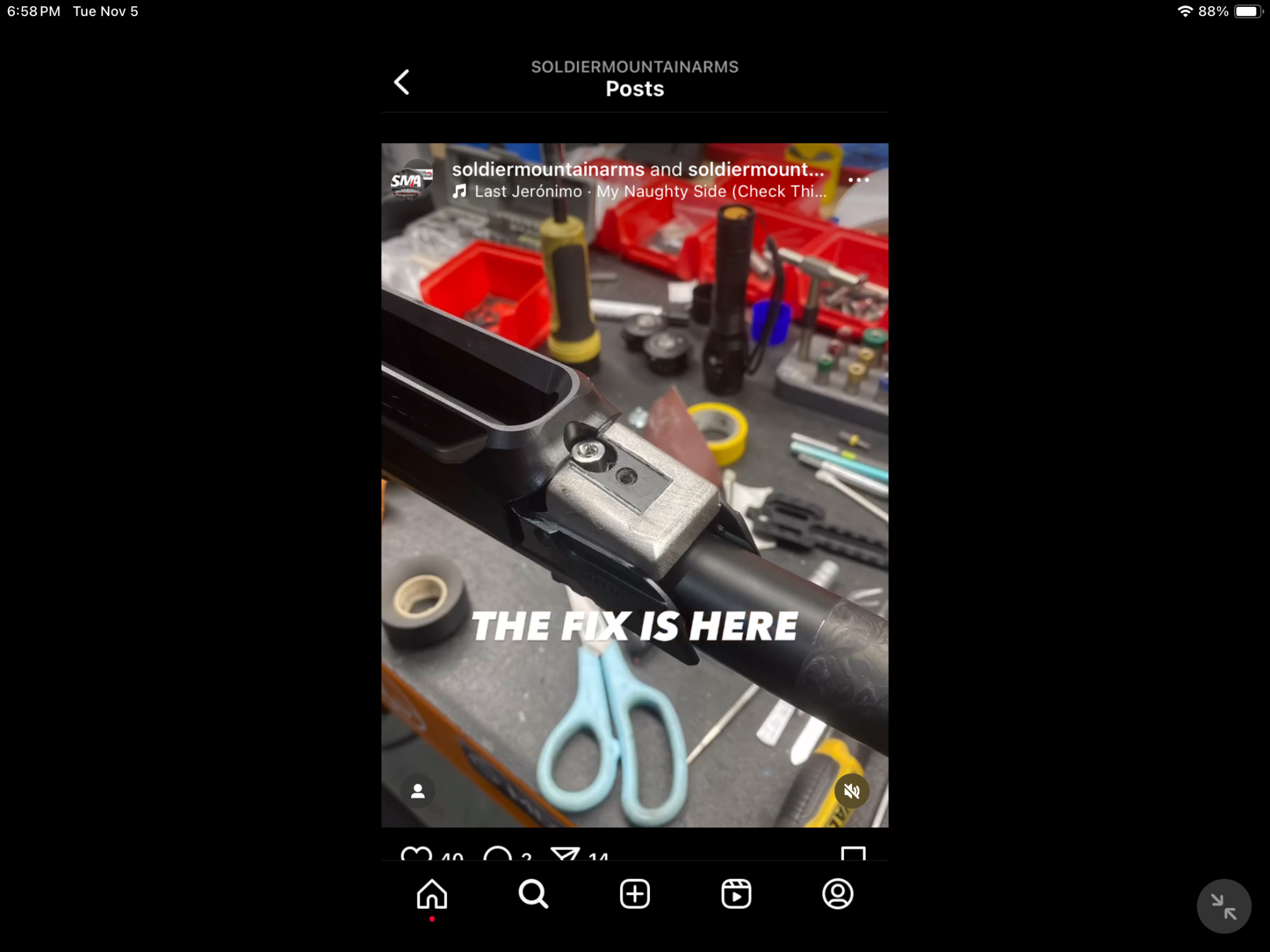

Soldier Mountain Arms developed a ‘HNT26 Fix’ this year. Sounds like it addresses the issues described. It should come from mdt without needing a fix, with what they cost. I don’t have one, so this is just a FYI
