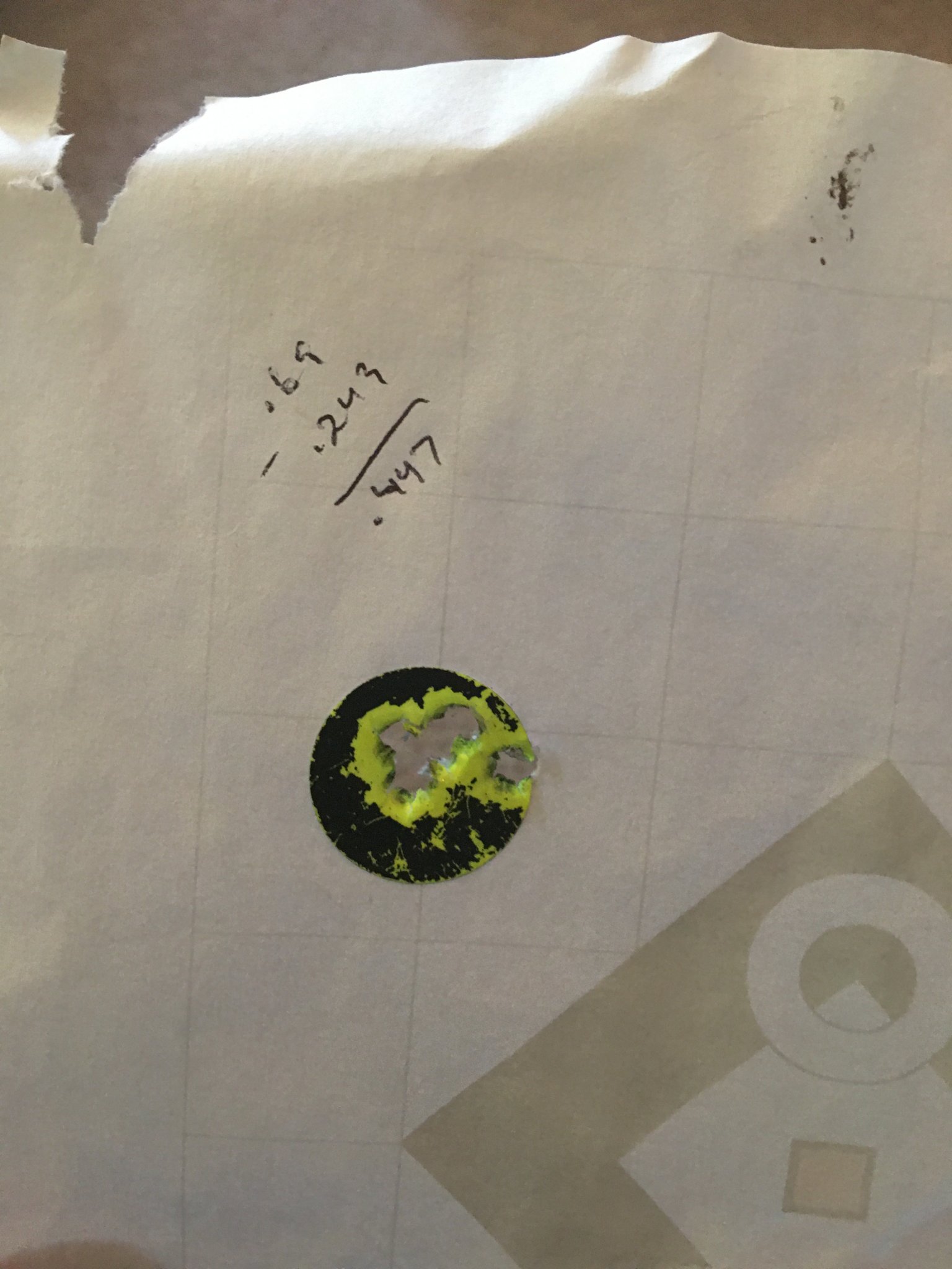

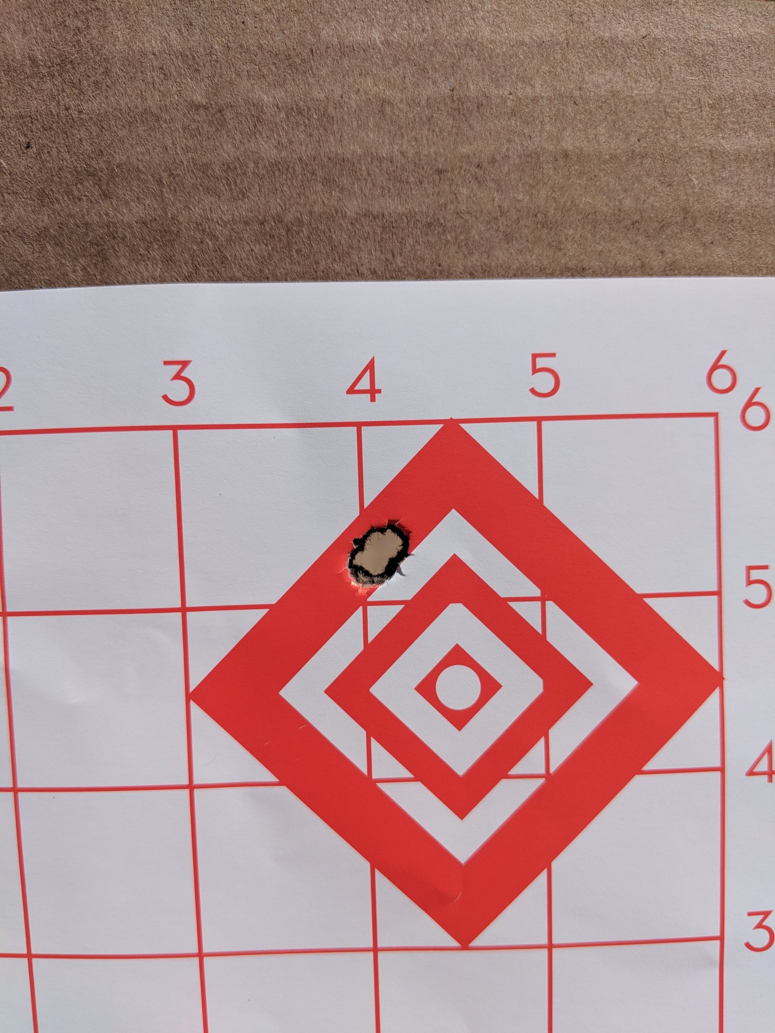

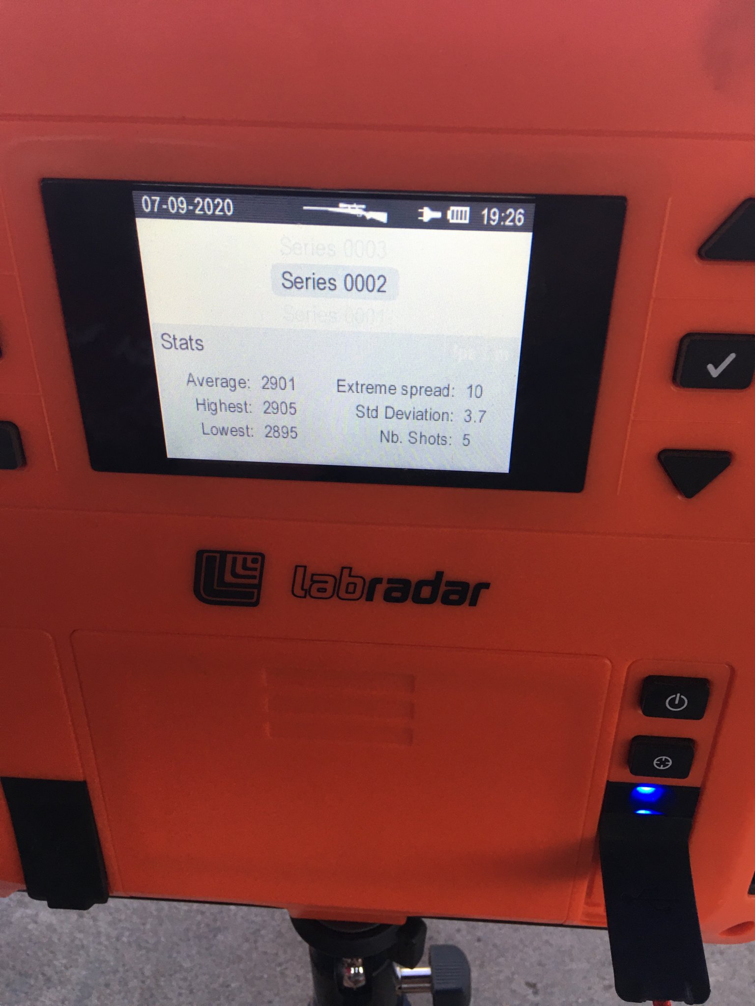

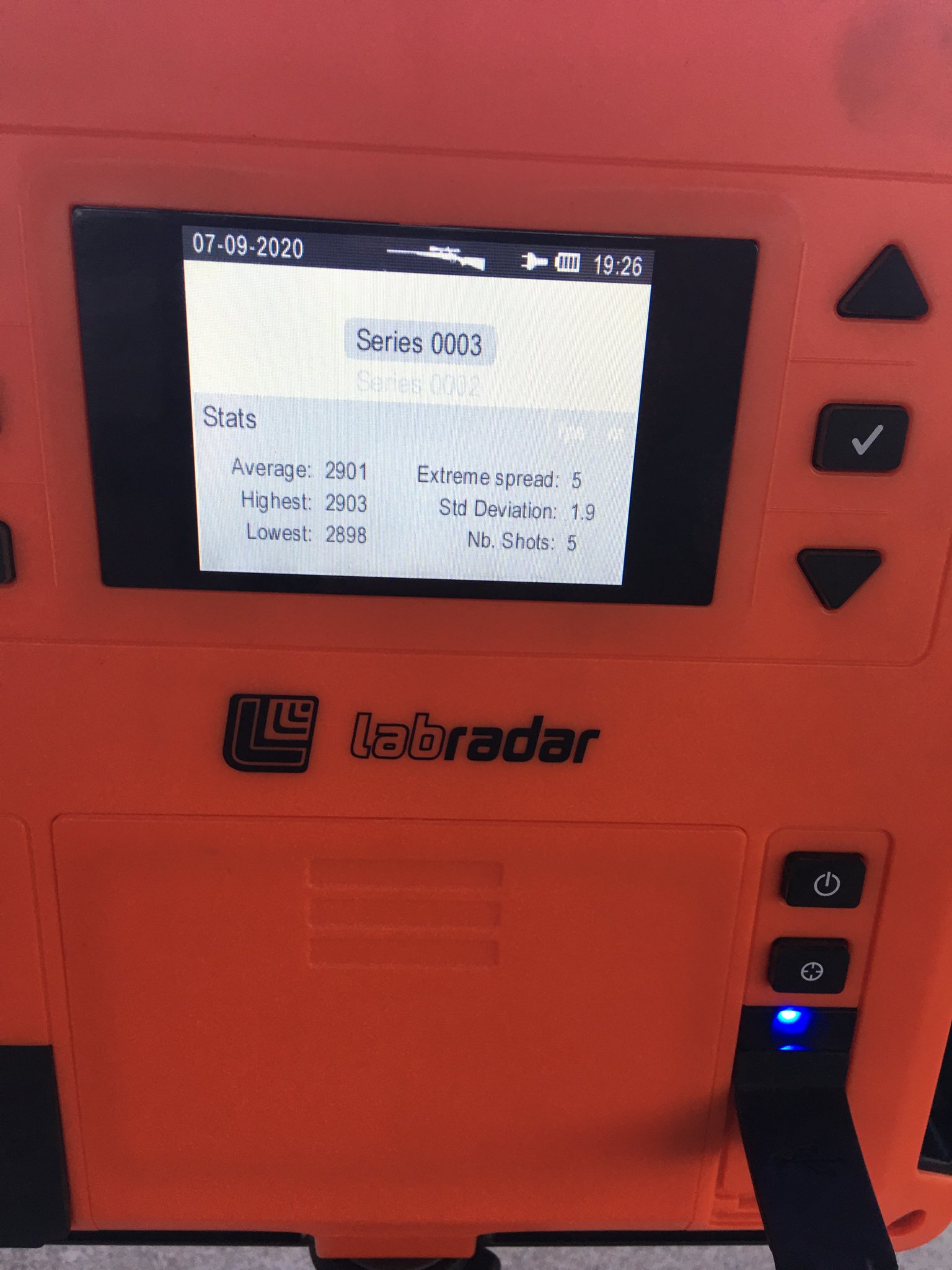

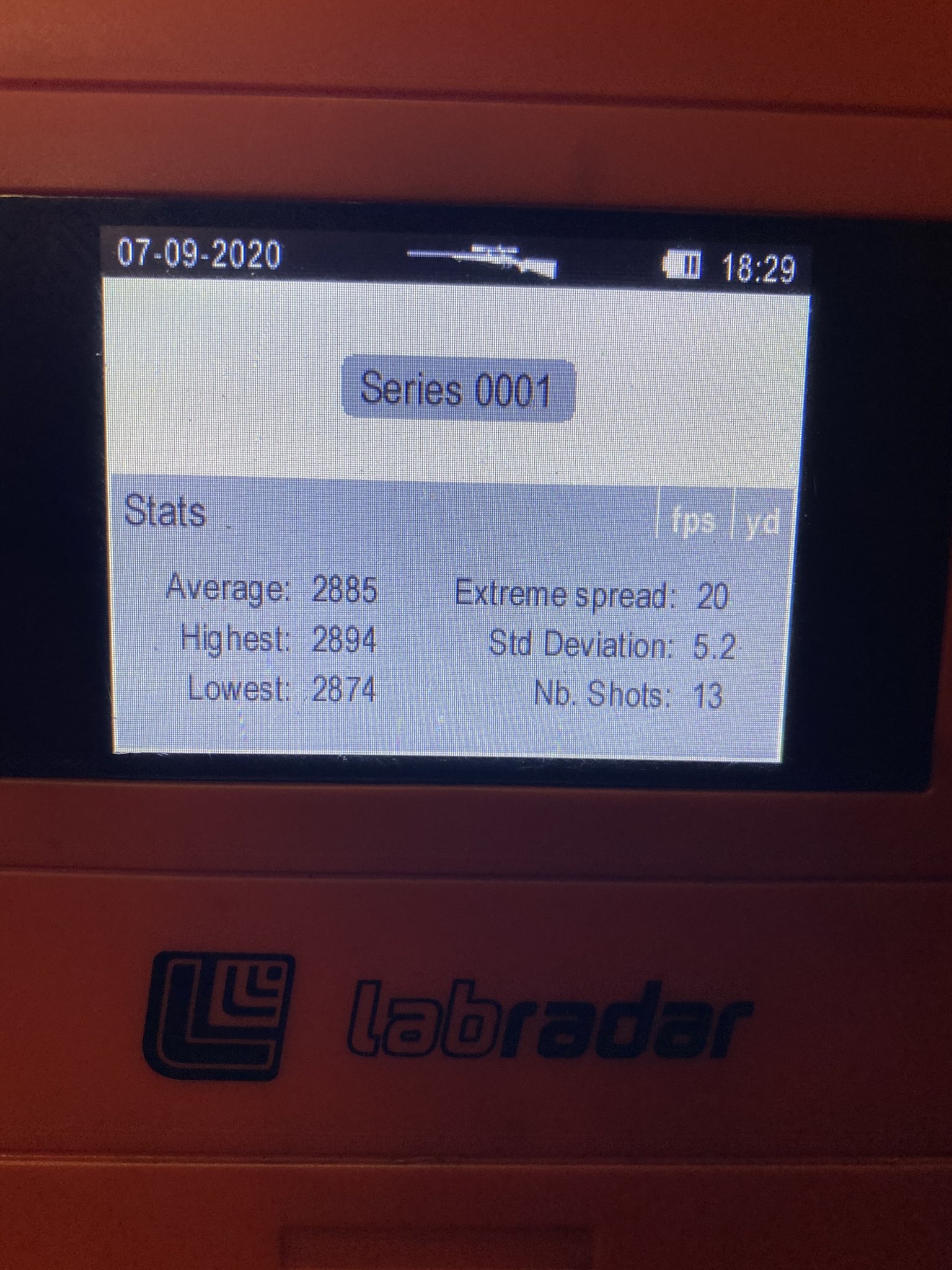

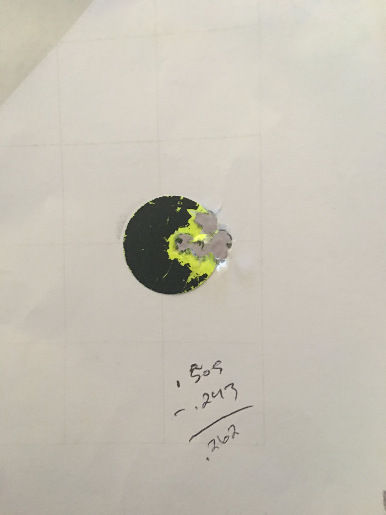

I am not doubting others here but so far the 6GT is shaping up to be my favorite 6mm easily. It has fed just fine from AICS standard mags in a Bighorn Origin.
I literally did zero load development on the pictured load, 35.5 grains H4350 pushing a 109 Hybrid. Barrel break-in is done, I’m getting 2901 FPS avg on the dot with both once fired and virgin Hornady brass that costs 70 cents per. I didn’t chamfer, de-burr or mess with primer pockets. Literally load and shoot.
I pulled that one in the pictured group(16mph winds) but this thing has shot in the .2’s and .3’s since I built it. Maybe I just got a great barrel.
The chrono numbers are phenomenal too, from two chargemasters no less.

Keystone Accuracy did my GT pre-fit on a Krieger blank. It is hammering as you can see.

I did load development last night for my dasher and I see what all the hype about BR cartridges is. I shot a ladder from 31.8 to 32.5gr and every single load had an SD of <6 and a max ES of 11.
I’ll advocate for straight BR. 105’s running 2885 in a 27” barrel and low single digit SD’s every time I’ve ran them over a chrono. I have no reason to go through the hassle of fire forming brass with the excellent results I’ve seen from my BR. Attached is the chrono data I got last night.
30gr varget with 105 hybrids. Zero effort in reloading
