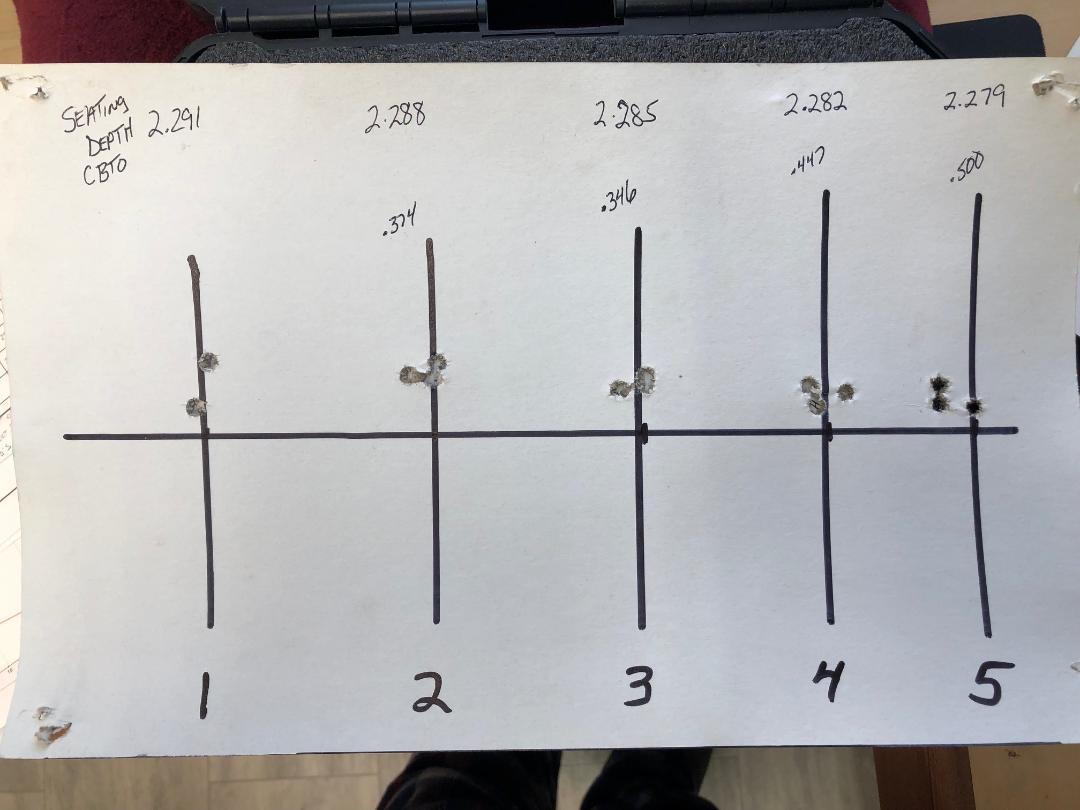

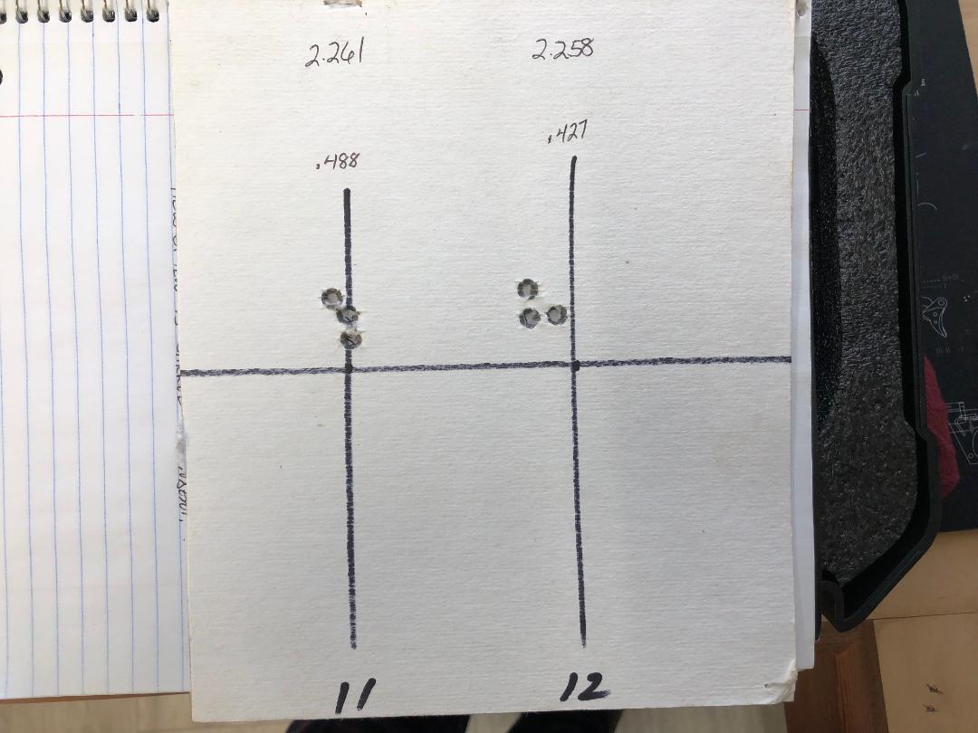

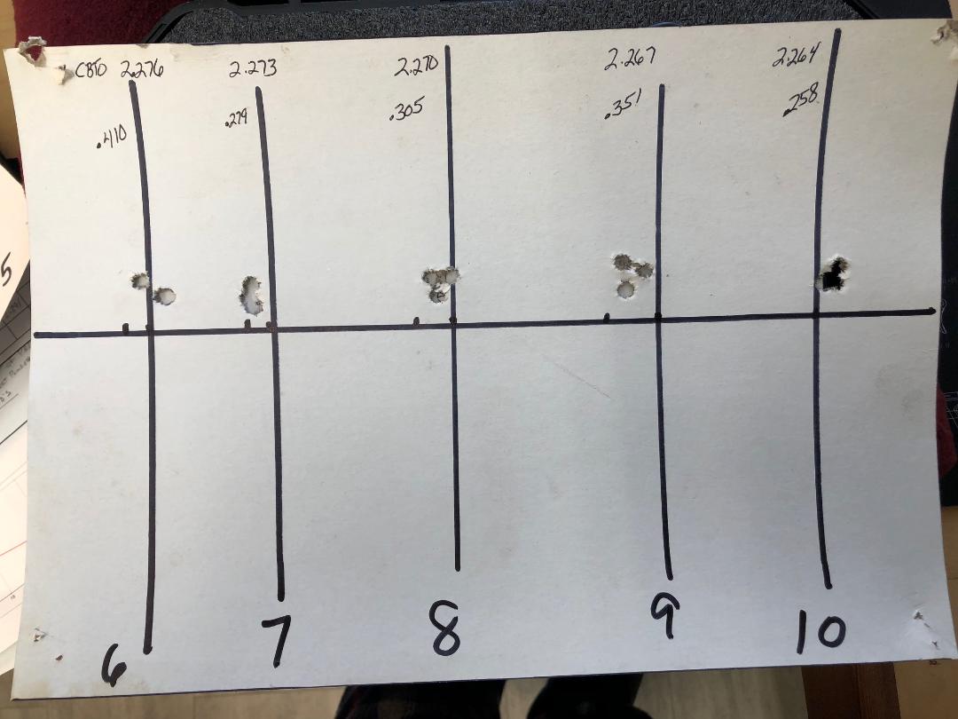

This is my first seating depth test and from what I understand I am looking for 2 nodes that are together and not just 1 kickass group. I think I see where I want to be but could really use more experienced eyes on my groups and hopefully shed some light on what you see ! Don't know if all this is relevant or not but here is the gun and the load.
Tikka tac a1 t3x 6.5 CM using a factory barrel suppressed
My load is 41.2 gn of H4350 with 143 gn hornady eldx bullet. I wont bore you with anymore unless needed.
Exclude # 1....I goofed that string up
3 shot groups
Reactions: simonp
As far as choosing loads that are in the same spot, (point of impact), to each other, I use the OCW approach to do that. Then I will try different seating depths and choose the best group. I'd load up some more at 2.264 and see if it will repeat.
OP, you have a charge weight of 41.2gr H4350 with a 143gr bullet - squarely in the H4350 "window" for that weight range bullet - and you have several targets showing quite competent grouping. I'd say you're mostly where you need to be; pick one of those depths and run it.

... I just noticed that the tested depths in your second photo are only .012" min-to-max, and all of those groups look pretty good to me. One of Berger Bullets' Tech Talk articles - I didn't look for the exact one - describes an optimal seating depth node as being ~0.015" wide - and your groups show that.
I tested my 6BR depths 0.020" apart and verified the best by firing more groups 0.010" apart. Reality is that barrel erosion is going to quickly erase really tight depth "nodes."

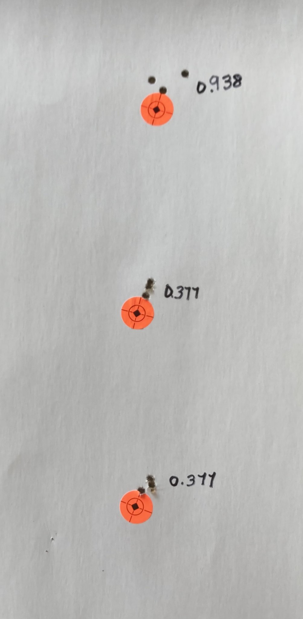

It looks to me that you shot one group for each seating depth. I have no problems with three shot groups or five shot groups, but I think it takes several groups at each seating depth (or any test load, to determine a pattern. Picture below is what I mean. Testing a new bullet in a rifle that has been a bit of a problem child. If I took the first group, I would have never considered the load to be working. Yet the next two groups show a positive pattern. Just my two cents. If you shot more groups per seating depth and did not mention it, please disregard. (And accept an apology.

For a 6.5 CR, you're .003 increments are just right. Any more than that would make your targets hard to read where one would easily not see and skip over an accuracy "node" or just get lucky to see it. Anyway, I can see the sine curve that I look for in my targets and I look at the top and/or the bottom of the sine curve where the groups have small vertical dispersion (like I see in #2). I would take a close look at seating depth from #6 to #8 and test just those again and some in-between them (like CBTO's in .001 increments from 2.276 through 2.270). Keep in mind that when you see something that looks good to you, you've always to retest to verify.
BTY, that's some pretty good results coming from a factory barrel, IMHO.
Reactions: ShtrRdy
Next time i get to "play" in the reloading room thats exactly what i plan to do. Thanks for the help !
