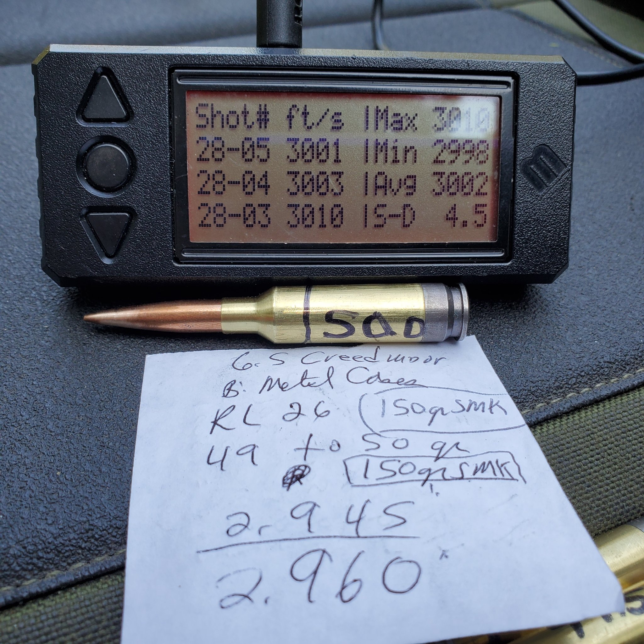

You can do the same with a 6.5 CM and hybrid cases.
