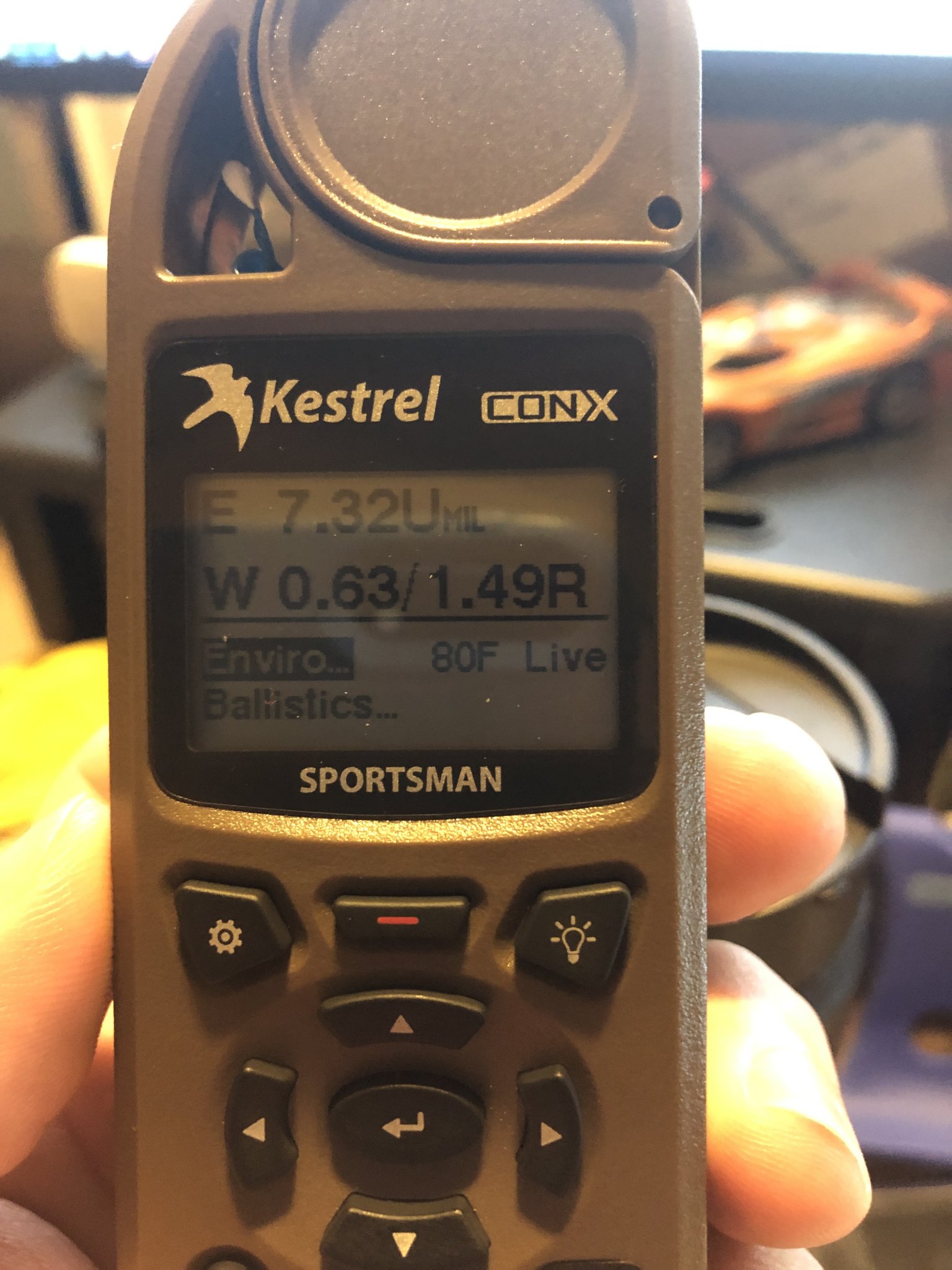

I recently picked up the 5700 sportsman from Dale at camera land and while I wait for my upgrade download to come through I was playing around with it

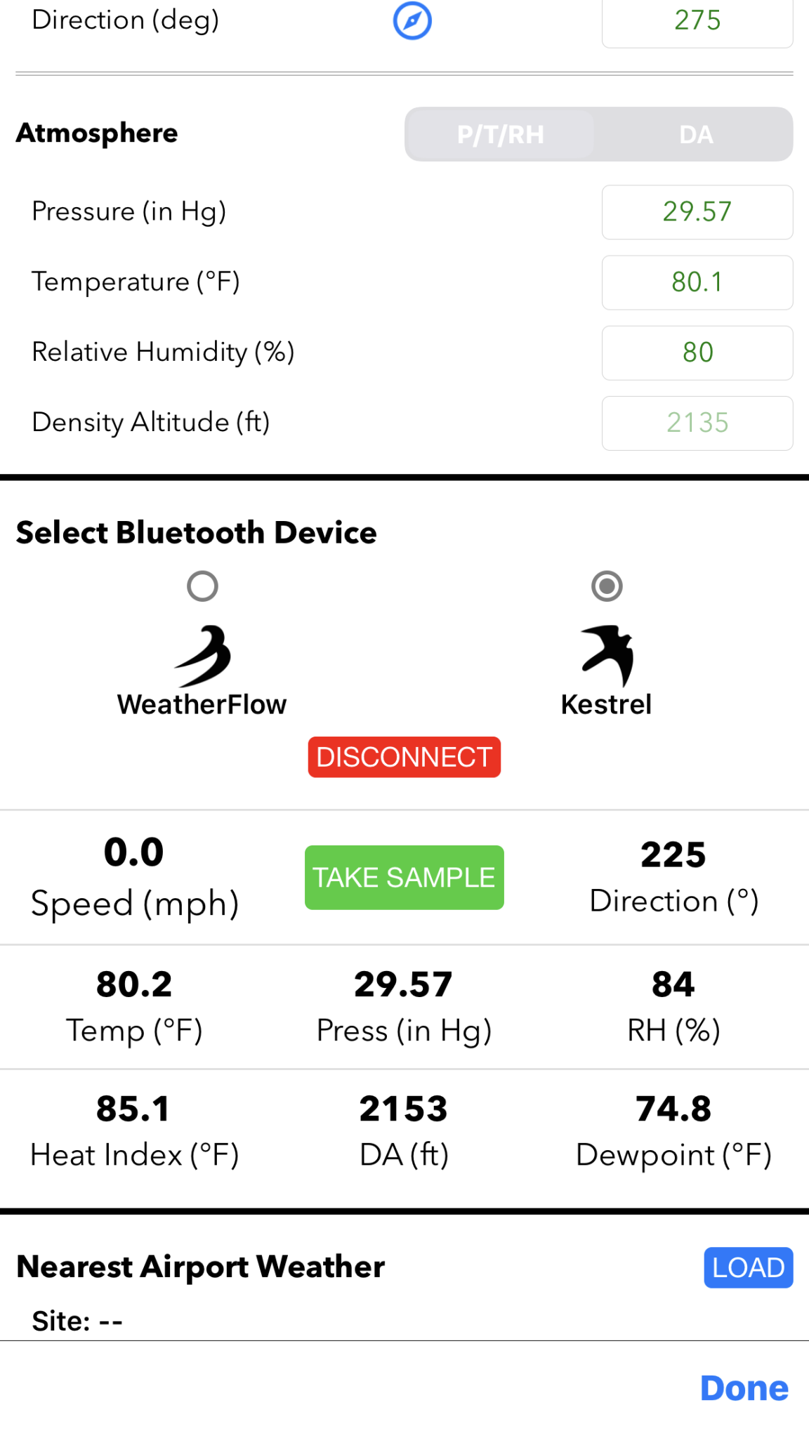

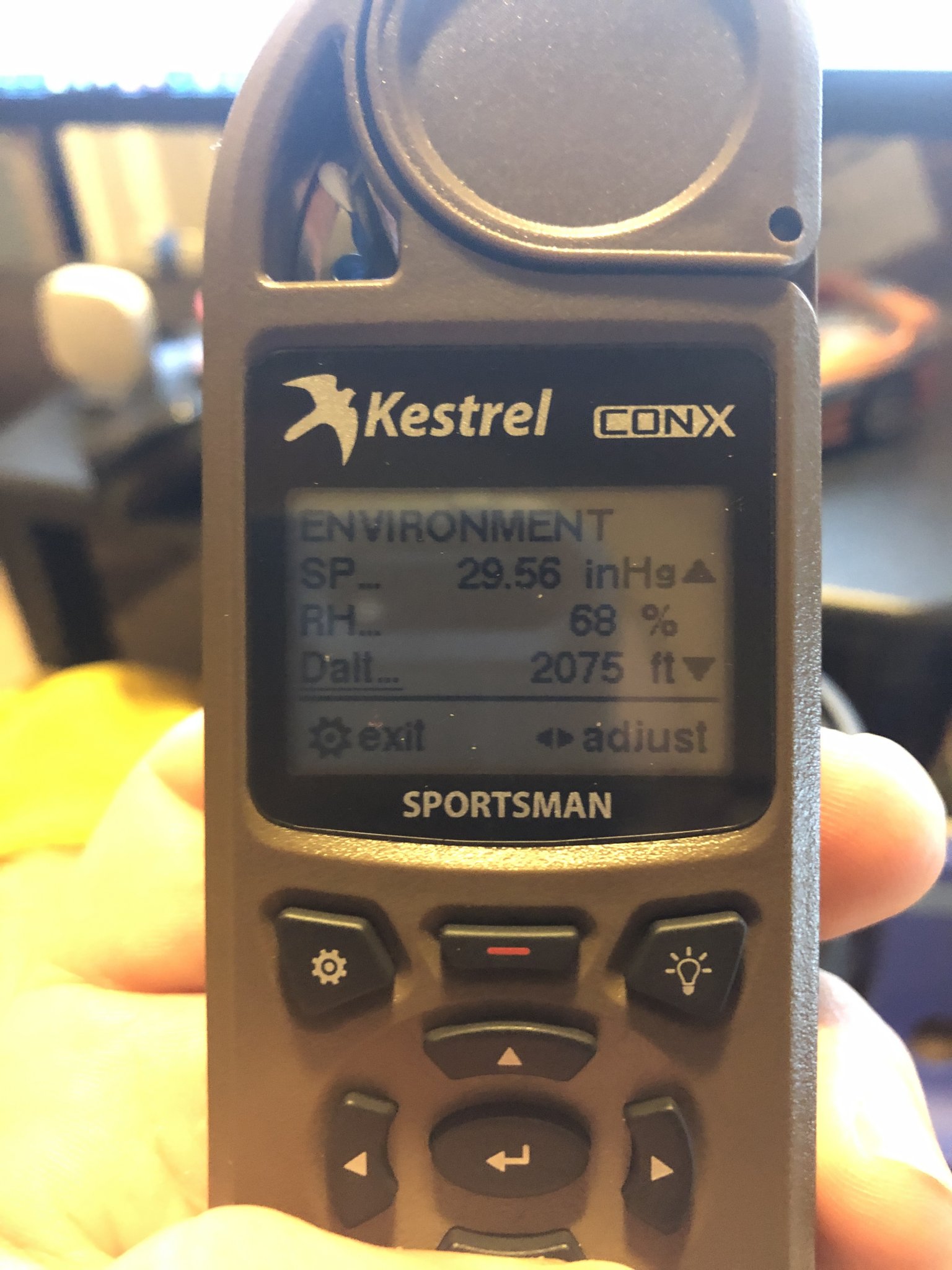

loaded up my profile for the 135gr ATip and noticed a huge difference between the kestrel andBallisticArc
was holding someone could assist on what I’m missing.
The data from ballistic is within 1/10 of my usual dope to 1000. Where as the kestrel is low about 1.5mil
So interesting thing happened. After making this post I received the email to upgrade my unit to the 5700 elite.
so I processed the upgrade which went smooth. And then loaded my load back into the kestrel. Same one I had used before with the 135atip.
and guess what the data was spot on with my previous dope. I made no changes except I upgraded the software.
well problem solved I guess. Would love to know where the prior data was coming g from.
