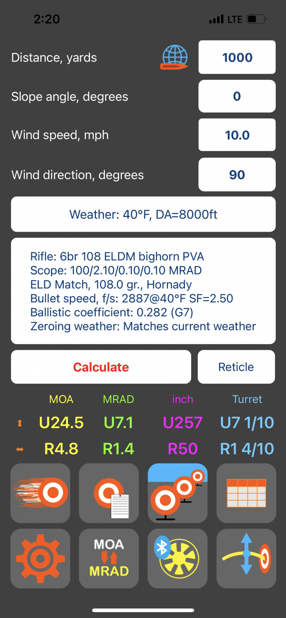

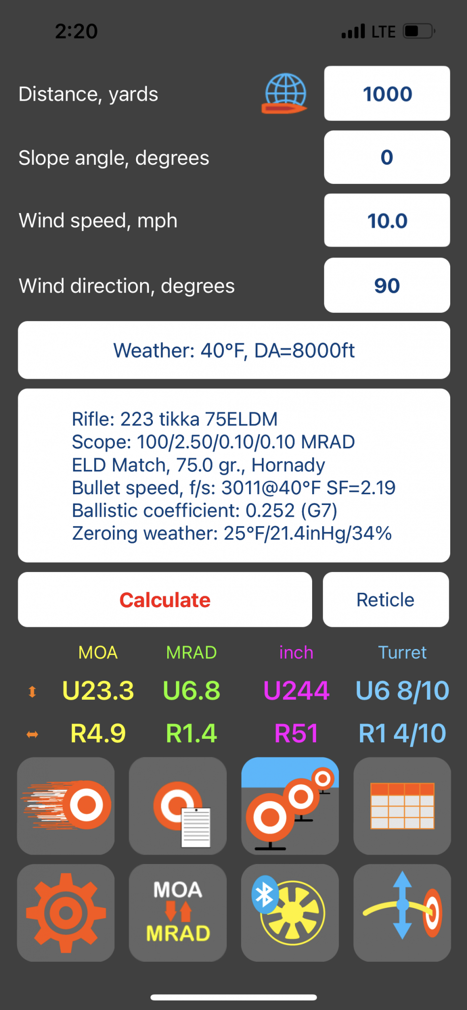

    If you run the numbers of a 75 eldm at around 3k and a 108 eldm at around 2880 it’s pretty much identical for wind and less drop with the 223.
    Below is my actual data for my 223 and my 6br
    Reactions: rookie7
    I don’t have my data off hand but it’s around 25.4 n140, 75eldm, lapua brass, cci450, oal is around 2.5 just fits in a poly mdt mag.
    The issues we are seeing as far as competition goes is not being able to spot impacts. Plates don’t move much past around 800 yards and seems to be harder to see misses in the dirt too.
    Interesting data. Have you found those box bc's to be accurate? In my experience the 75s are closer to 235-240g7 and the 108 is more 265-270 to 1k yards for matching drops to my known velocity.
    No they aren’t perfect. I had to true the data to match. I don’t remember if I played with bc or velocity, it’s been a while.
    But the above is the trued data for both my rifles.
