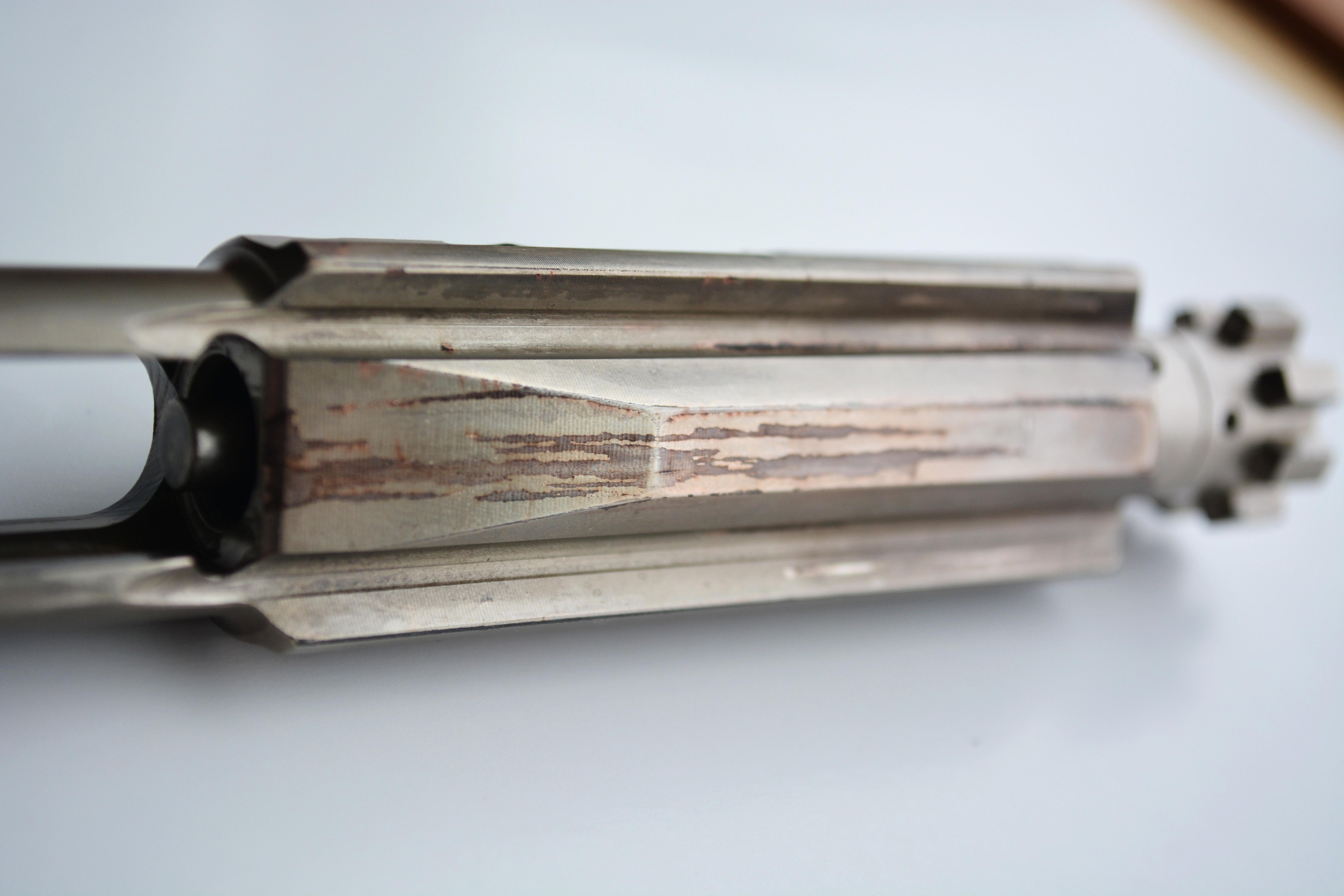

With the 762 Industries bolt, I was going to get one from the sale. Decided to do some research and that quickly told me to stay away. There are multiple threads on different sites about the issues with these bolts. Mainly poor machining and tolerances. Most have pictures to back up the discussion.
Just stay away. Anyone that goes out of business that fast its for a reason.
762 Industries, NP3 BCG were on sale at Rainier Arms ,but may be sold out
No, no, no, avoid those.
The company that makes them conveniently disappeared once people noticed how bad the machining was on their bolts. Most that bought them are stuck with these serrated bolts. They probably do make a good file though.
I polished mine but it was not easy with the NiB coating on there. If I could buy again I would go with a JP or a standard phosphate carrier with JP bolt.
Tipper... The main problem with the 762 carriers is the poor machining. I have one with the nib coating. When placed in an upper it has a zipper sound. Looking at the surfaces on the carrier that would contact the upper there are little ridge marks. If you were lucky you might have gotten one that had better machining than the others. If you want a spare I'll make you a killer deal on mine.
There is always going to be the 10% that like it, the 10% that don't like it, An then there's the 80% that read about it an don't know shit.
Which percent are you in? Here is some photographic evidence to to see first hand and satisfy your doubt. One week old and 153 rounds through the gun. bolt carrier belly.jpg
