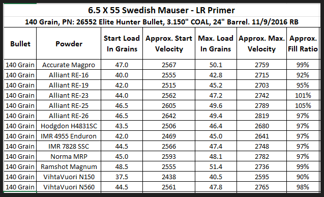

I bought some 140grains eld-m and was going to use them in my 6.5x55. i am struggling to find reloading data for it with more european powders. i allready have norma 204 and was hoping to use this. my barrel length is 67cm. please help :)
Recently got this from Berger. Should be good starting load data for the 140's:
I have an 18" carbine barrel on my Swede so I mainly use IMR 4350 for the faster burn rate.
That data was only meant as a point of reference so yes use the starting loads and work up. I don't shoot the 140's myself but I am working up loads for 108, 129, 135 and 156 grain bullets. The is also a 6.5x55 Swede reloading section pinned at the top you should check out.
