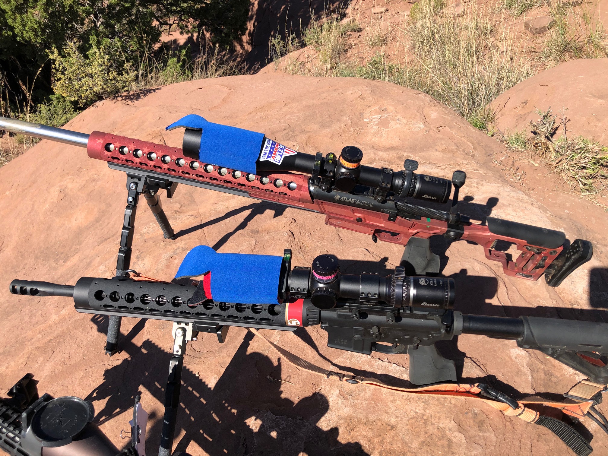

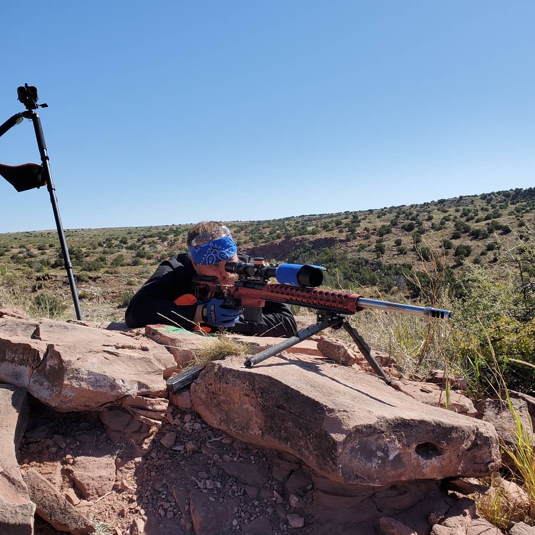

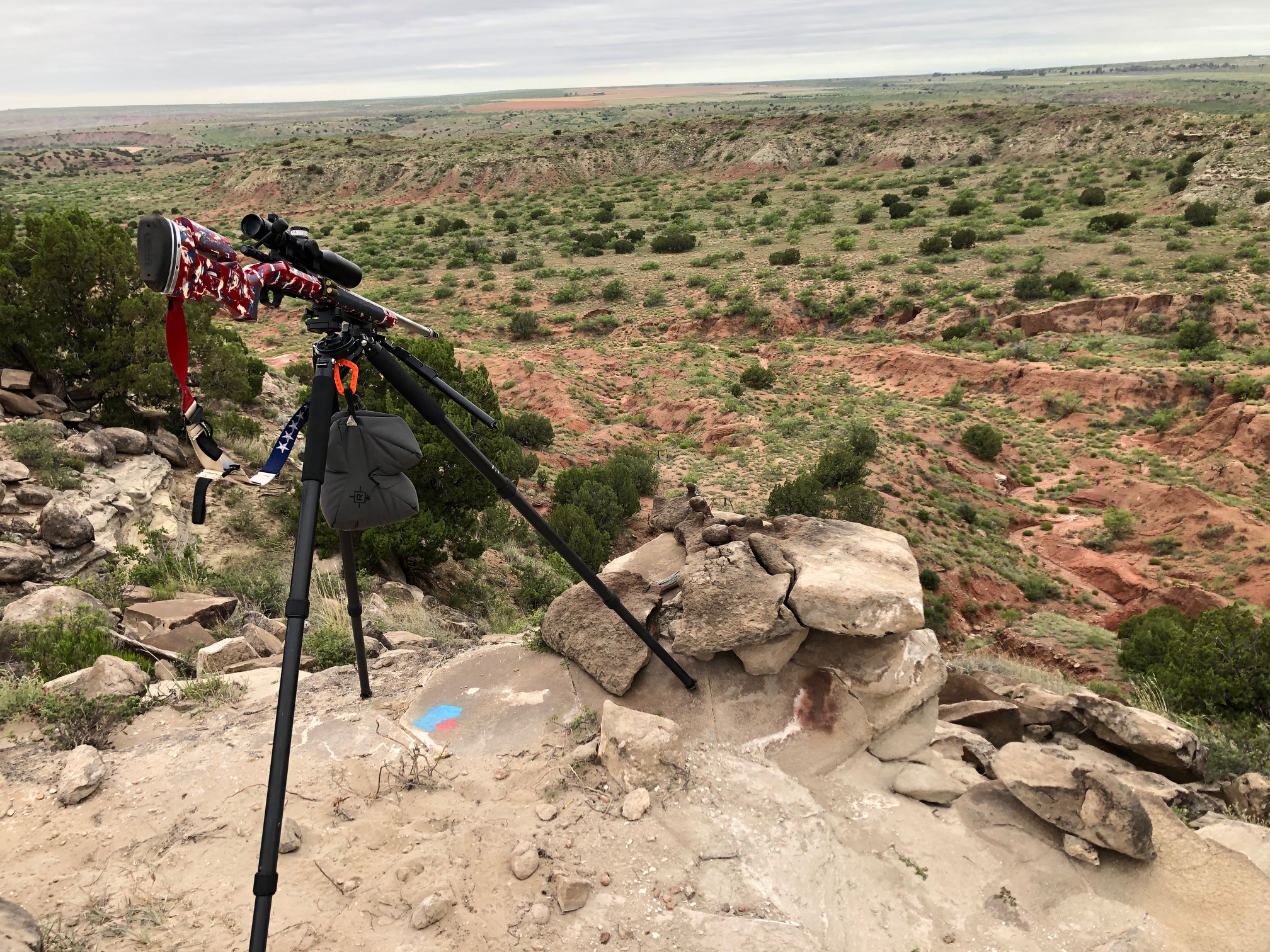

OPEN RIFLE (usually around 18 lbs)
-6BR with 26" Heavy Palma
-Kelblys Atlas
-JP Chassi or Kelblys KTS stock
I have shot 6BR last 3 years and 6x47 for 4 yrs. Don't know if I prefer one over the other. Whichever shooting better at the time good enough.
CARBINE
-JP 223
Enough said.
-69 smk factory ammo
unlimited ammo
The 224 valk would be nice as well but with other team matches we shoot req 223 only, that's what we use. And carbine gets unlimited ammo. I have personally dumped a mag on a single target before....my partner wasn't too happy lolol...
