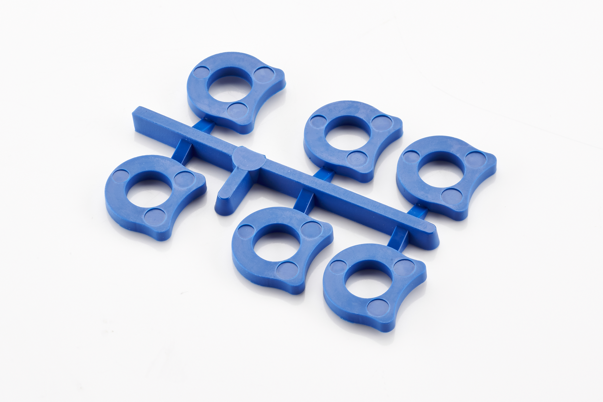

For the record. This is the shock buff I was talking about. In a Wilson gun put in by Wilson at the Wilson factory. I takes no recoil out of the gun.
From the Wilson website:
The SHOK-BUFF® prevents the slide from battering the frame during recoil by sandwiching a 1/10" thick poly fiber buffer between the slide and frame contact areas. When you are shooting high performance loads in your 1911 style pistol, you want the extra protection that the original SHOK-BUFF® provides.
