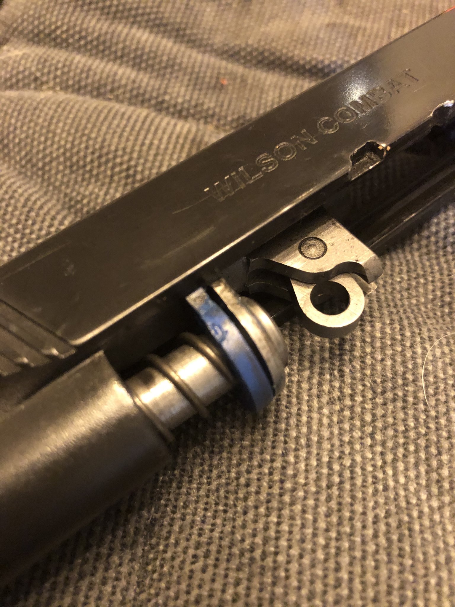

I sold a full sized Kimber to help fund A Wilson Combat CQB. It is very accurate but it is not reliable. It jams about every other magazine (stovepipe) . It is ammo finicky. Likes ball, likes Wilson ammo, forget Federal or Winchester HP. I have tried everything to include sending it back to Wilson but it still does the same shit. I wish I never had bought it.
This should be easy to figure out. Do you run a Shok Buff?

Wilson needs to make that right. If they can't get it, doubt I can help much. Limp wristing a 1911 is a disaster which I am sure you know. Changing spring weights to match the ammo helps, no one size fits all. You can run a 15-16lb with 230 gr hardball, you're tearing the gun up though. I used to change springs when alternating between 230gr and 200gr Ranier's.
I am surprised about this, that guy and his shop know WTF is going on. I just never pulled the plug on one, doubt I will, don't shoot enough today.

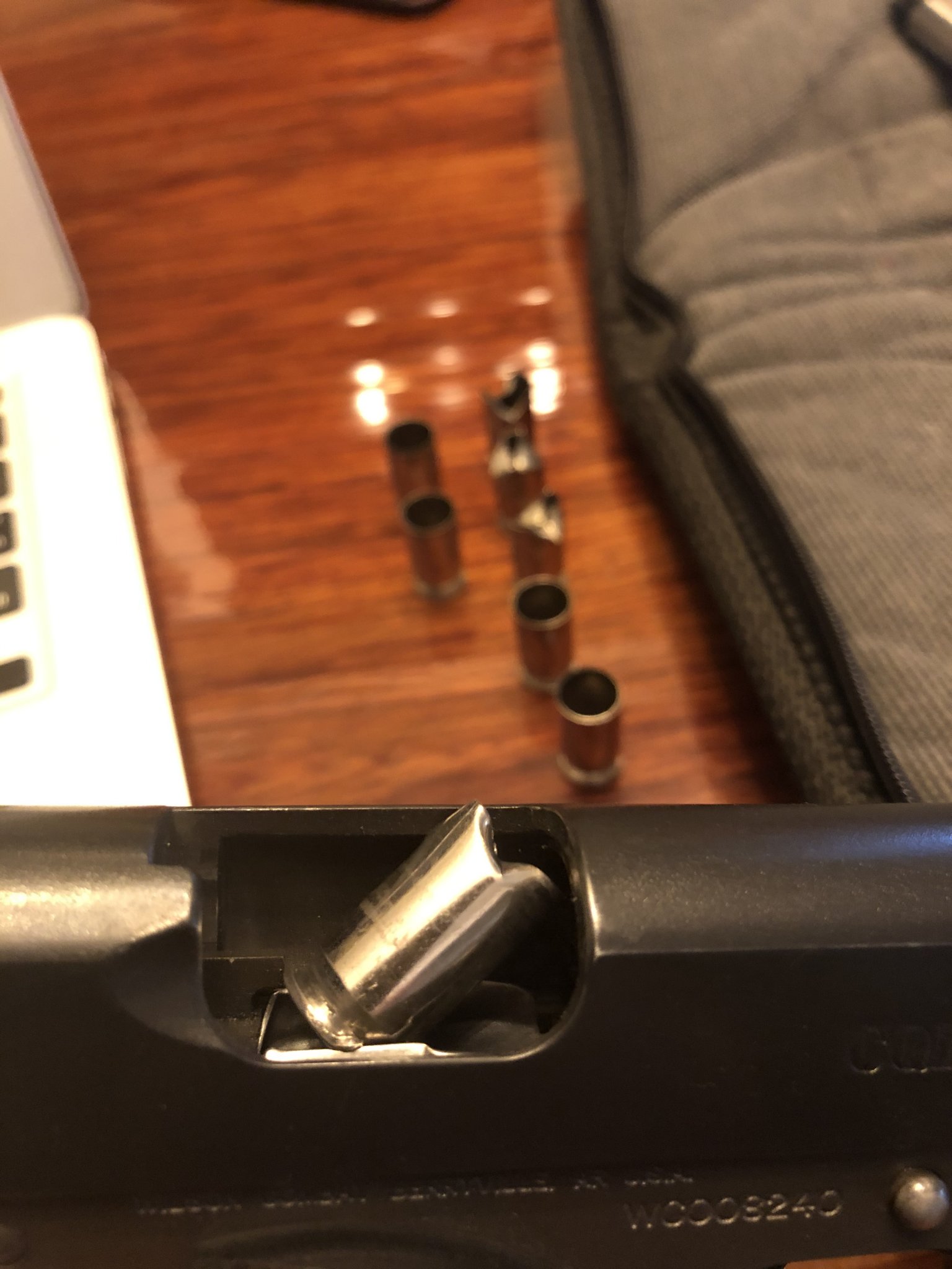

Well, I guess it’s better. I ran 4 mags through it and it did this on the last round. Also noticed the brass is really getting tore up without the blue shok buff. Ammo is factory Winchester Ranger 230 grain T series

What recoil spring and main spring weights are you running? I've seen that on guns that are severely under sprung for the ammo being run.
15lbs on the recoil spring if I remember correctly. Main spring no idea. It is whatever they put in it when I sent it to them if they even bothered.
edit: just looked at the invoice and it doesn't show they replaced the springs just tensioned and replaced the extractor.

Did the slide lock back like that or did it close on the empty case, and you locked it back manually?
Slide is locked back on its own. Brass is so jammed I can't even pull the slide back to unlock it. Can't strip the mag free. weapon is completely shut down. I have a notion to send the spent brass and weapon as it is to Wilson and say "Please unfuck this or give it a decent burial." BTW you were the last ones to work on it.
Reactions: Odysseus1911
I’d ask for a replacement at this point.
I just sent them an email. I'm going to send it back and see what happens.
Full power loads like Ranger T 230 gr. require a recoil spring no lighter than 16 lbs., but 17 is better. A brand new 15 lb. recoil spring wouldn't likely be enough for that ammo, and if you've got a 15 lb. spring that has several thousand rounds through it and they didn't replace it, your actual spring resistance could be more like 12 lbs. and could easily cause the malfunction you had. Very possible that nothing is wrong with the gun but a worn-out, under-powered spring.
Nonetheless, sending it to Wilson should get you fixed up. Sorry about your troubles.
