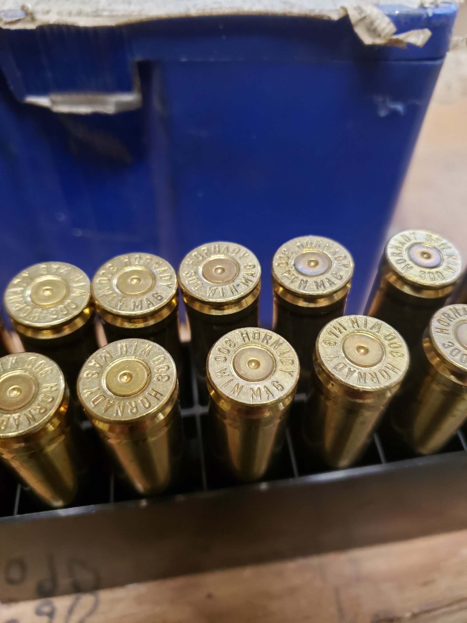

What's going on here?
Took my brand new 300WM out to just get some round through it.
Factory Hornady whitetail hunter 150gr . Primers are really flat but no ejector swipes. Also shot 6 handloads, (3)@73grs 7828ssc under 200gr Berger hybrid target, 215 federal magnum primers. Also (3)@ 73.5.
They ALL looked like this.
Any suggestions?

All of the above.........no , don't disregard flat primers......BUT some rifles flatten primers regardless of load, I have one of them . Use magneto speed with ,published load data as a ( somewhat ) guide.......hard bolt lift and ejector marks are a sure sign of high pressure, back off powder if these acure

In the first post, the primers are sorta flat but there isn't a single mark on the base of any of those rounds. After a flat primer, usually next is primer cratered. Then some marks on the base where the ejector will mark it up and along with this I have noticed increased effort to lift the bolt. Back off a little if you are marking up the base or cratering the primer. Flat primer is near the max, no doubt.

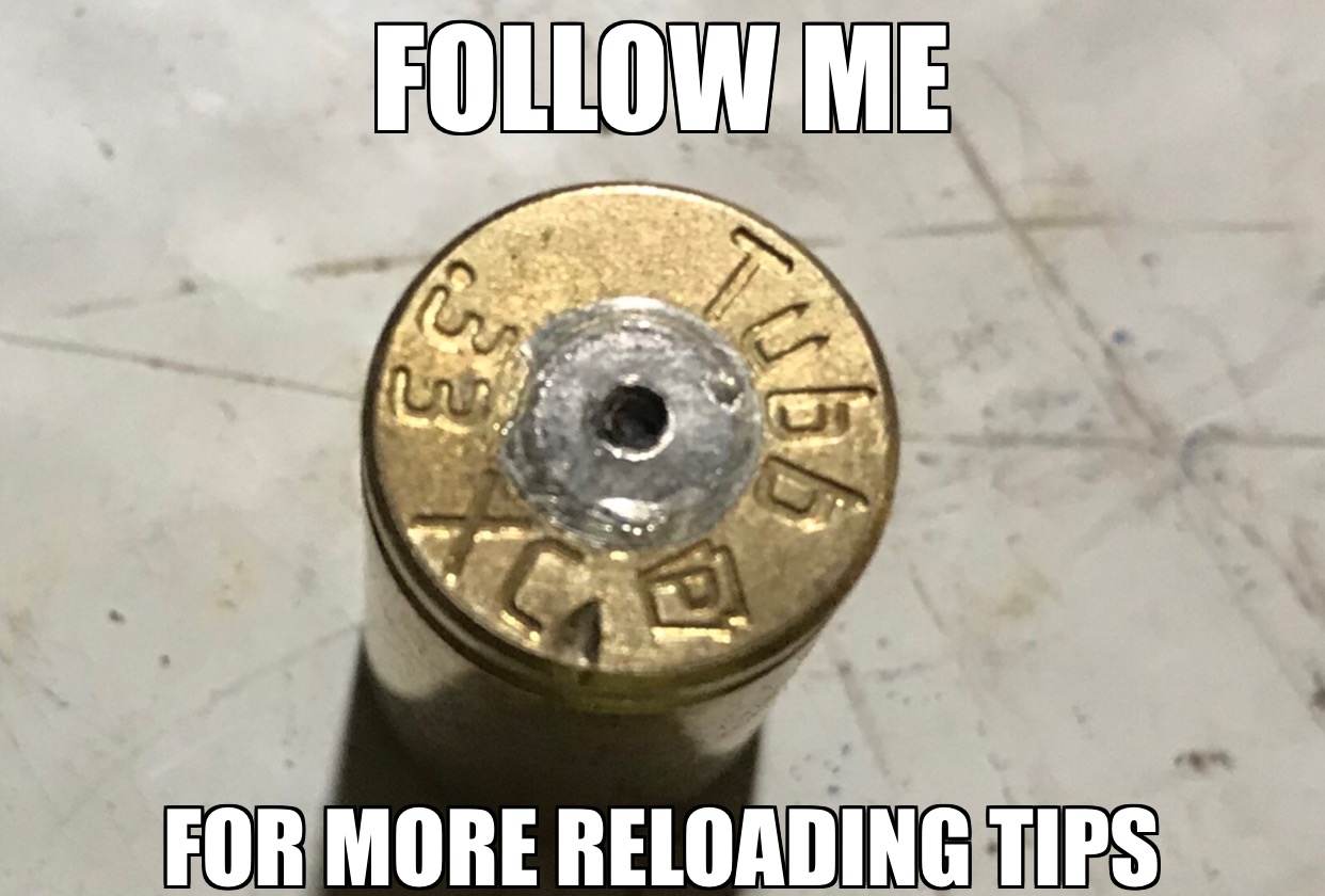

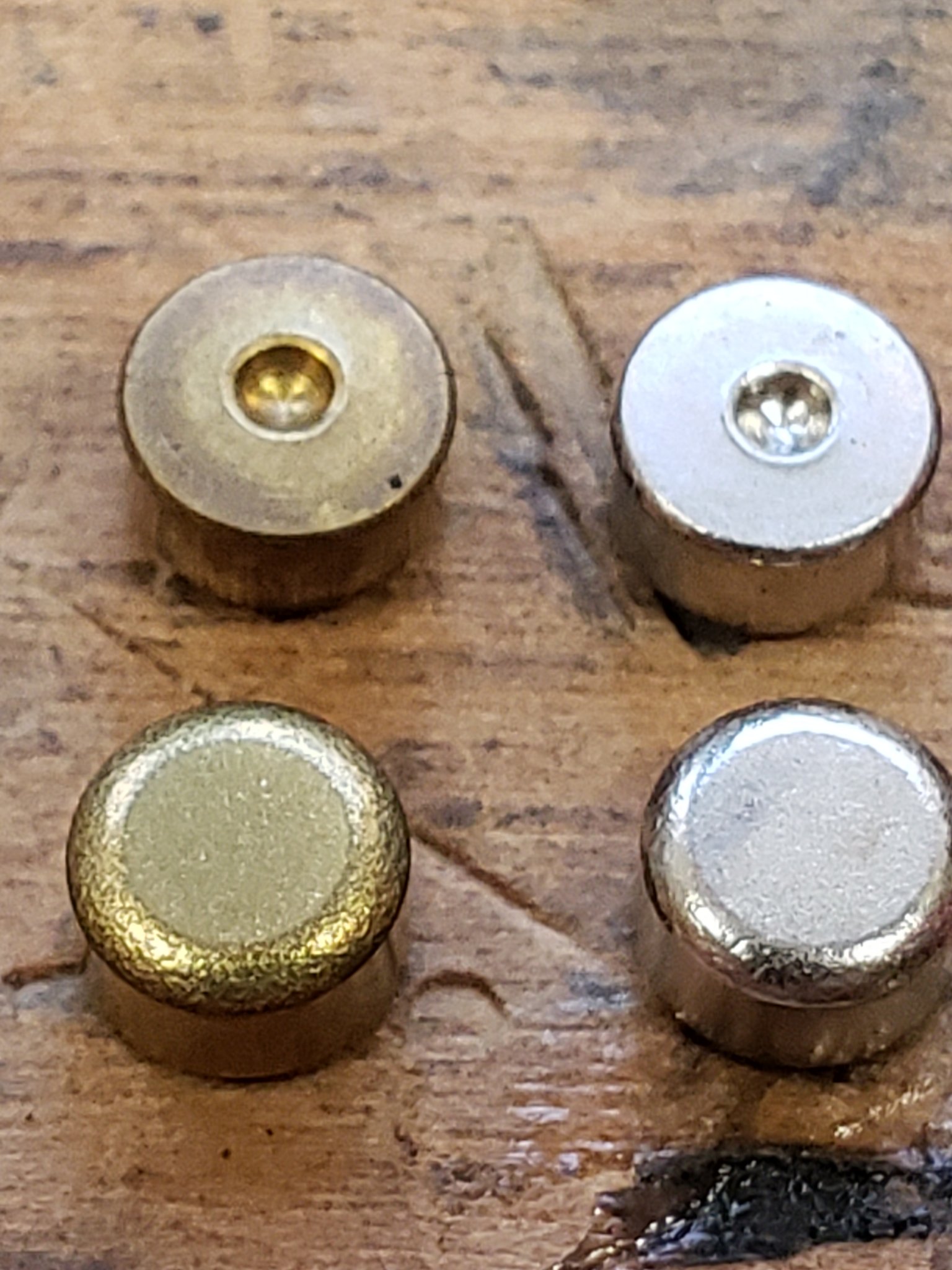

Primer crater, Pierced primer, primer blow-by (black ring around the primer), ejector swipes, stiff primary extraction (bolt lift), loose primer pockets, and swelling in the extractor groove are pretty solid indicators to look for.
Primers that have no visible corner that smoosh flat on the head are also no bueno. Yours definitely have a lot of the radius taken out, but I'd bet they pressure test fine.

Good pics of primers
Reading primers is helpful but they will lie to you.
Combined with brass and extraction you can get a pretty good picture.

Like I said, I wouldn't sweat it. It looks like you're "there" but not over the line IMO. I have had 6.5 Creedmoors that have primers that look just like that well within published load data and the velocities matched up with the book, which is usually a pretty good indication that pressure is in line with reality. No worries.
Maybe softer primer cups, maybe a little bit of head space etc... The corner radius is a good thing to watch, but isn't the end-all-be-all for excessive pressure. Craters are kind of the same way. M700's are almost guaranteed to have them unless the bolt is bushed. Other guns don't have them until you get hot. Just depends.
