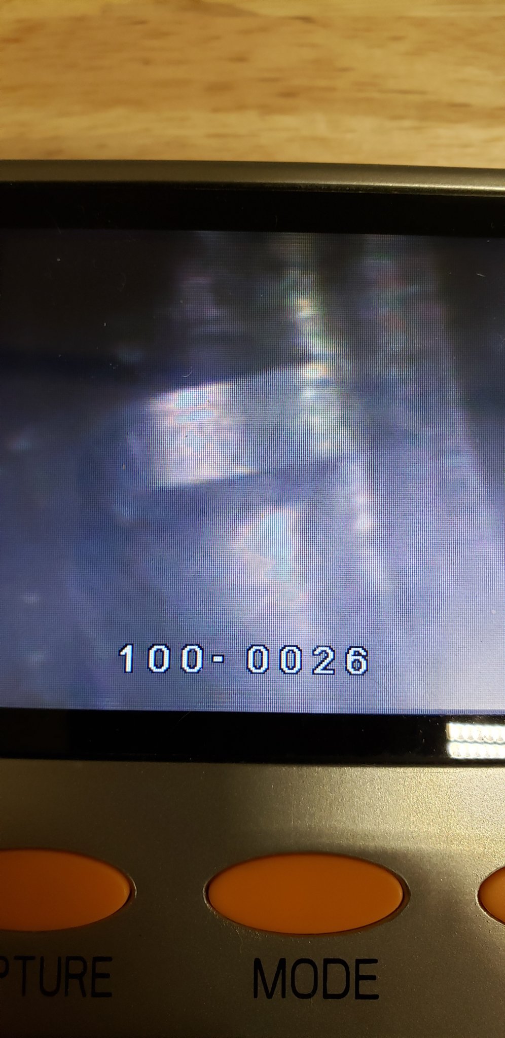

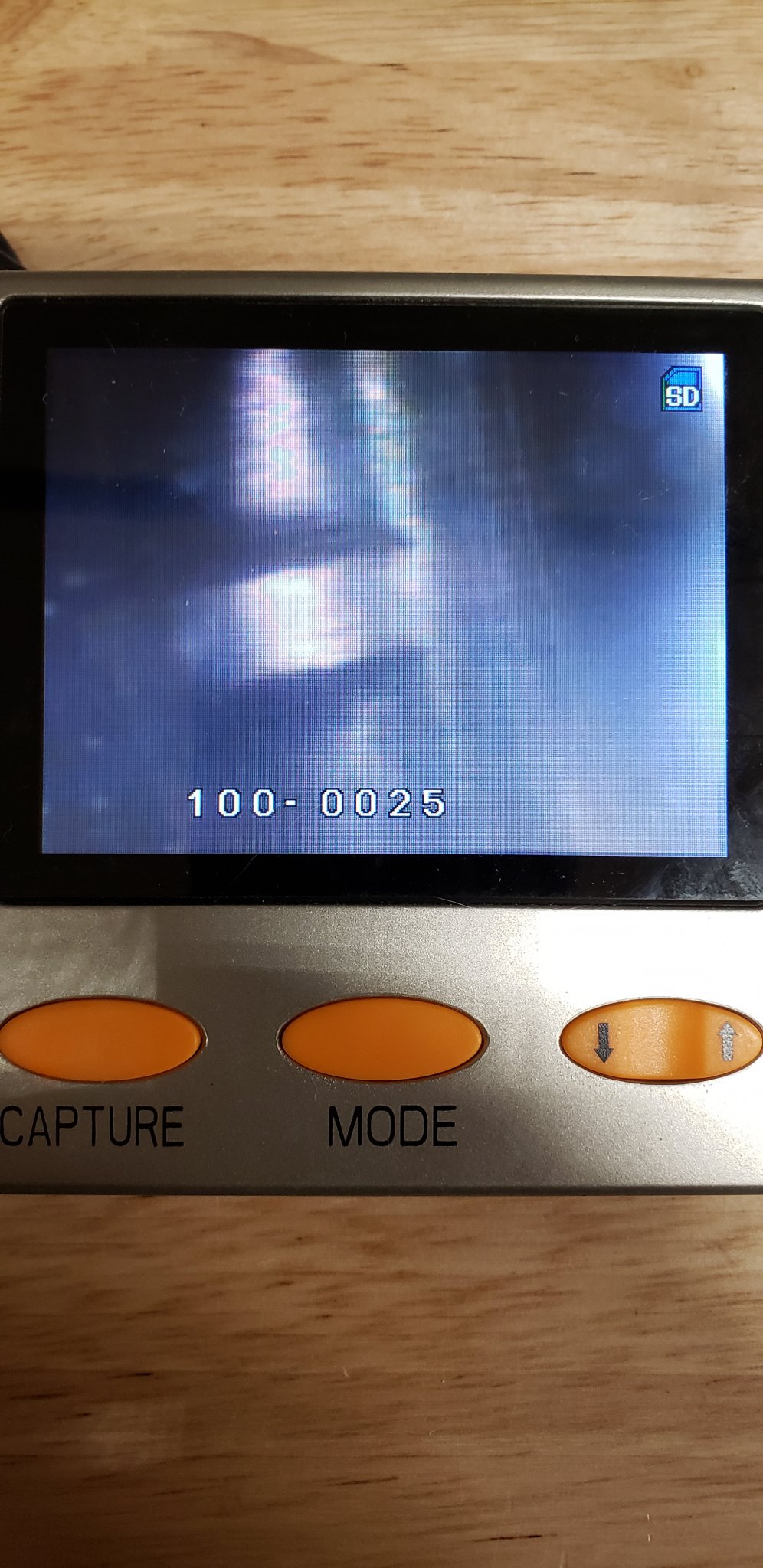

@Bio I did look at the leads in the barrel with a borescope and they seemed to be pretty abrupt. I'll make a modified case from a fired case from my chamber and try different bullet profiles and see if I can tell anything. Probably not but I'll see.
I'll check again with the borescope and take some pics.
Might just send it back to the manufacturer and let them figure it out?
Thanks
Well here are two images taken with the borescope. Kinda hard to figure out (lack of depth and perception) but looks as though the leads are more of a bullnose shape than normal leads with a rake at a certain angle of degrees?

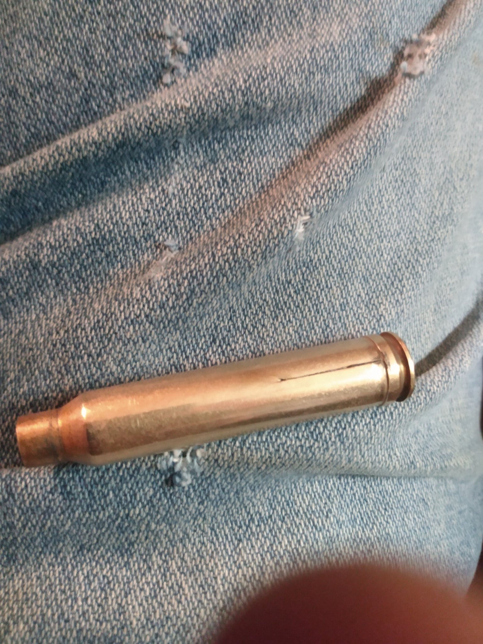

This was a brand new Hornady 300WM case with 66.4 gr of Alliant PP 4000 MR and a 225 ELDM. Max listed charge was 67.6 so I was well under max. I didn't know it had ruptured until I went to turn the bolt and it was a bit sticky... I examined the other 4 cases with that charge and they were fine. Likely just a bad one... But it spooked me a bit.
I measured capacity in grains of H2O and Hornady held more water... So in my mind I assume their brass is a tad thinner at the web than the Federal and Winchester I compared it to.
Makes me a bit hesitant to use it anymore.

That kind of failure can happen with any brand. Don’t be a brassophobe. For the most part American big4 brands produce good brass. If you want the very best you have to go with premium brands. I have never had this kind of failure but I shoot mostly range pickup which is factory loaded 1x fired brass. I think the QC is better on those than the ones sold as reloading components. Ultimately it is on you to look the case over before you load it.
