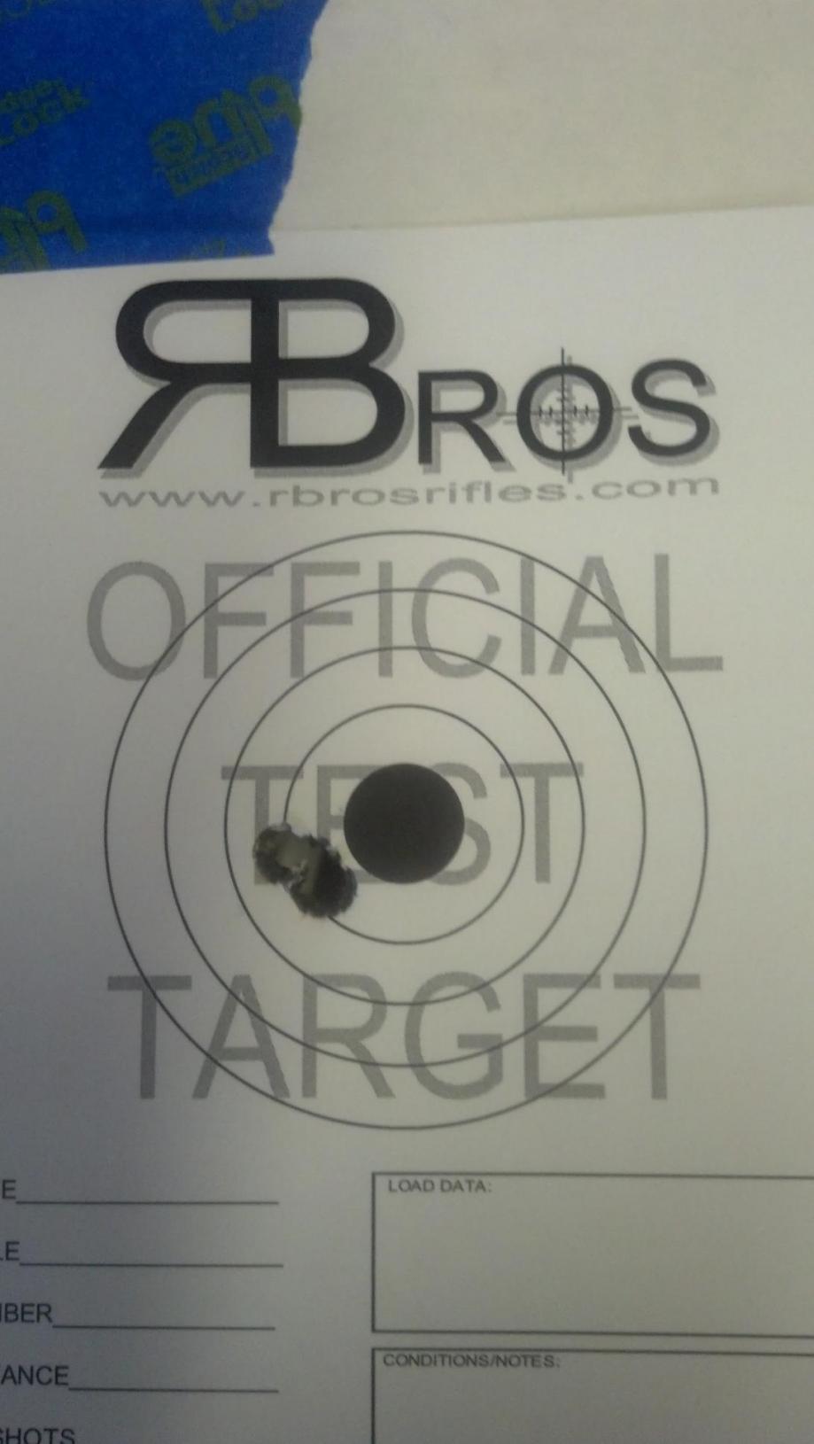

I use 71 grains of Retumbo, which shoots under 1/2" MOA with the 180 VLD's 3056 FPS It's an RBros 7mag with a 27" Sendero contour, Broughton barrel.
