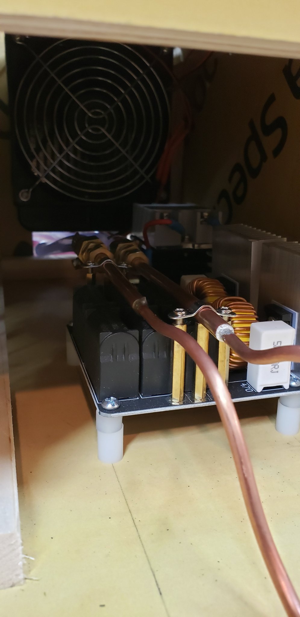

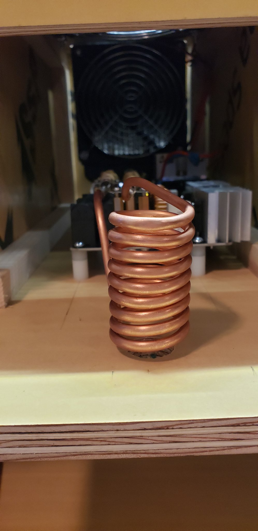

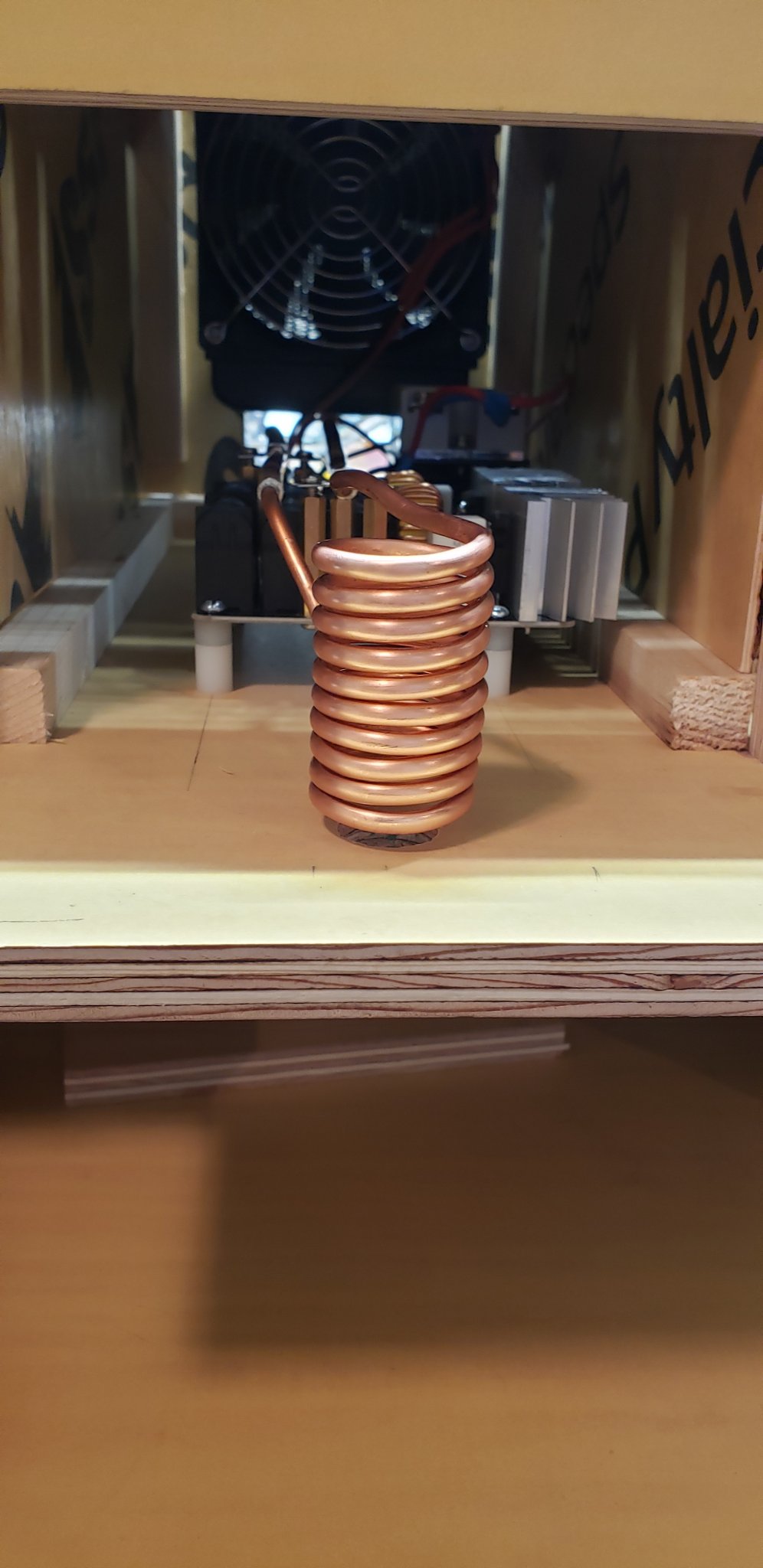

What coil are you using? Sounds like its the coil not the power supply. Also my understanding is it should only need to run no more than 8 seconds or so and thats depending how you have it set up. Mine has a slight delay when my cycle starts so my max time is 7.8 seconds. Technically its probably more like 5 or 6 seconds. At the end of my cycle its pulling 550 watts +/- and 14 amps +/-, and that is very brief. I just have a 36v 16.7 amp power supply. How many watts and amps are you pulling? I am no expert by any means. But if you are using the coil that it came with, its way big. Try 1/8" id tubing and wrap it around a socket thats about 7/8" diameter. Try 9 or 10 wraps, and make sure you have a small gap between each wrap. You might have to try several variations to get it right. I attached a picture of my coils I made. I actually ended up with the one with 9 wraps. I just soldered my 1/8 " tubing inside 1/4" tubing where it attached to the zvs board. Plus mine is water cooled and 1/4" fittings are easier to find. Like I said it was totally out of my wheelhouse but I figured it out for the most part with help from my brother and this thread. Hope this helps.
The ZVS works with a 24v battery source. I have also wound a number of coil designs and they work with the battery. None of them work with either PS that i have tried.
Edit.. maybe not. Testing a new coil and blew the ZVS while under 24V battery load. Back to square one.
Interesting! Maybe its in your wiring configuration? When you wire it up to the power source. Have you tested the power source without the zvs board hooked up? Is the voltage correct? Are you hooked up to an ammeter? Not an expert just trying to help. I had to put in a ssr I kept cooking trigger modules. I had a few hiccups myself.

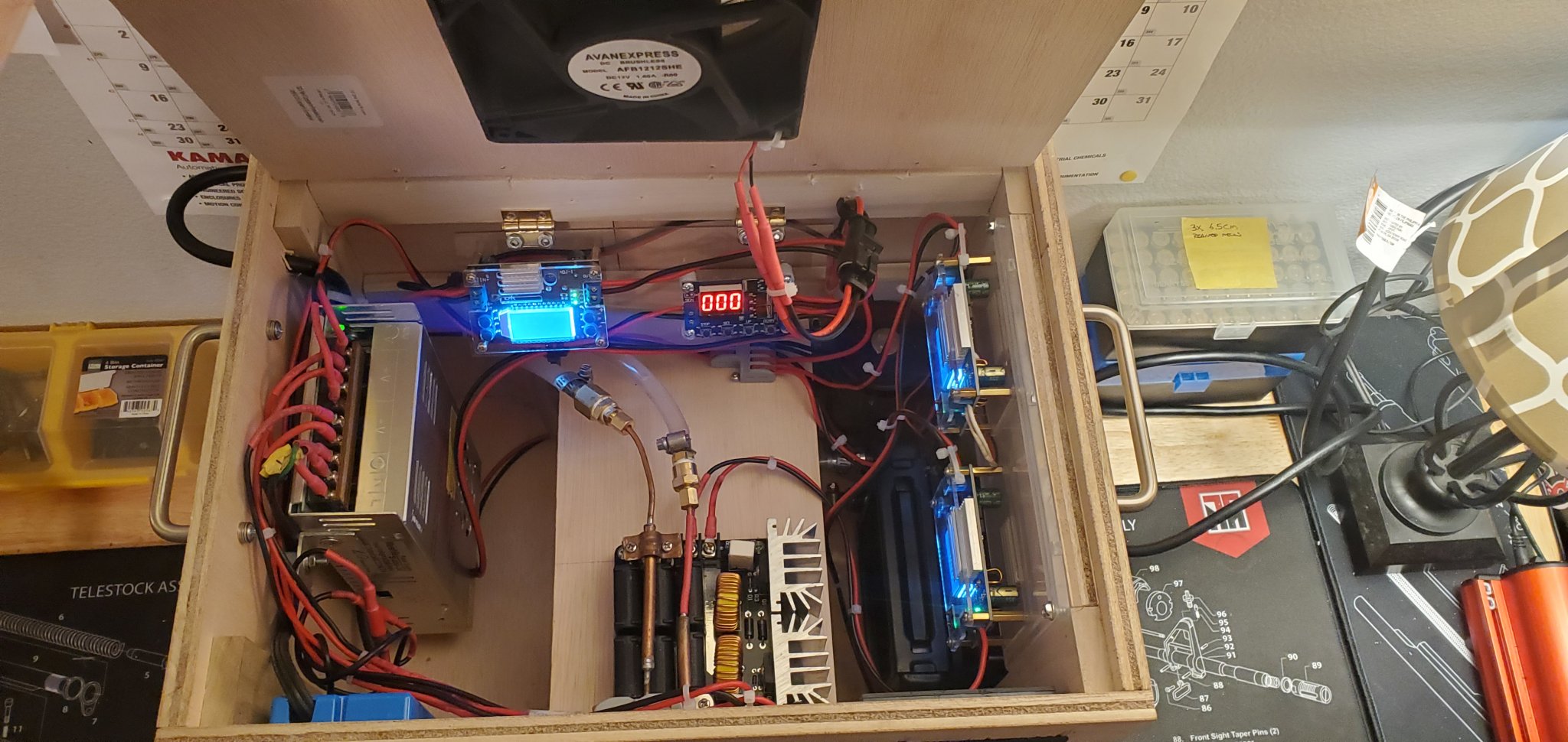

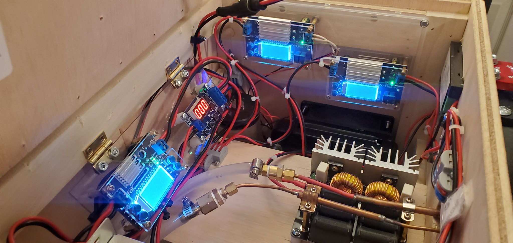

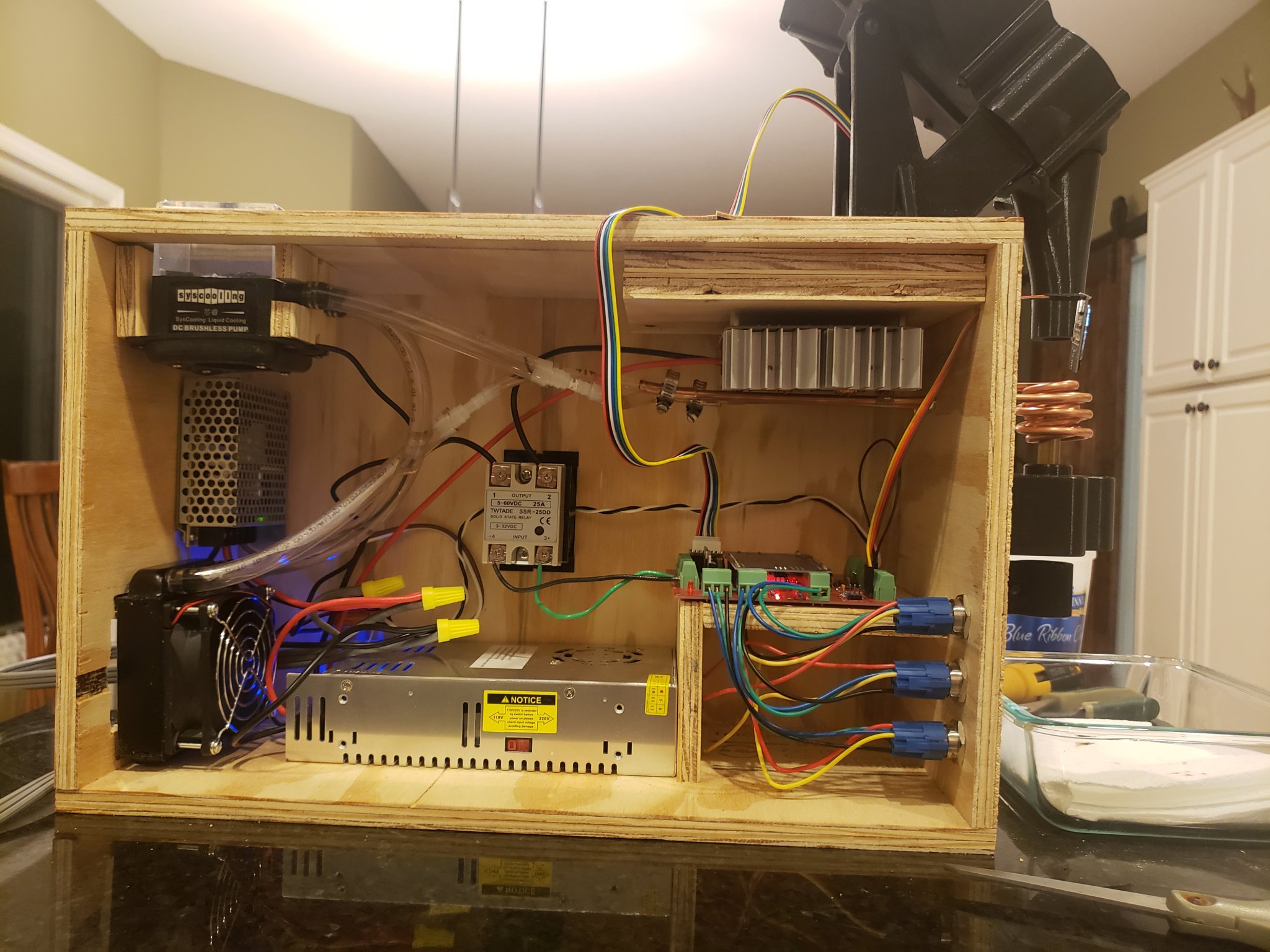

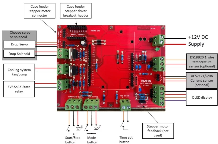

Decided to redo my induction annealing unit. I added an automatic case drop. Overall the annealer works great and has been in service since last summer.
I added another stepper and timer to run the solenoid. I have it set to run after a 6 second delay and it only runs for 0.2 seconds. All in all I am happy with the project. I posted a short video showing the case drop in action it's in the link below. If the link doesn't work I apologize. It's my first attempt posting a video on YouTube.

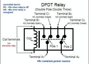

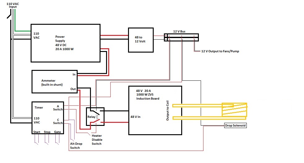

Okay, here is a simplified schematic of the electrical part of my build:
First, you have to think of a relay as having 2 modes (upper right corner). The first mode is when it is unpowered, and the input signal/current is going into the common (center) contact. That contact is NOT connected to the NO (normally open) contact, but IS connected to the NC (normally closed) contact. When the relay is activated, The NO contact connects with the Common contact and the NC contact disconnects.
The normal use for the relay is to connect the Common input to the NO output when the relay activates. An alternate use is to use the NC output and the Common input to switch something OFF when the relay is activated and the normally closed contact opens.
The big relay used to switch the ZVS board on and off, in my build/schematic, has 2 internal relays running in parallel to connect/disconnect both the 48V+ and 48V- wires.
A normal relay usually has 5 contacts, V+, V-, NO, Comm, NC...where V+ and V- control the internal switch and the internal switch controls whether the Common contact is connected to NO or NC. The big relay I use has an additional set of NO, Comm, and NC contacts for a second internal switch that runs in parallel to other...both are either ON or OFF.
Power Sources:
- The 48V DC power supply and the Sestos timer both run on 110V AC
- The big relay is controlled by 12V DC from whatever source you have (separate power supply, buck converter, whatever) and is used to switch on and off the 48V DC from the power supply to the ZVS board
- The ZVS board is the only use of the 48V DC output from the power supply (generally)
Going back to the earlier discussion of the the Sestos timer, it has 4 timers that run consecutively, one after another. Timers A and C each have an internal relay that is activated while that timer is running. The A timer/relay is generally used to switch on the ZVS board for the length of time timer A is running. The C timer/relay is used to activate the drop solenoid while it is running...generally for a very short duration of about 1/2 second. Both of those instances use the NO contact to turn on the component they control, when activated.
So, to make a long story longer, here is a step-by-step progression of the normal timer cycle:
- press Start button for the timer to begin
- timer A runs, its relay closes, which closes the big relay and the 48V supply is connected to the ZVS board
- timer A ends, its relay opens, which opens the big relay and the ZVS board is powered down
- timer B runs, generally set to 0 seconds because nothing needs waiting for at this point
- timer C runs, briefly, and its relay activates the solenoid which drops the newly annealed case, then ends
- timer D runs, for however long you need before the cycle can be started again (load another case, let the ZVS/coil cool, whatever your needs are)
At this point the cycle will end or re-start, depending on the mode the timer is in (once then stop, or repeating).
I just went back and re-read this post...it meanders and repeats itself...and I'm too tired to go back and edit it again...sorry.
Edit: Okay, just went back and looked at the schematic again, and realized I didn't address the timer Start, Stop, and Gate switches (this confused me back when I first started). Firstly, there is no voltage associated with these switches, just momentary connections between the 0V (common) contact and the contacts for each command. What I mean is you just connect the 0V contact to one pole of a momentary switch and the Start contact to the other pole, and when you press the switch it connects the two and the timer receives the Start command.

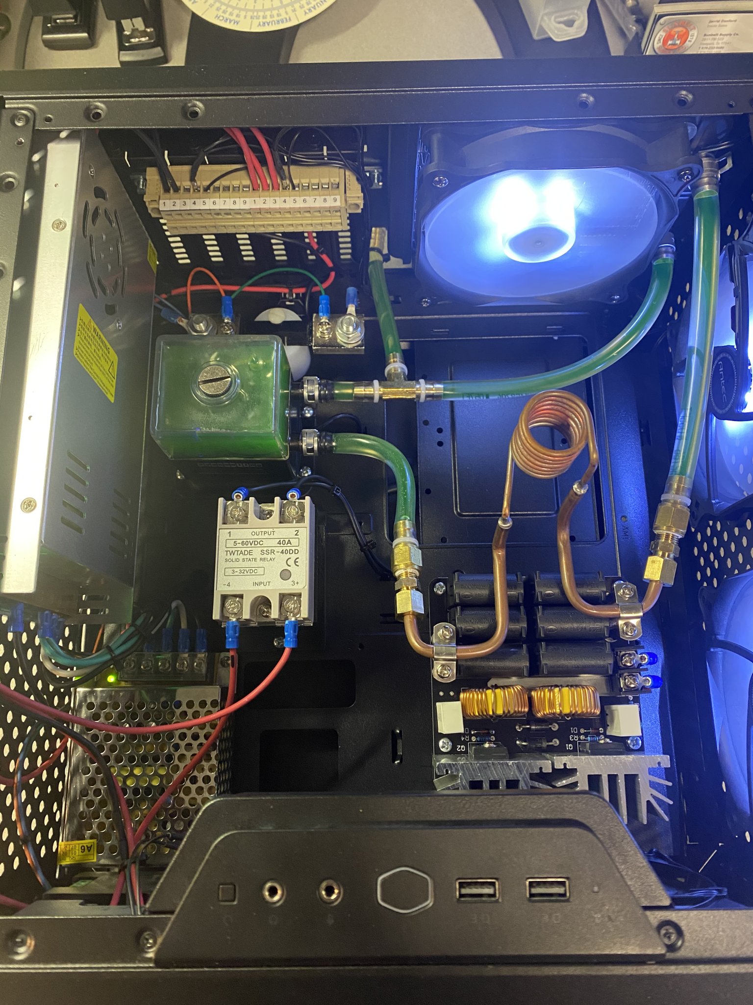

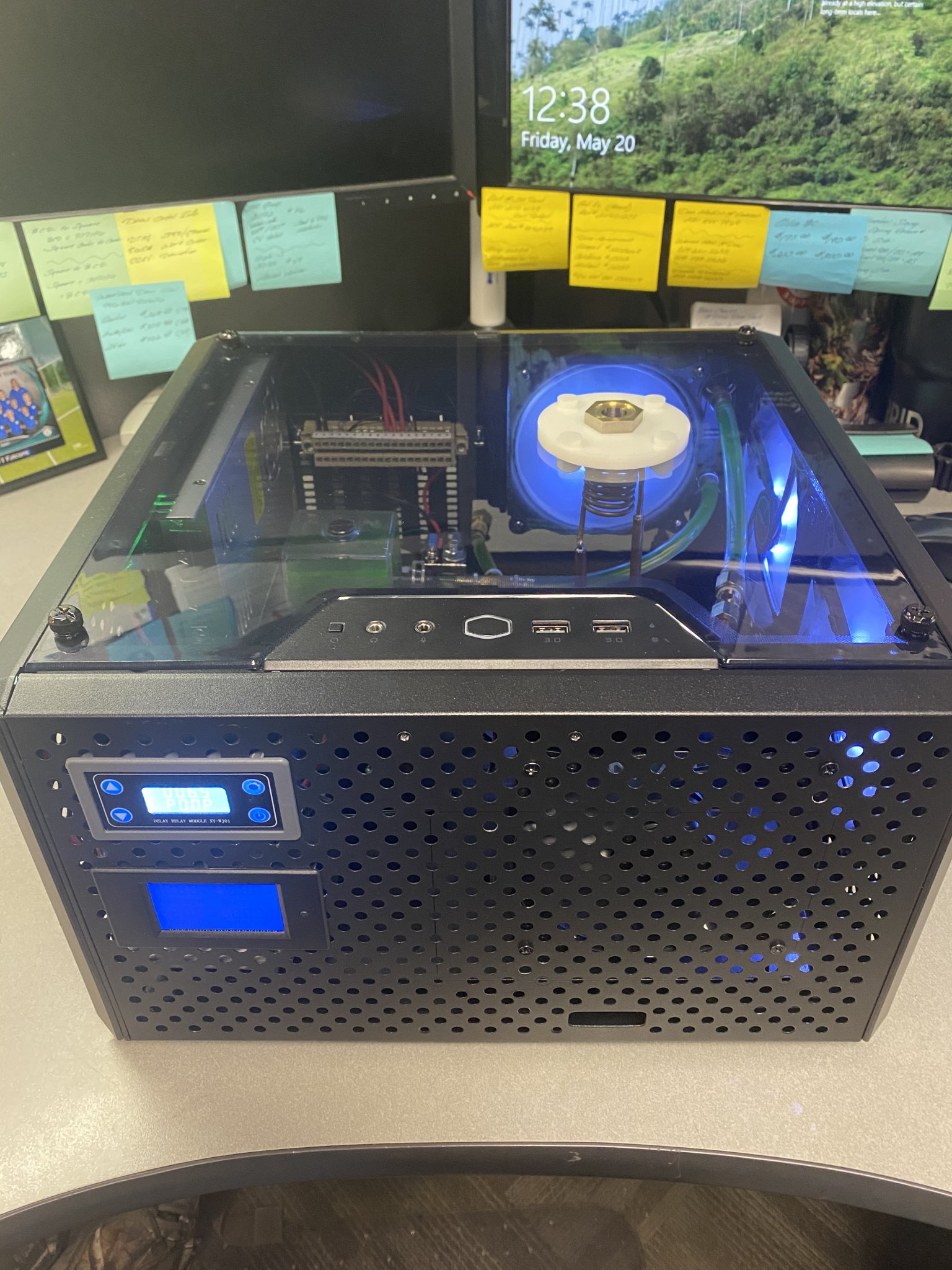

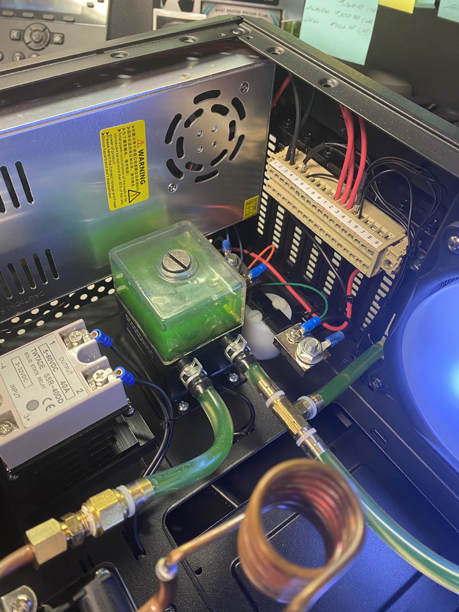

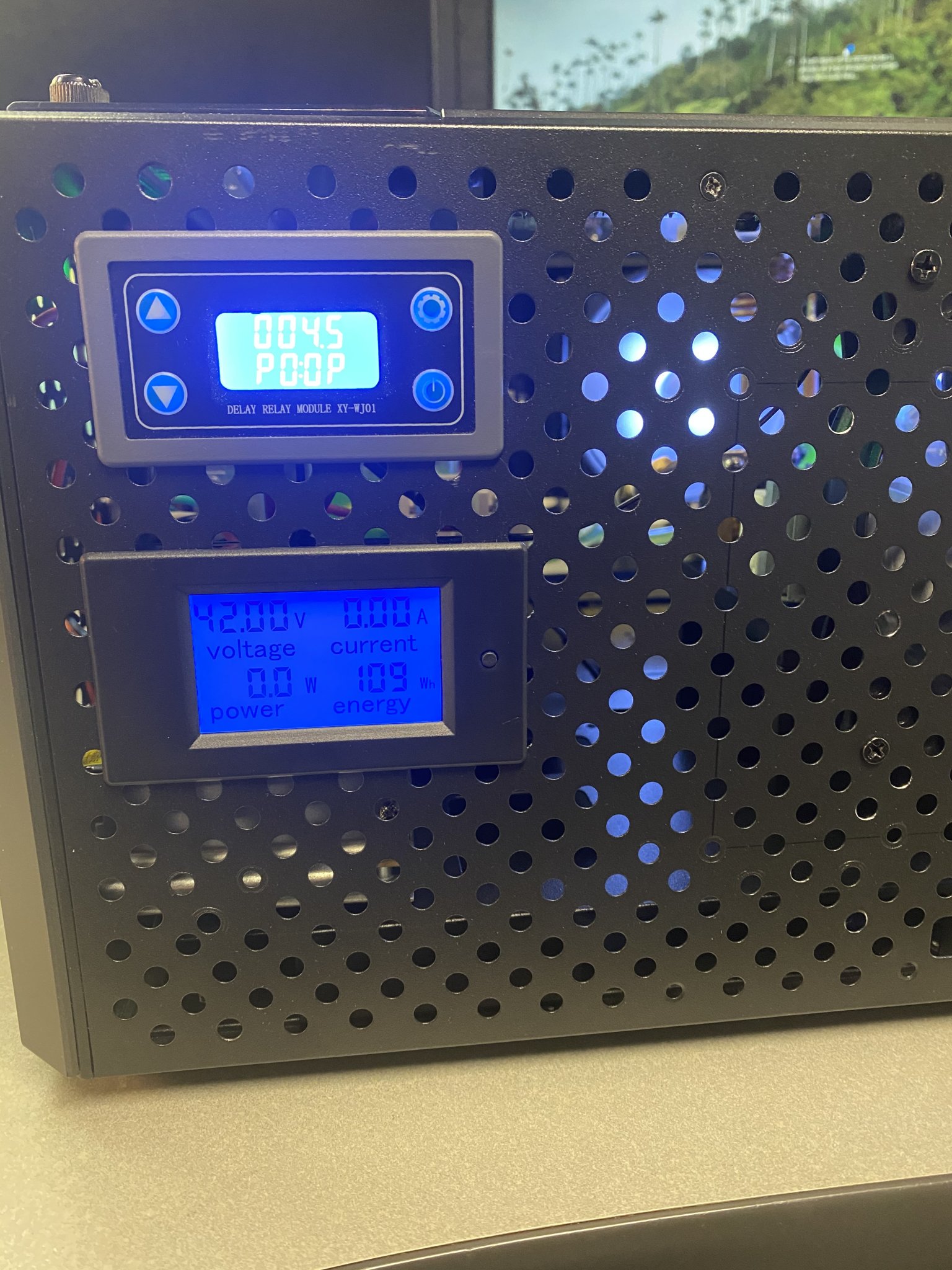

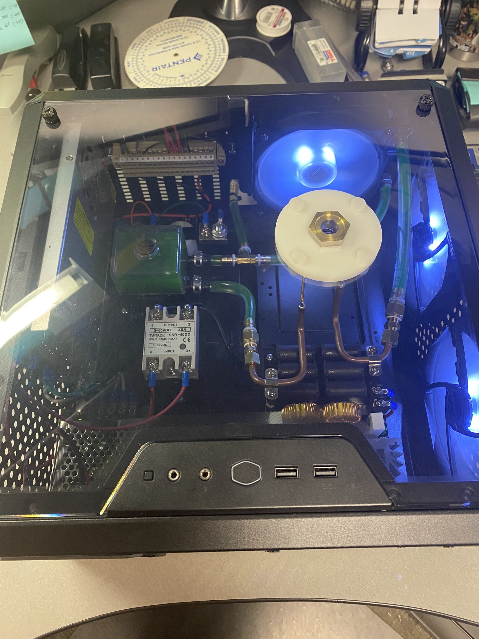

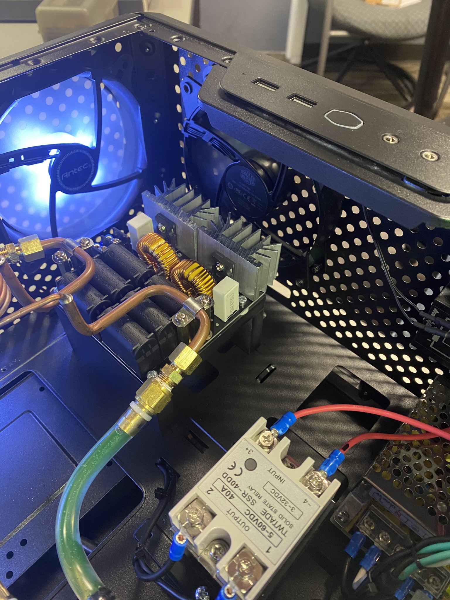

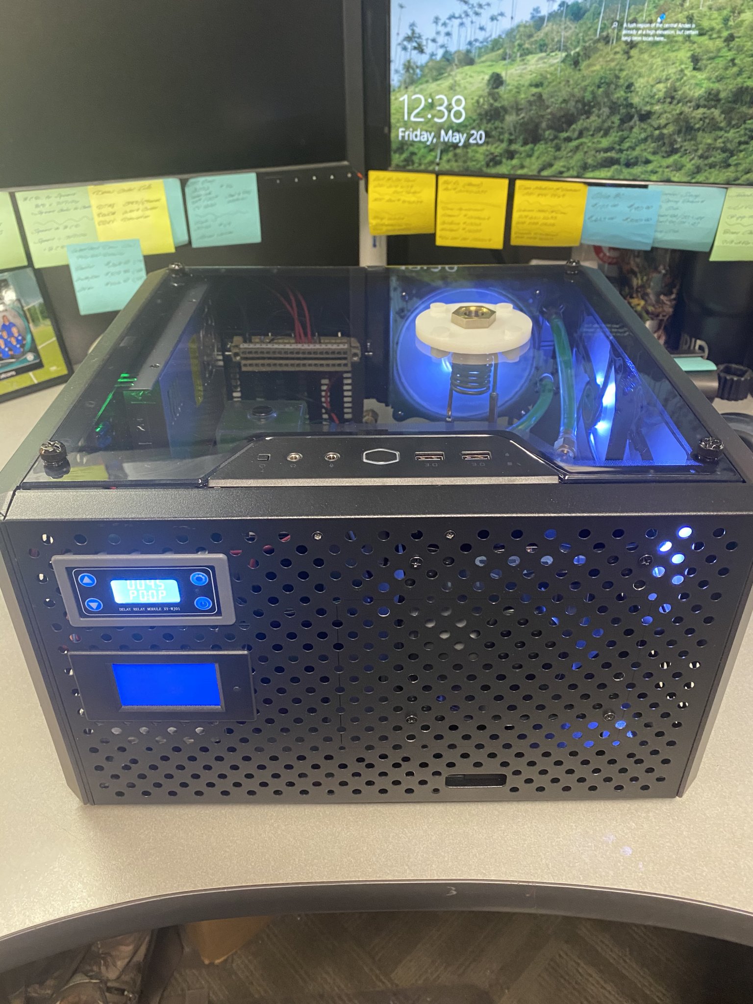

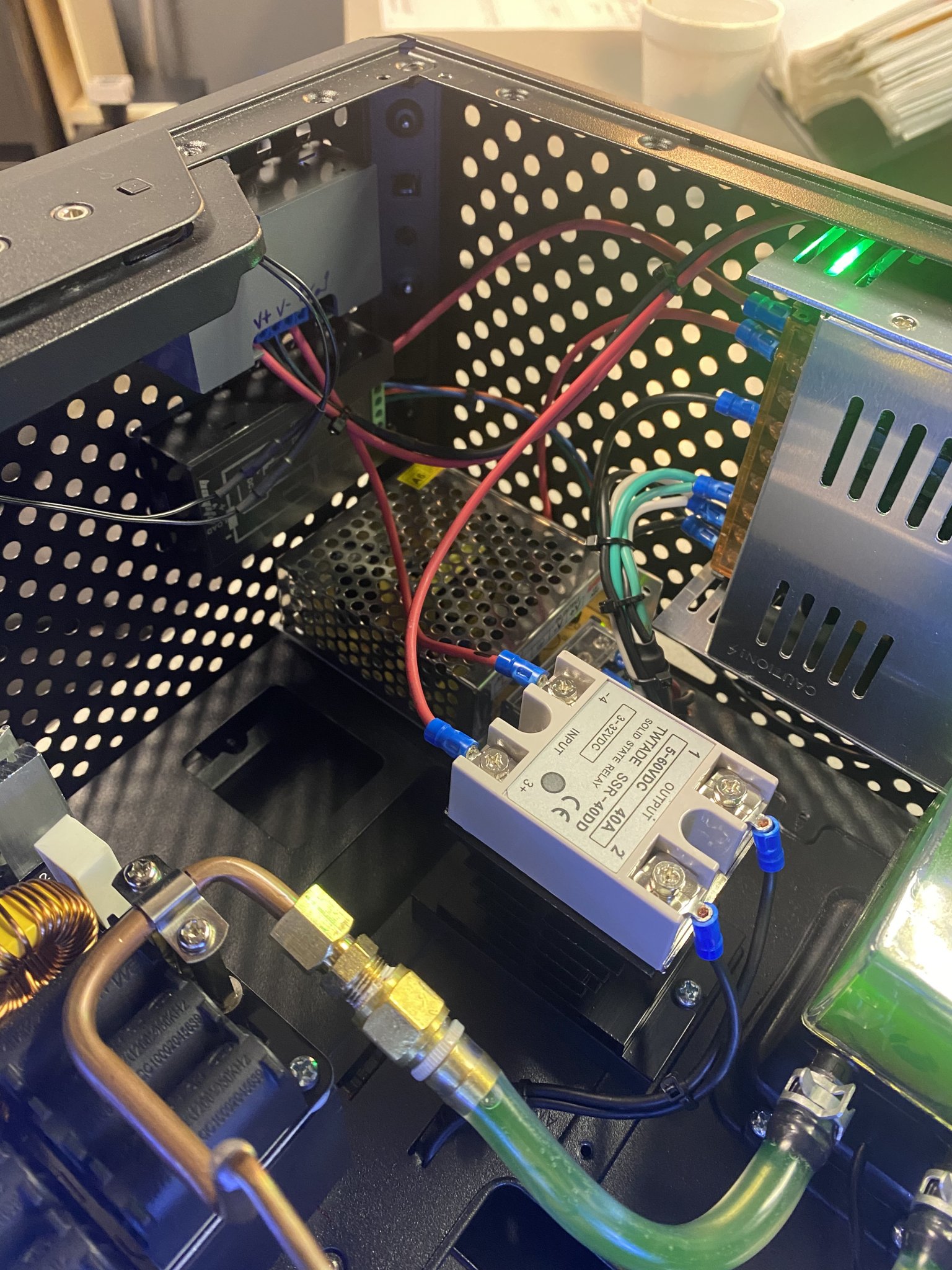

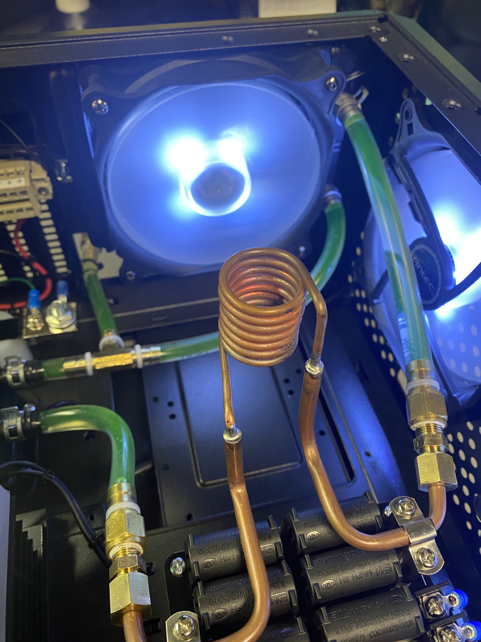

Hi, all. Finally finished the rebuild of my induction annealer!
Here is a pic of the original build
Rebuilt it into a full-tower computer case so that I would have room above the ZVS board and coolant system for the automatic case feeder.
Some things I've added since the original build:
- case feeder
- counter
- dual temperature display (coolant tank and ZVS connection to coil)
- flame sensor (can be used as primary case drop activator with the timer set to a little longer than the case needs, or as a backup to the timer in the event a case reaches flame sensor threshold before timer runs out...can also be switched off so that the timer is the only control)
- also, I replaced the 48V to 12V buck converter and used a computer power supply to provide all the 12V, 5V, and 3.3V power to run components not directly associated with the ZVS board, which also reduces the load on the 48V power supply
Here is a view with the case feeder cover closed and open (sorry its kind of dark in there...).
Tried to keep it as clean as possible for the view through the glass side of the computer case.
Not so clean looking on the other side, but I shouldn't have to look at it very often.
Here is a 'close-up' of the area around the ZVS board...hard to see anything with that cooling fan in the way.
Here is a video of me rambling while I run a 5 case demo (I think the counter double-counted one of the cases...hmm).
Thanks to all who provided direct help and to those that provided inspiration...I appreciate it.

And for those interested, here is a schematic of my build at this point...
Wow. I admire your fabricating skills!
By some miracle ive got my crude setup running in a hastily constructed plywood box... Just waiting for my drop solenoid to arrive and wire in a computer plug for AC power and its all done. I should come up with some way to raise and lower the shelf but it handles my 223 and 7mm08 just fine...
MKNZ arduino, case feed and load shelf. Some switches, an LED display, and water cooling. 48V 12.5amp PS (which supplies 16amp under anneal load somehow) and a separate 12V PS to power the arduino, fan, water pump.
Reactions: Snuby642
By some miracle ive got my crude setup running in a hastily constructed plywood box... Just waiting for my drop solenoid to arrive and wire in a computer plug for AC power and its all done. I should come up with some way to raise and lower the shelf but it handles my 223 and 7mm08 just fine...View attachment 7833641
Thanks, but I can't take any credit for the computer case, but most of the rest of the parts (mounting brackets, case feeder, front coil plate and platform) were all designed in Fusion360 to specifically fit that model case and were 3D printed and I'm pleased with how they turned out.
One observation on your build (looks very clean and well thought out by the way) is the flame sensor looks to be much closer to the coil than it needs to be. Those sensors will detect from a good distance away, and moving it up and out of the induction field would help to keep it from getting heated up as well. Oh, and case ventilation is a must.
PS - Originally I was building this in a white case and it was going to be called 'Storm Trooper', but I screwed that case up and could only get a black one, so it'll be called.......'Darth'.
You really didn't want Stormtrooper, anyway... The effect on the accuracy of anything annealed in that thing would be ... negative... LOL
I have had a notable improvement on my annealing time and consistency since rebuilding my annealing machine. The biggest thing that I did change with this build was the ability to adjust my case up or down in the coil. I have been able to fine tune the height and improve the anneal. I added the case drop also but the other components we reused.
To anyone thinking about doing the project...I say jump in and make one. My first one intimidated the hell out of me. I am a mechanical guy and do not do electrical and I managed to build mine without to much fuss. My biggest issue was me. Once I purchased the bulk of my parts I was overwhelmed with the job and thought that I was in over my head. I said to hell with it and started in on my first setup, that was all she wrote. Not as hard as I was making it out to be. I had great results, probably the second best improvements to my SD and ES overall, behind switching to a mandrel die.
Good luck.
Reactions: skotydontno
Hi,
Thank you for your help in advance.
I've been working on MKNZ arduino based annealer currently. It has been working fine but SSR keep shorting and puts my induction coil in a "runaway train" state. Melted a case or two already.
I took advice from @hdmunger and ordered (Same one he suggested) a general purpose 2 gate relay. The output from the Control board that supplies the SSR is only around 6V (See pic). Unfortunately the general purpose relay operates at 12V. The General purpose relay is not being tripped. I did check the voltage output from the Control board when I activate the start button and the relay is only getting 6V.
I will reach out to MKNZ but is there a way to use that 6V signal to activate the 12V general purpose relay?
Please excuse my lack of electrical knowledge. I do not working in that field.

Hi,
When I made that suggestion for relays, I wasn't aware you were using 6 volts to switch your SSR...my bad.
I saw your posts on the other forum (which shall not be named), and if you have access to 12V power in your build, you could use that first suggestion to use the SSR you have to switch the 12V mechanical relay in a kind of daisy chain affair (6V from arduino switches SSR, which in turn passes 12V on to activate the mechanical relay, which switches the power to the ZVS...makes my head hurt). If you don't have access to 12V, then I dunno.
The other suggestion about modifying the ZVS board to shut off the mosfets...well, that has had me scratching my head since it was first suggested, and for me, personally, seems overly complicated considering the lack of explanation/demonstration for us second graders.
Edit: Doh, just looked at the pic in your post and it looks like you have 12V in the upper right corner...powering the board I assume?
Edit: Dope, just looked at the pic in your post and it looks like you have 12V in the upper right corner...powering the board I assume?
Hi,
Thank you for reaching out. I'm still lost reading the other forum. I will take your suggestion to use the SSR and the daisy chain the mechanical relay with 12V. Thank you again.
Just finished mine up today. Many Thanks to some of the hide members for helping me out with my questions through PM’s.
Went with a 36v 16.7a power supply that is running the ZVS board only. I currently have to 36v PS adjusted to the max at 42v. Might tinker with the voltage later. I have a separate 12v 5a power supply running all other components, timer, fans, coolant pump, etc.
The coil is 1/8” OD copper tubing with 8 windings soldered to 1/4” tubing. Diameter is roughly 7/8” and it is 1-1/4” tall.
I made a few different coils with the same diameter but more or less windings to see what it would do. I settled on the current one because the neck on a 308 will have a faint glow at 4.5 secs. Tempilaq will be in later today and then I can fine tune it.
Currently it is peaking out at 7.3-7.4 amps and 310 watts when annealing a case. Seems low when compared to others. Checked for the normal issues but found nothing. It must be the way I have it set up....but it works.
View attachment 7873620View attachment 7873621

I originally cooked a couple SSR's in mine as well, but once I figured out that I needed to follow the wiring instructions and switch the negative lead rather than the positive lead to the zvs board, I haven't had an issue with the SSR.
Kristian
You have a great setup. What PC case is that. I see it is cooler master, but not sure what model.
