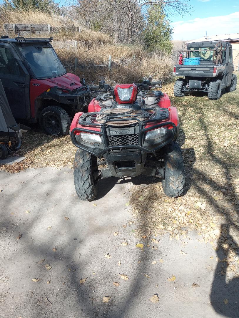

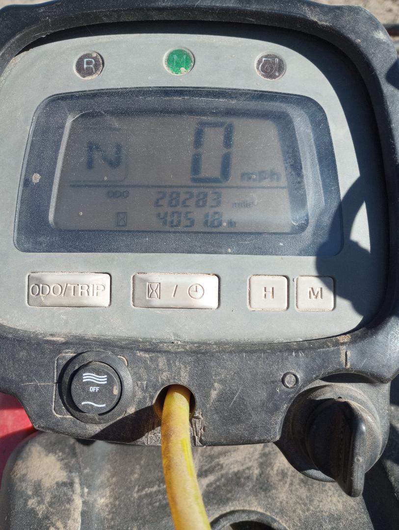

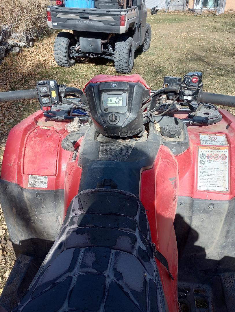

I have a 2015 Rubicon
Pluses: auto shift or Electric shift, 2 or 4wd, locking front end, nice ride and power, lots of rack space, dependable
And the durability of Honda is a plus to me

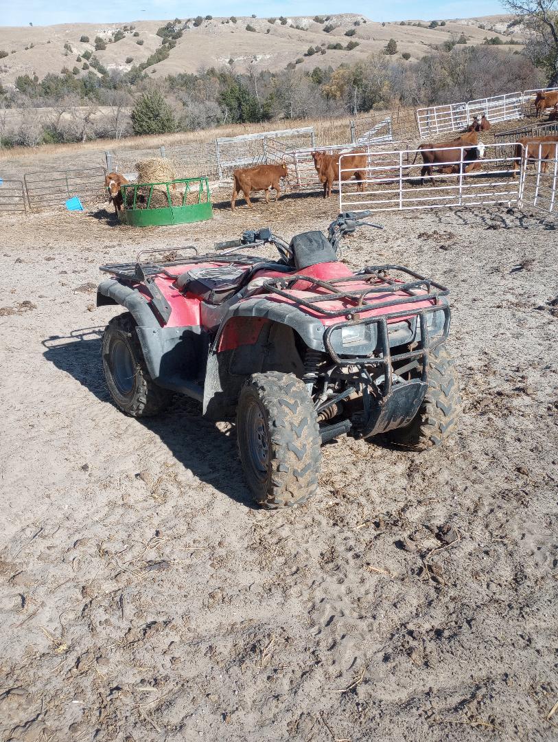

My 2004 Rancher, beat to death and looks it.
it has hit bulls and been hit by bulls, a very hard life and just won't die, starts every time and has never made me walk home
