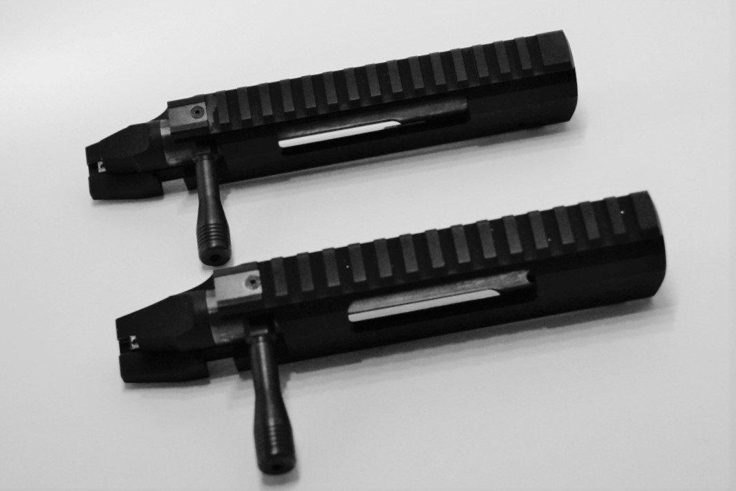

As to the bolt handle, mimic the AI. It's not just angle, but length as well. I personally feel, that putting the force for moving the bolt to the rear (and minimally offset from the longitudinal axis) makes the bolt movement "feel" smoother by not allowing a shooter to bind the bolt against the receiver wall. As we discussed earlier, I think this is why the "AI style" bolt handles are so popular with the Tikkas; they reduce the perpendicular leverage by the shooter when transitioning from unlocking the bolt to extracting (rearward movement) the case. As a result, the bolt operation just "feels" smoother. Essentially, you're pulling the bolt back, rather than dragging it back.
Again, just my personal thoughts on this matter.
It’s not just the angle but the dangle is just as important.
7117636
I have mixed feelings about the AI bolt handle and sweep. On my AI it's fine. That action sits really high in the stock so there is almost no circumstances where the back of my trigger finger comes into contact with the bolt handle.
On my Tempest and also on my Barnard ( I have a custom AI bolt handle on my Palma Rifle) the position of the bolt knob as well as the depth of the actions in the stock can put me in a position where the back of my index finger touches the handle. A lot on the Barnard, to the point that I have to shoot it thumb up and cannot grip the stock at all with my thumb or web. Not so much on the Tempest in the T2, but some weird angle shit makes me go thumb on index knuckle.
I see you have a dovetail for the handles so I assume there will be options. AI should certainly be one of them but a striated handle with a moderate ball or teardrop also works very well.

Hi,
I will draw up a swept bolt handle and see how it lays out in relation to trigger and grip.
As the bolt handle lays right now in Stage 1 model of chassis it is pretty hard to miss grabbing it during cycle.
Sincerely,
Theis
Trigger seems to sit pretty far back. Which is good for us folk with wee people hands.

Will the lapua bolt face action have 1/8th thread tenon?
Hi,
Sorry I overlooked this earlier today when I was replying to other questions.
The barrel thread specifications are the same for both the medium and large receivers.
M28x1.5 with 20mm thread length.
The breech plug has crazy fit tolerance with no threads, so it fits into receiver body then the mouth of barrel presses into the breech plug via the M28x1.5 with 20mm thread length.
Sincerely,
Theis

Looks a lot like the action Finnish manufacturer W&L Firearms marketed before they went belly-up.
Hi,
Good eye and international industry knowledge :).
Some changes have been made internally since I acquired them.
Myself and Tom have been working on this design for a while now.
Sincerely,
Theis

Theis, I think you mentioned the breech cylinder is held in place by the fit in the action and maybe the barrel. Is this correct? Is it going to be replaceable by the end user and do you think you will offer them as a separate part?
I really like the flat bottom design! It looks like the tang is pretty thick, is it or is it just the picture? This will make bedding super easy and provide a more secure contact with a chassis design with out having to skim bed.

Hi,
Myself and Tommi W. have been working on this design for a while now.
Sincerely,
Theis
Nah, not really international industry knowledge since I'm a Finn but I thought I'd seen a similar design somewhere ? Glad to see it surfacing again.
