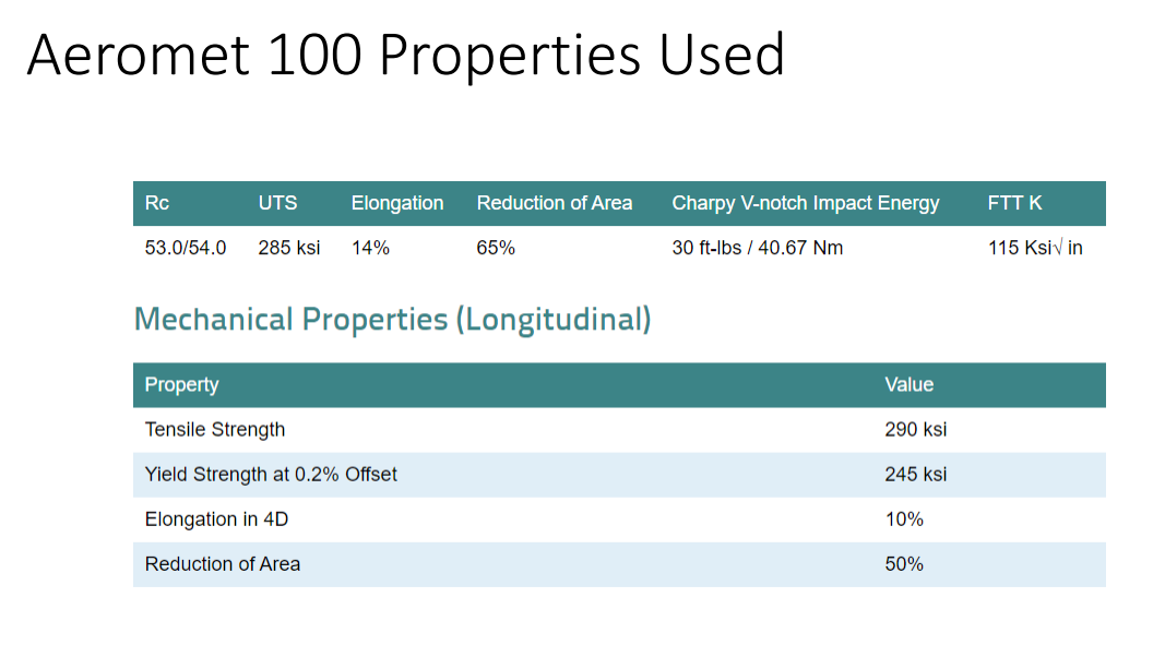

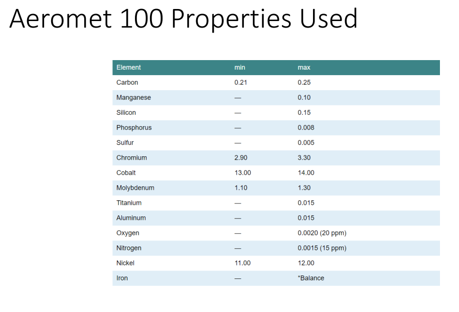

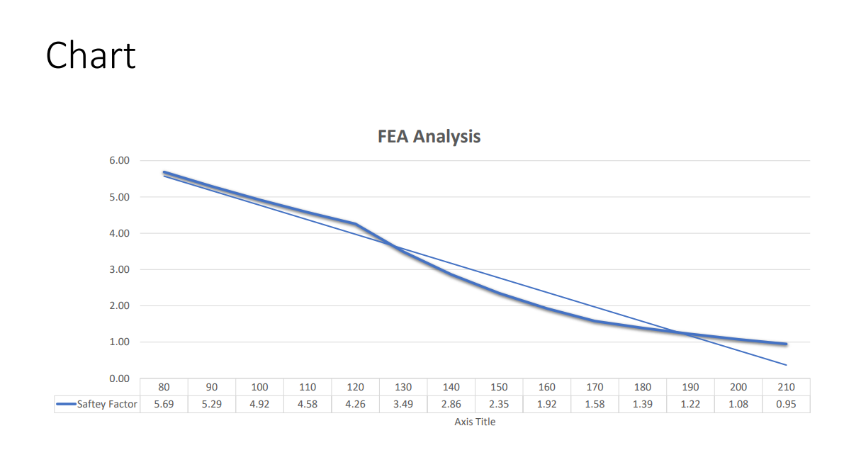

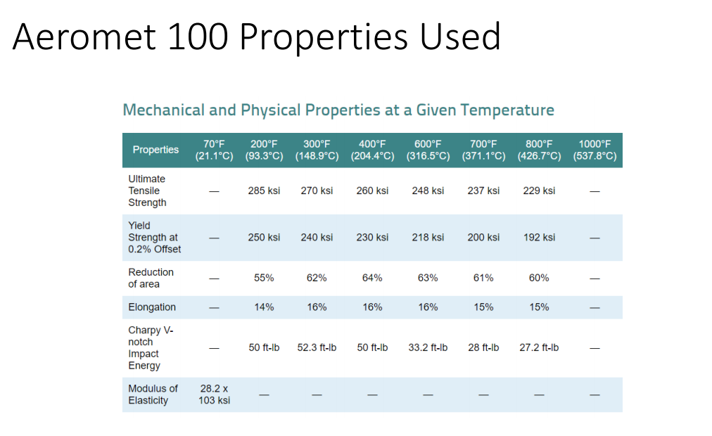

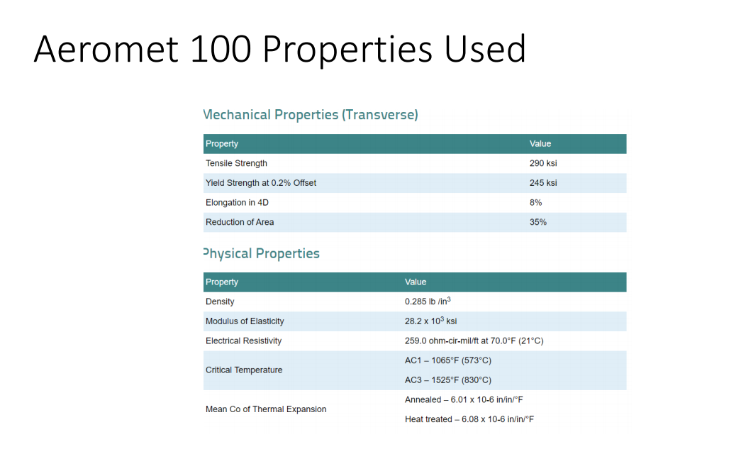

Here is another example of why we say we are making one of the strongest IF not the strongest bolt action receiver available...
This is FEA done with running Aermet 100 alloy for the bolt and breech cylinder with receiver body of 4140 HRC 45.
At 120k cartridge pressures we are at a safety factor of 4.26.
Notice at 130k cartridge pressures the analysis no longer follows a straight line decrease but then stabilizes back out at 180k cartridge pressures. When our engineering department first seen that it really intrigued us. So much that we ran it again, lol and got same results. We got same results from manually entering the Aermet 100 specs and auto entering from database.
Don't worry of "but that just software analysis"...we doing same test with real detonations, lol

I can confirm that AerMet 100 is one Bad Mama Jama of a material. It is commonly used for high-strength, high-toughness applications like airplane landing gear. And the Cobalt and Nickel added to it ain't cheap...

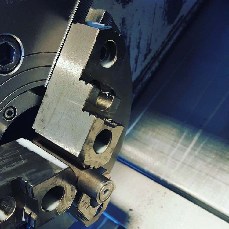

Ok so you heard it here first, lol....DMID (Details Matter In Designing).
Turning and cutting a bushing that really does not get seen once the bolt is assembled but it plays an important role in the overall ruggedness and efficiency of the system.
Not only does it help to keep the firing pin centered and guided, it keeps the dovetailed bolt handle from being able to be removed from the bolt body.

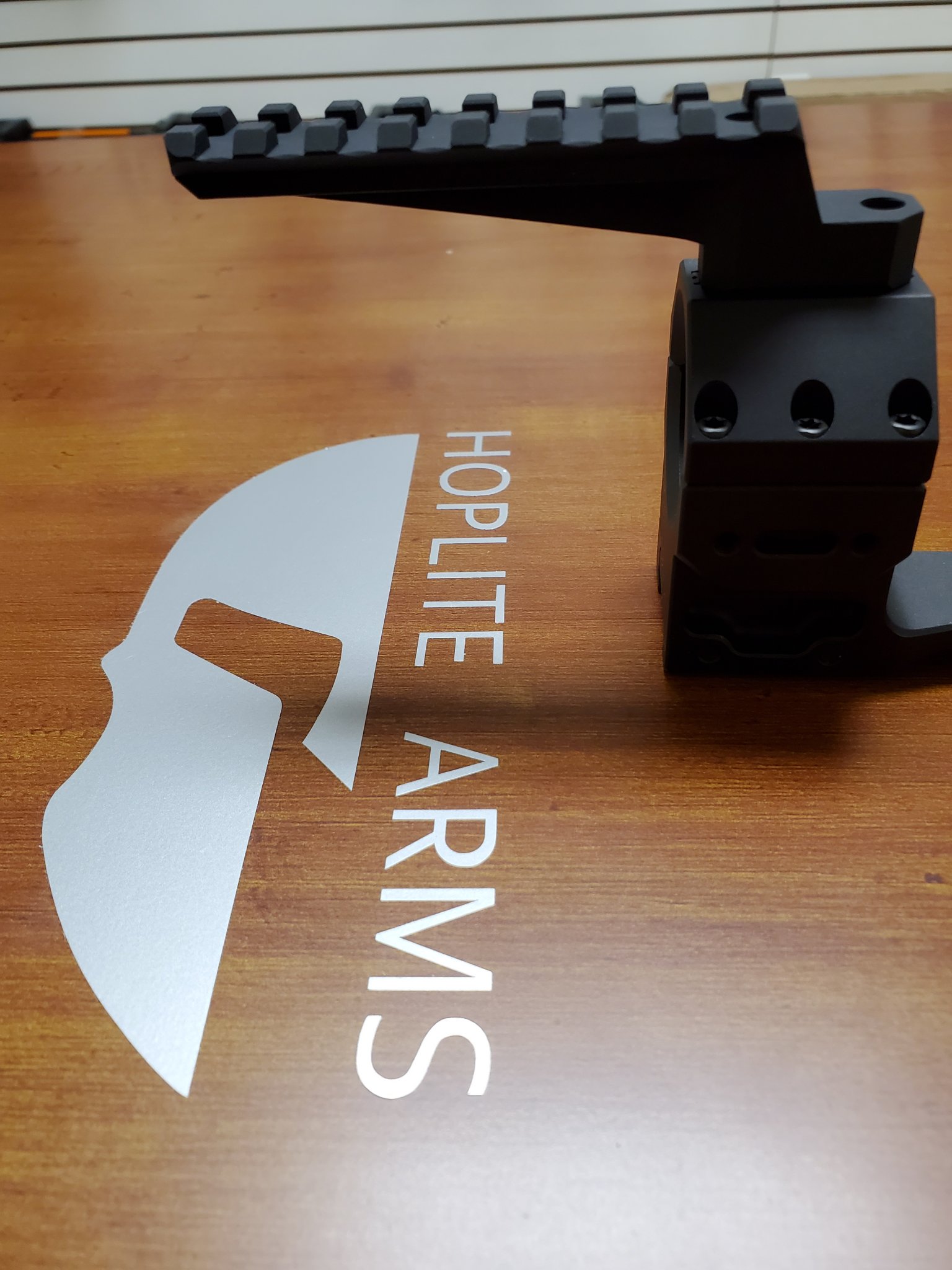

Hi,

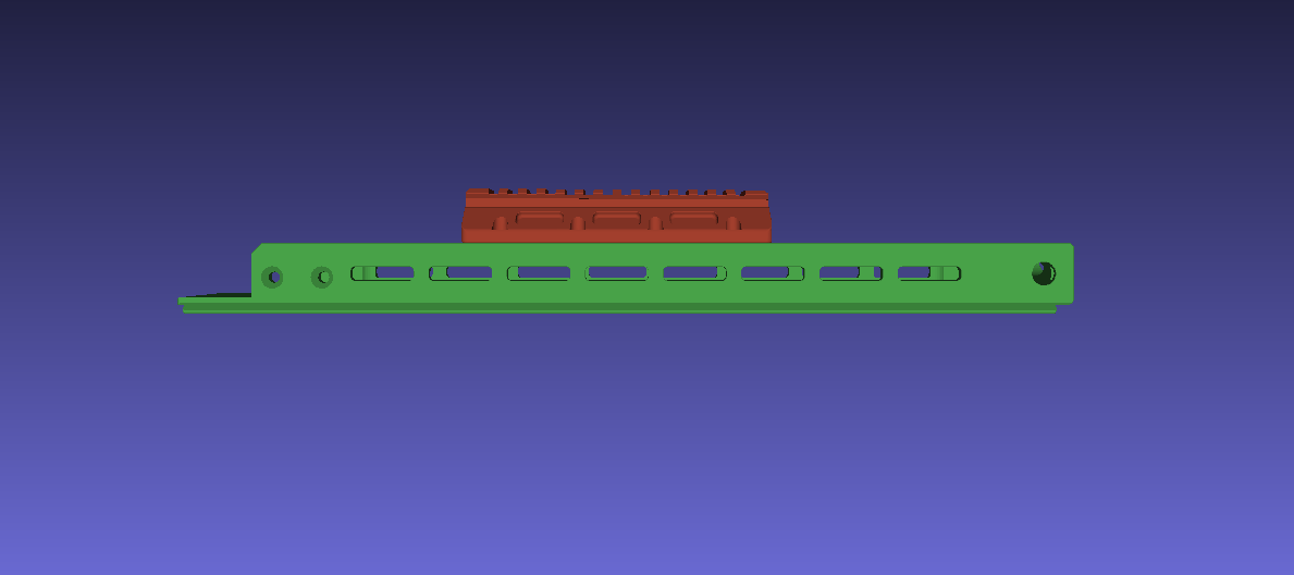

Need some PVS 30s to go on top of this new NV Bridge.
6 inch NV Bridge sitting on 18 inch forend.
