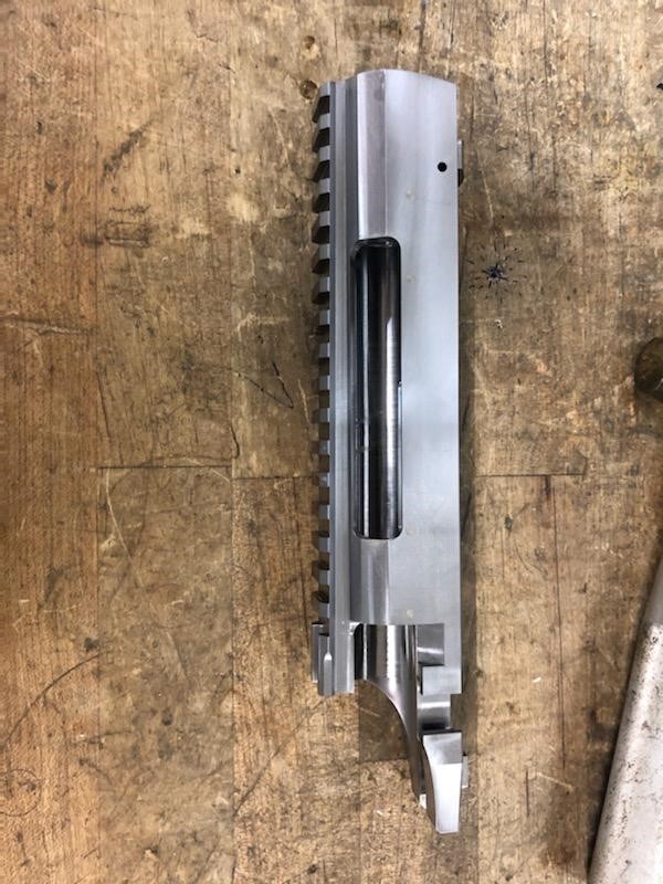

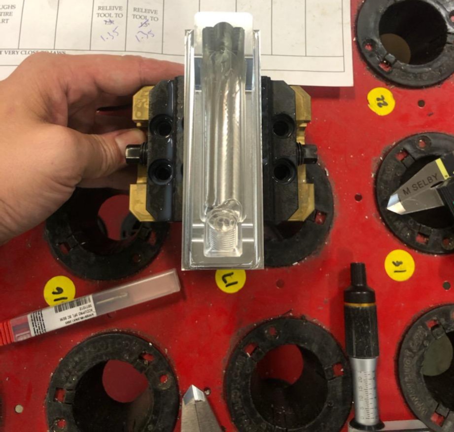

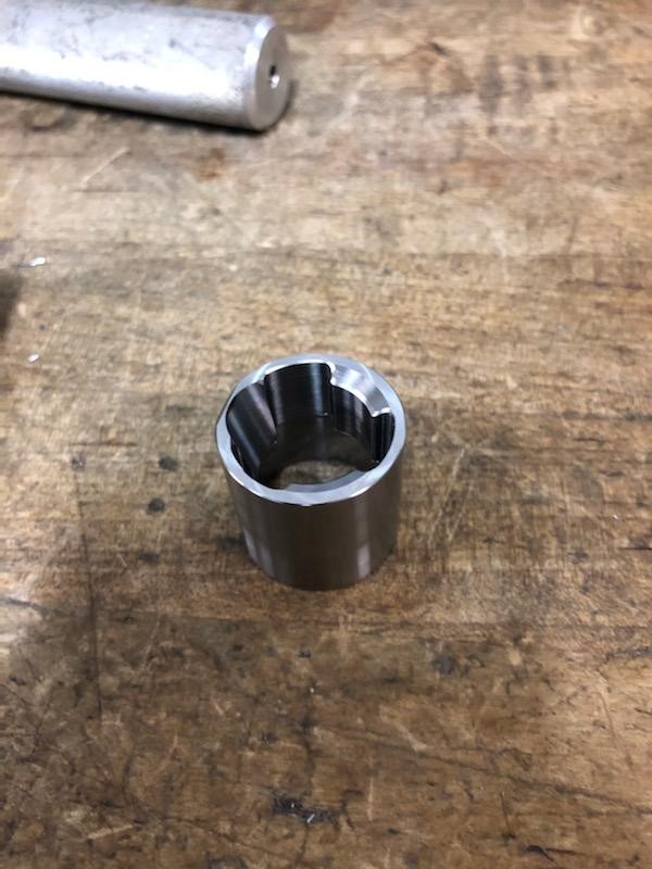

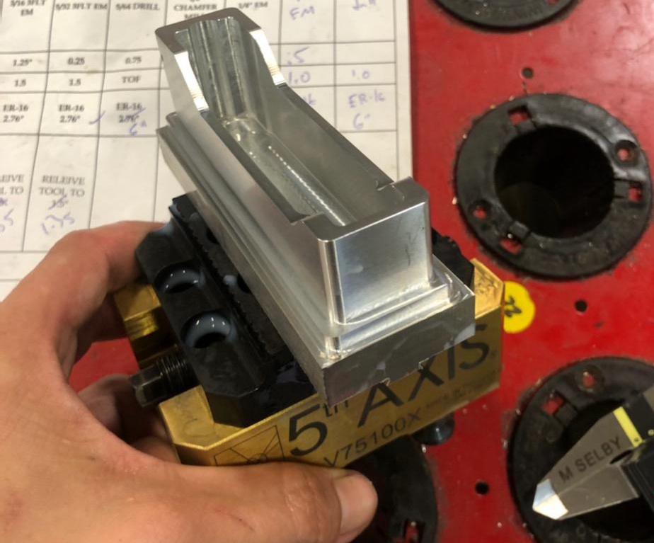

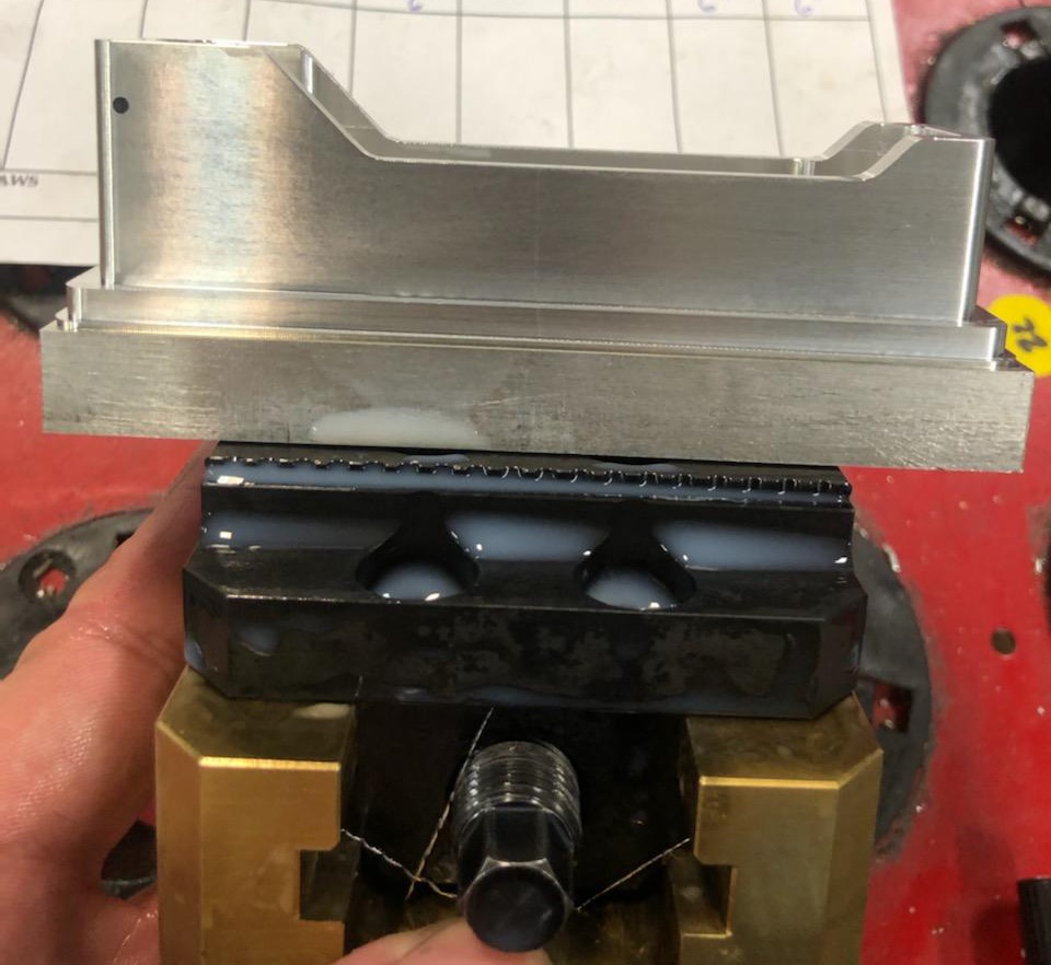

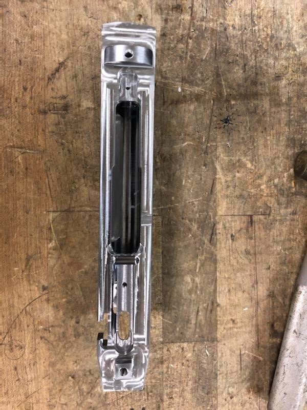

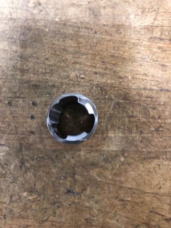

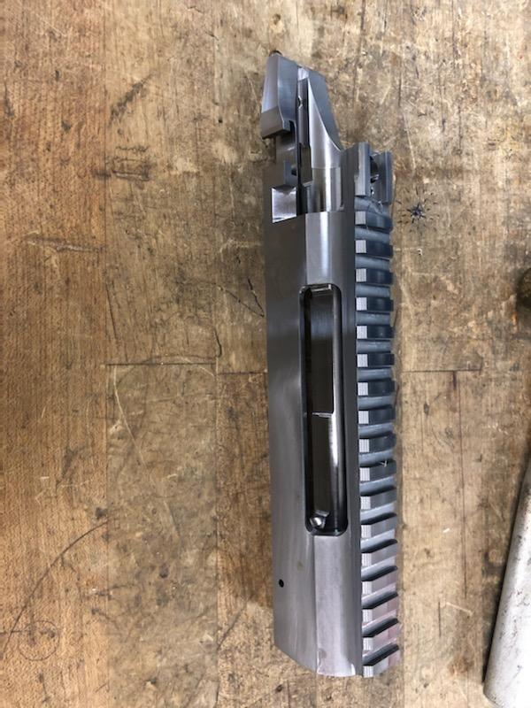

Hi,
Successful Monday....
New breech cylinder design completed. The clover leaf shape actually provides a good amount more surface space to handle pressures and still be able to keep the entire receiver footprint as narrow as possible. Aermet 100 with 47HRC, all machining done after heat treatment.
New receiver body design (Only the action screw hole spacing in order for easier machining of the chassis section).
Doesn't look too bad right off machine with it being 4140 with 45HRC..all machining done after heat treatment to eliminate any issues with cutting then treating. It sure changes the machine cycle times though, lol
Heading to deburring then engraving...

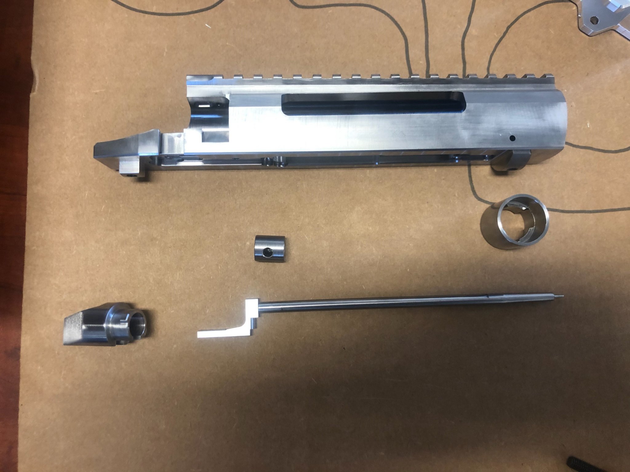

Hi,
New firing pin completed.
New bolt is at EDM right now for the bolt handle dovetail due to the Aermet 100 properties and we do not want to break tools while cutting the dovetail angles/corners.

Is there a reason you’re machining 0.25 instead of hogging it out and then broaching the corners?
Hi,
My honest (Non Engineer, Non Programmer, haha) Saturday sitting at home answer is because that is what the programmer/operator told me how he was doing it, lol.
I will get real answer from him Monday morning when he comes in.
Sincerely,
Theis
That’s a good enough reason lol
Hi,
You not going to get me into a debate with you engineering/programming guys that definitely know more about machining than myself.
For most time I know what I do not know, which at times can be more important than knowing what I do know. lol
