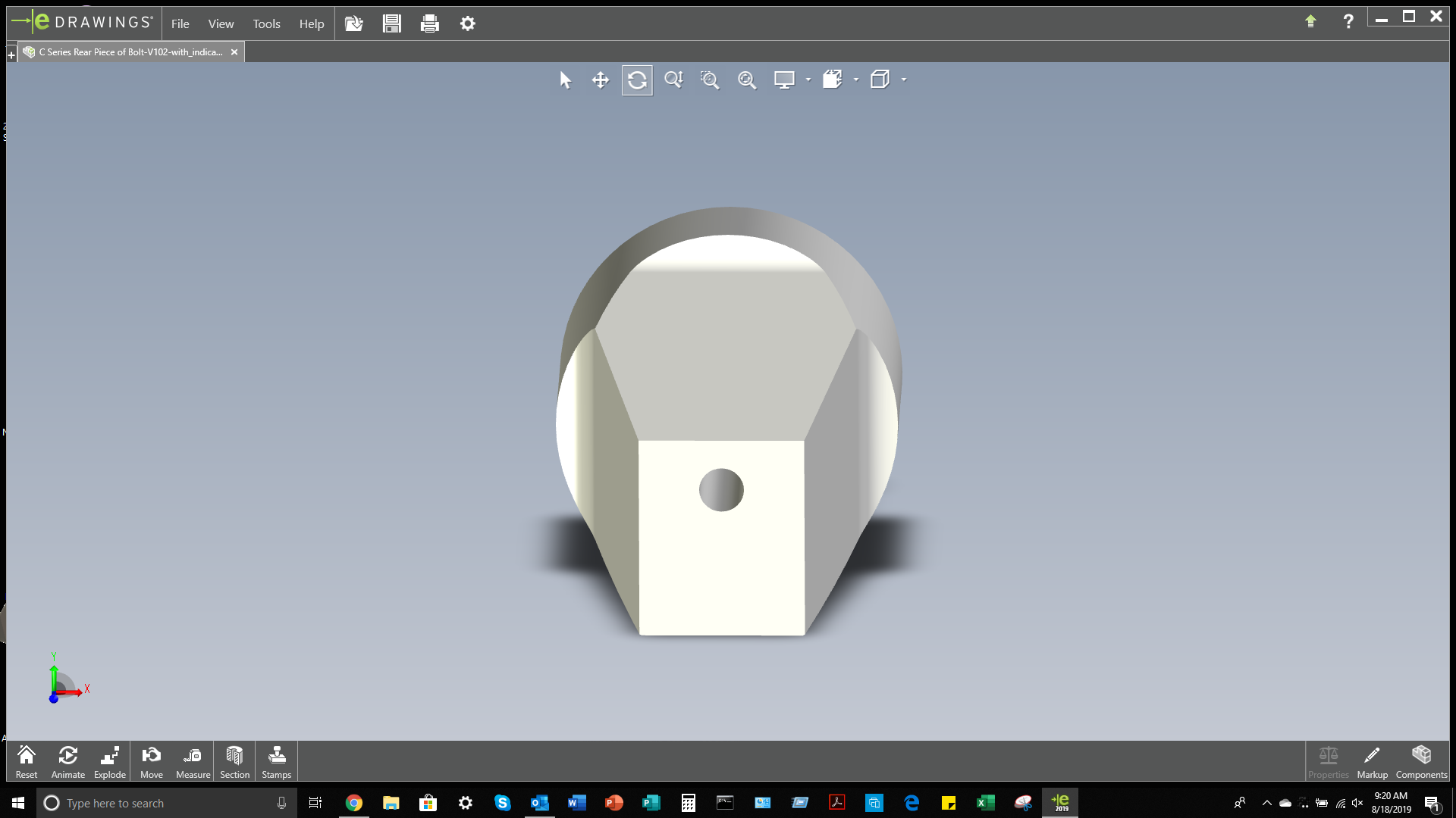

nice video puts the specs and drawings in perspective
what coating (if any) was on the bolt/action

The action body lying on the table and the rear piece of the bolt is just cerakote.
The bolt body itself was an experiment in regards to attempting to add a coloring process after heat treatment but as you can see; it does not work very well with the steel alloy.
Edited To Add: Remember the alloy and treatment specs are as follows..
–Receiver 42CrMo4, HRC 45, Salt Bath Quenched.
–Breech Cylinder 34CrNiMo6, HRC 47, Salt Bath Quenched.
–Bolt 34CrNiMo6, HRC 50, Salt Bath Quenched.

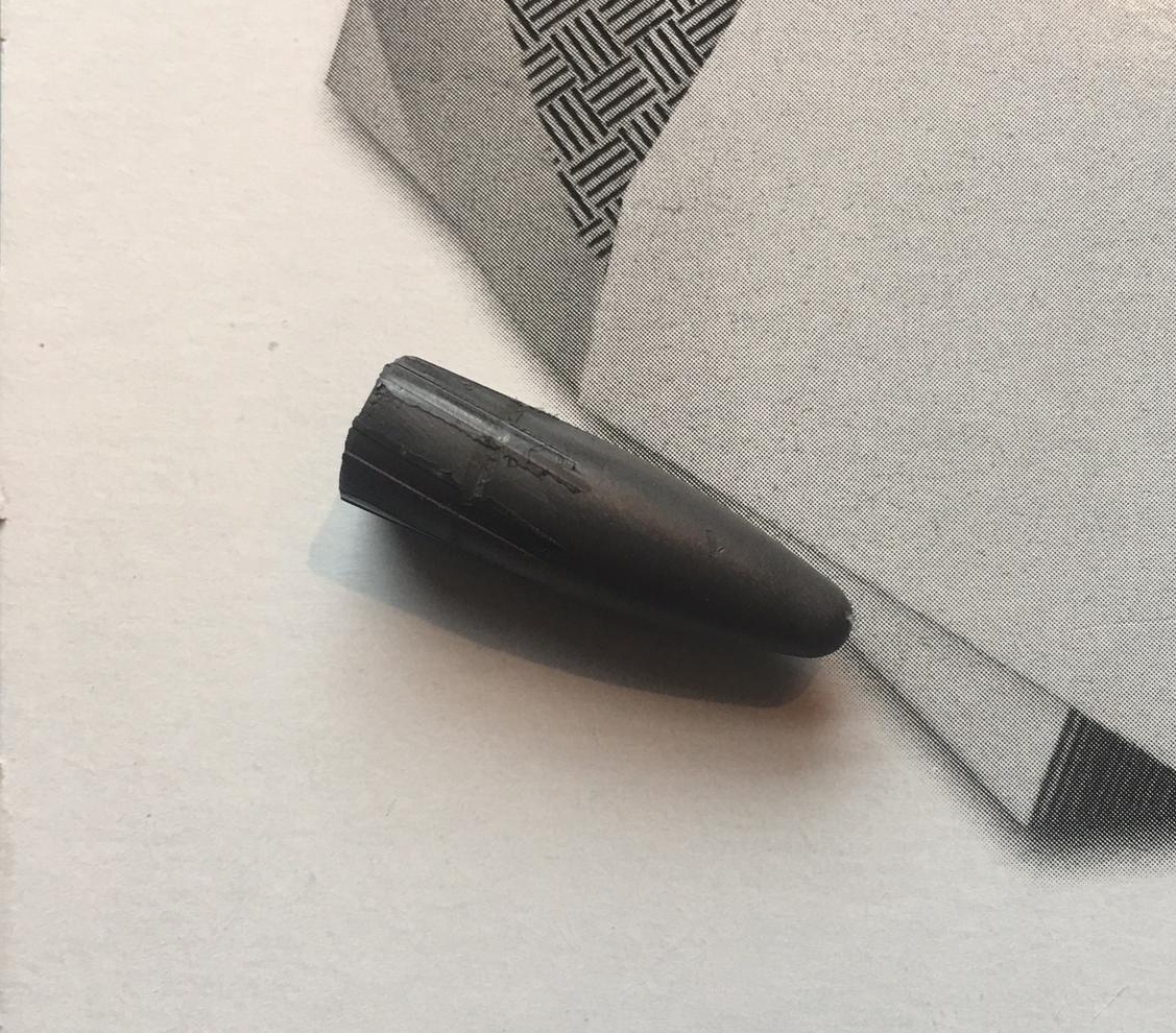

So Nano polymer over tungsten projectile?
That would be really cool, assuming you get it worked out to have the coating thick enough so the barrel doesn't get damaged.
The weight to size ratio should let you make some really interesting designs.
Reactions: TACC
Hi,
Getting the nano polymer thick enough to keep the tungsten from ever coming into contact with the barrel is the easy part.
Right now we are testing the actual polymer "mix" so that the snowplow effect of the polymer in the grooves becomes non-existent.

No copper in the entire projectile.
Sincerely,
Theis
Got that part, the projectile is tungsten with a nano coating.
I was just curious if the coating had any copper in it.
Does the lead angle affect how much the polymer plows on the projectile?
Or,
Does the plowing occur because of the low adhesion of the polymer?
Or,
Hi,
Yea, I was meaning no copper in any part of the projectile including nano polymer :)
At this point we have not had any indication that the lead angle has any affects.
At this point in testing, the slower the projectile the less that it cleans itself. At higher MVs the polymer cleans itself more.
Different nano polymer compositions are being tested to optimize the balance of friction, engraving and buildup minimization.
The nano polymer is really not a coating in the sense of traditional coating as in applied after the projectile is made. It is actually high compression/high heat molded onto the tungsten itself.
