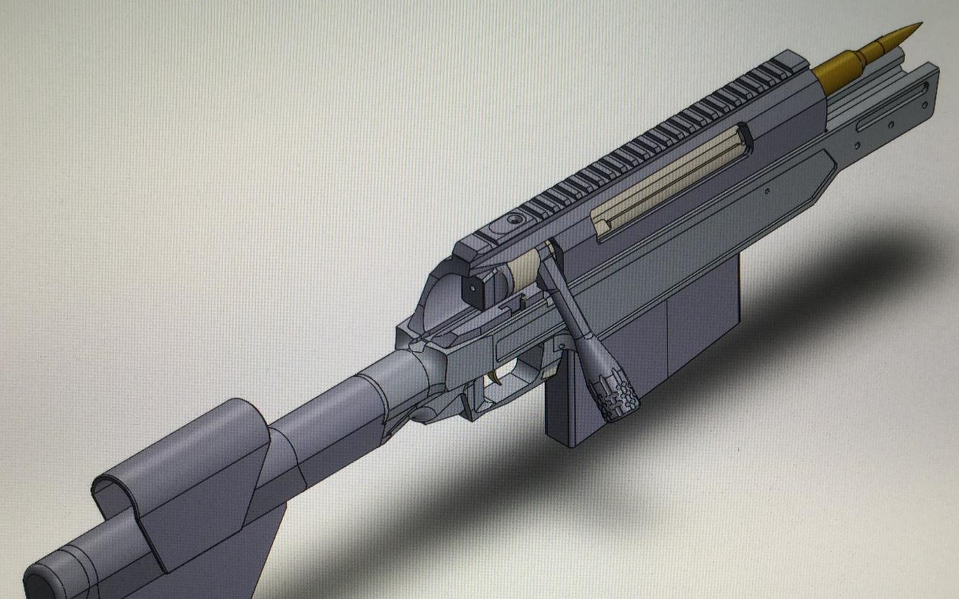

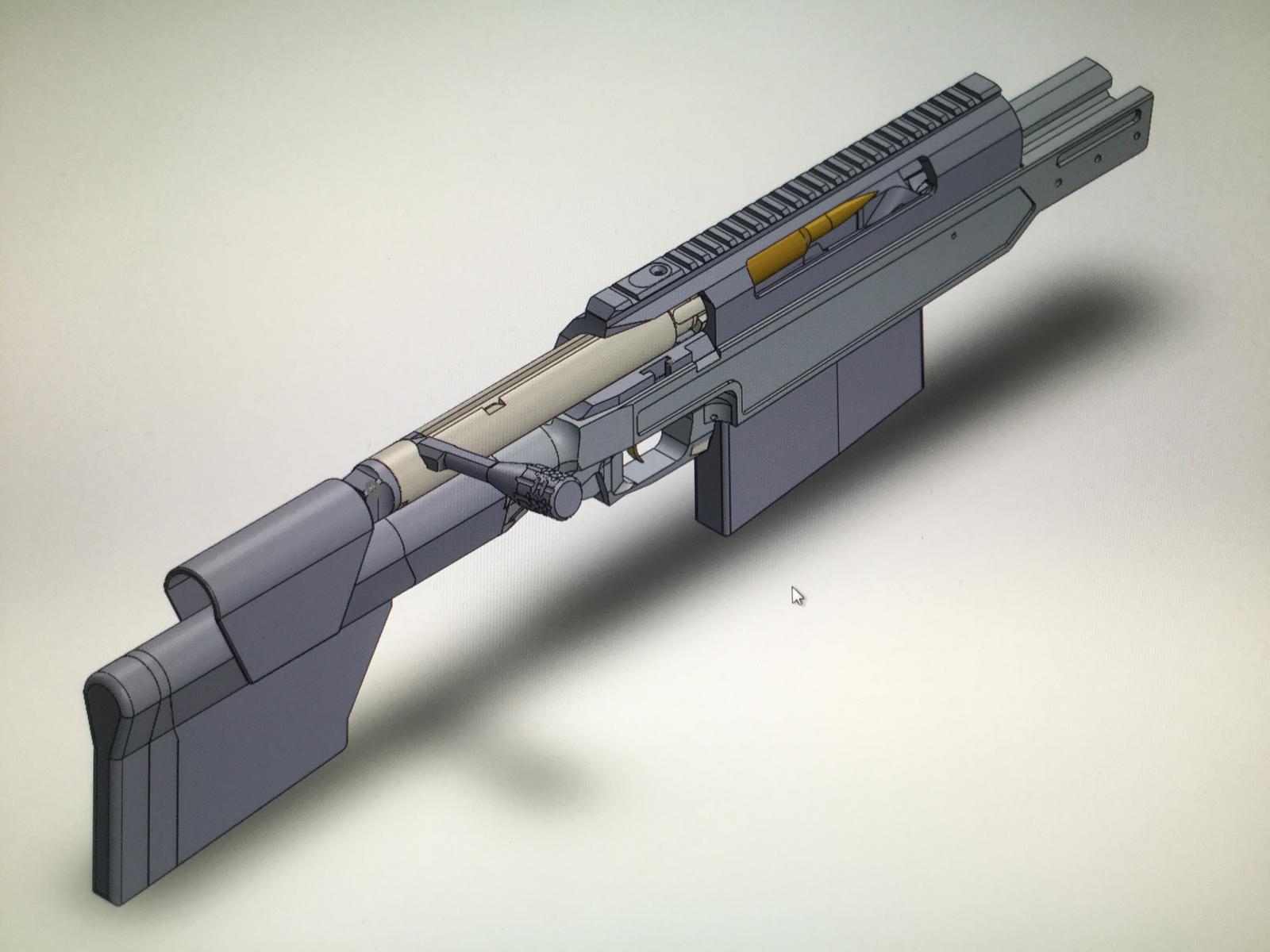

Hi,
So the BMG size receiver technical package is almost ready to reach the machines :)
Sincerely,
Theis
Serious looking pic of kit right there
double plungers like the other actions as well?
what mags are you expecting to use
Hi,
The Kopis utilizes AI #6852/6955.
The Aspis utilizes AI #20400.
The Phalanx utilizes AI #4719.
All receivers utilize double plunger ejectors.
Sincerely,
Theis

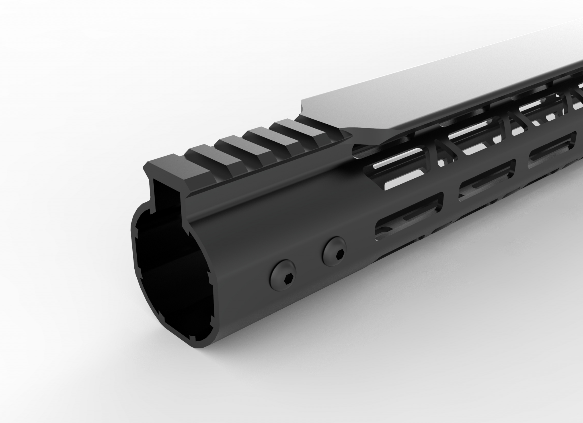

is there a standard for arca rail.
i dont have one yet but i though i read on another post that sizes are not standard yet?
could be wrong though
looks like a over sized BR bag rider lol
There is no standard for ARCA Swiss. What you want is a rail built to the RRS dovetail standard. As a community that’s the standard we r striving for.

I assume RRS dovetail standard? What length you thinking? Still just 15 or maybe a 17-18 option?
Hi,
From the RRS provided specs directly!!
Longer will be available since I will need a longer for the Phalanx weapon anyways :)
Hi,
Just FWIW...We modeled up an 18 inch version this past weekend with pic rail area the exact length we need to fit into the Doru chassis center section.
RRS Dovetail specs and now testing to see what M-Lok slots incorporated in middle of dovetail functions like.
I actually like the 18 inch version better than the 15 inch version because of the length amount that gets set "into" the chassis center.
Sincerely,
Theis

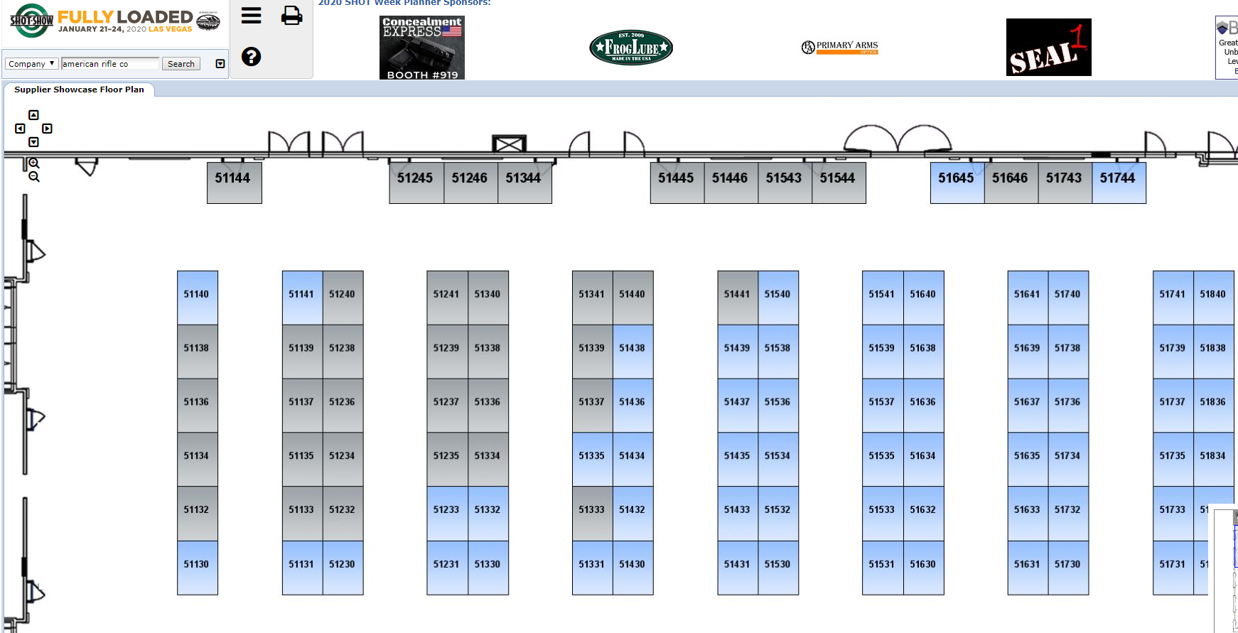

Hi,
So with Shot Show now requiring first time exhibitors to go through the "Pop-Up Preview" or the "Next" program in order to be able to get full booth capabilities for the following year; Hoplite Arms will be exhibiting during the "Pop-Up Preview" day of Wednesday on the 5th floor.
I have requested and had my account noted that we want Booth #51144 in the corner area.
Sincerely,
Theis
Sincerely,
Theis
