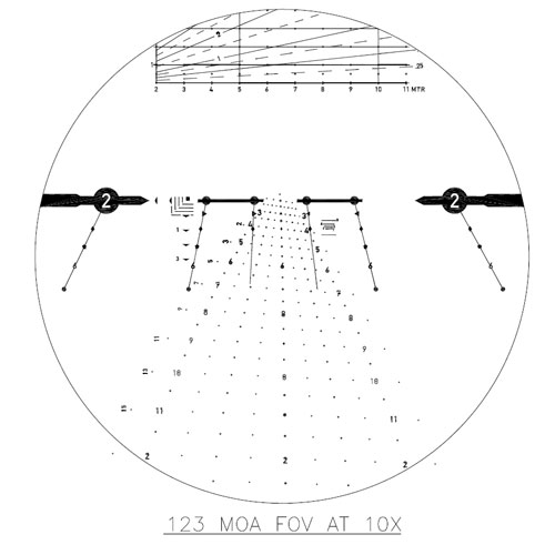

    David Tubb's Dynamic Targeting Reticle accounts for this effect in its wind dots
