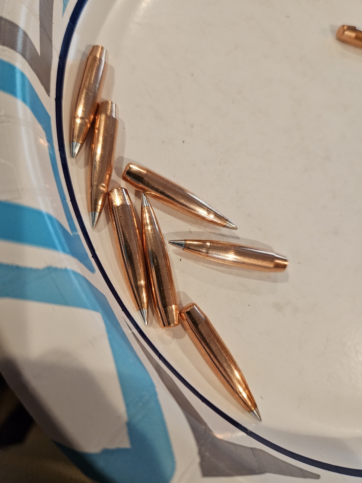

Didn’t notice any like that. Ill have to keep an eye out when loading.FedEx dropped packaged yesterday, 1500 106 atip seconds. Sorted 600 by bto. I had approx 2/3 of them fall within 0.575-0.579, maybe 30pcs 0.580-583, then another 1/3 0.584-0.588, kicked out a few outliers that we're really short 0.563-0.567 and 2 were 0.590+ also 8 pcs that we're uniformly dented around tip about 1/3" below the aluminum point. Also a few with loose tips.
I'm done sorting. Going to work up a load with the short bto group, get it shooting 1/3moa or so, then test same load with long bto, and compare, if shooting well, I'll mix serval rounds of all bto sortings and see how they do on the 680y e-target, if it's all at half moa or better at distance, I'm not gonna sort other than kick out the ones with damaged noses. Pic posted of funky noses.
