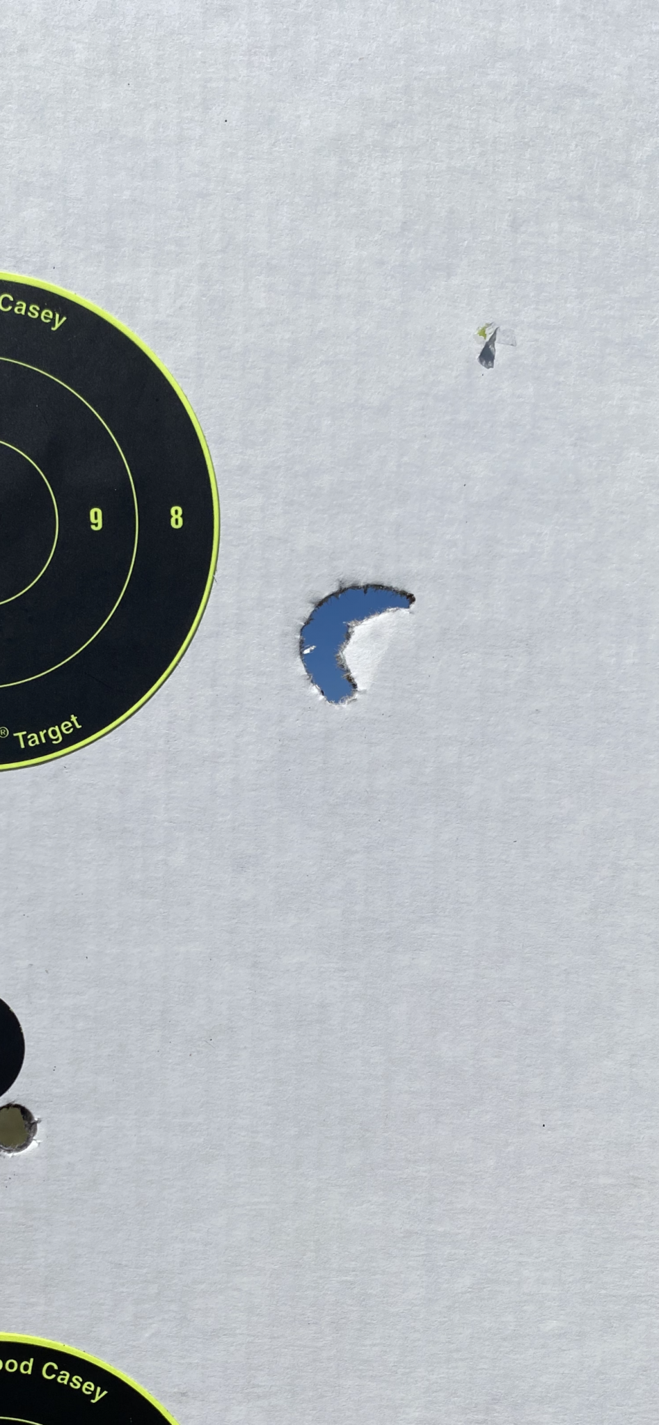

Over the past 2 weeks i've talked to at least 15 people who have experienced both factory Hornady 6.5PRC and reloads using 147gr ELDM bullets coming apart between 40 and 150 yards down range.
June 13/14th and 20/21st I had back to back matches. The NF ELR outside of casper and SnipersHide Cup in eastern Washington. I planned on shooting factory 300PRC 225ELDM for the ELR and factory 6.5PRC for the hide cup. Normally I would reload but I bought a house just before the covid bullshit and i've been putting in new flooring. I haven't even unpacked my reloading equipment. I had time to prep and test the 300PRC which was showing good results, I didn't bother testing the 6.5PRC because I was going to shoot the same lot and barrel that I shot at the NF ELR last year and had zero issue.
At the NF match, the factory 300 worked pretty well, yet one of the guys in my squad (Steve) was going to shoot factory Hornady 6.5prc. During zero, he got 5 round on target which grouped around 1-1.5 inches. Pretty horrible really considering last year that same rifle with the same lot of ammo was shooting 1/2 inch. He asked me to zero his rifle to double check he wasn't just screwing something up majorly. I got behind the rifle, double checked turrets were zeroed, picked a fresh shoot-n-see and broke a shot. Nothing. I had @NoLegs24 get behind me and watch over top to look for anything out of the ordinary. Second shot I took, I watched a banana appear about 6 inches away from point of aim and I hear laughing behind me as he said there was a white puff around 40 yards down range.
I passed the target around to a few people at the match and multiple people spoke up saying they have either experienced the same thing themselves with the 147gr ELDM or they know of some who has had the same issue.
Luckily we drove to Wyoming and most of us brought 2 guns. Steve was able to use a 6x47 which he got some hits at 1400 with.
After the match, we drove home and because the SH cup requires short action calibers, I swapped to my 6.5PRC barrel (Bartlein 5r - 1:8) and had a bunch of factory hornady. It worked great last year so I figured it would be fine this year as well. Fast forward to thursday and we flew out to Spokane. Pulled my rifle out to check zero since I didn't even have a chance to shoot between getting home from Wyoming and flying to Spokane.
Fuck me, wouldn't group for shit and bullets were blowing up just past the 100 yard line.

@NoLegs24 was shooting a 6.5PRC also, our barrels were ordered together and probably came off the line one after another from bartlein, they were both chambered one after another by Matt at Sawtooth rifles. He hand loaded 140 Nosler RDFs at 2950 and had no issues. The issue here comes down to the 147 ELDM. Factory ammo should not come apart like this.
According to the RPM formula (12/8 = 1.5*3060 = 4590*60 = 275,400RPM) these 147s should not have been coming apart. Anything over 290,000 rpm is the danger zone for bullets coming apart.

FWIW, I was in Casper and lost a total of 14 Sierra 150 MKs over the two days (6.5 PRC at 2980 fps). This was a Bartlein 7.5-twist that had 729 rounds of nothing but H1000 and 150 SMKs on it when I finished the match. I called Sierra and they told me my load was over pressure.
Another in my squad lost 6 A-tip 153s out of a Kreiger 8-twist 6.5-284 at a rather innocuous 2820 fps (less than 1000 rounds of H1000). A neighboring squad had a shooter loose about half of his 153 A-tips out of a 6.5 PRC on day 1, cleaned his rifle Saturday night then had better results Sunday but still experienced disintegrating bullets. Very low round count rifle built specifically for that match.
No consistency in mine really. Some would let go 100 yards out with an audible pop and grey cloud. Some would veer off like I sliced a drive off of the tee. Others, the spotters would lose trace roughly halfway to the target with no splash on or near the target.
...wondering if it's more of a medium to large-size 6.5 issue... I'd love to know the root cause. I bought a Teslong when I got home but was unable to identify any obvious issues in the bore.
I had a buddy with a 7.5 twist Creedmoor and an 8 twist prc run into the same issue with the 147s. Neither load was very hot.
