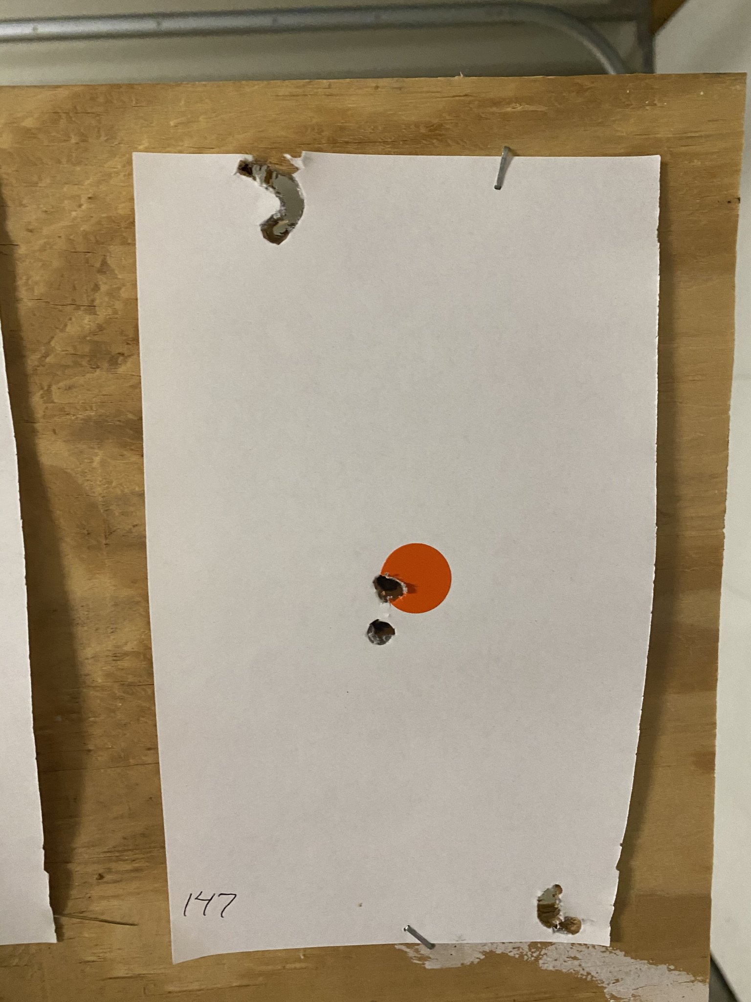

Some of mine were hitting sideways at 100 shooting 147 eld factory. Some didn’t even make it to the target. Very frustrating host a case in early 2020.
