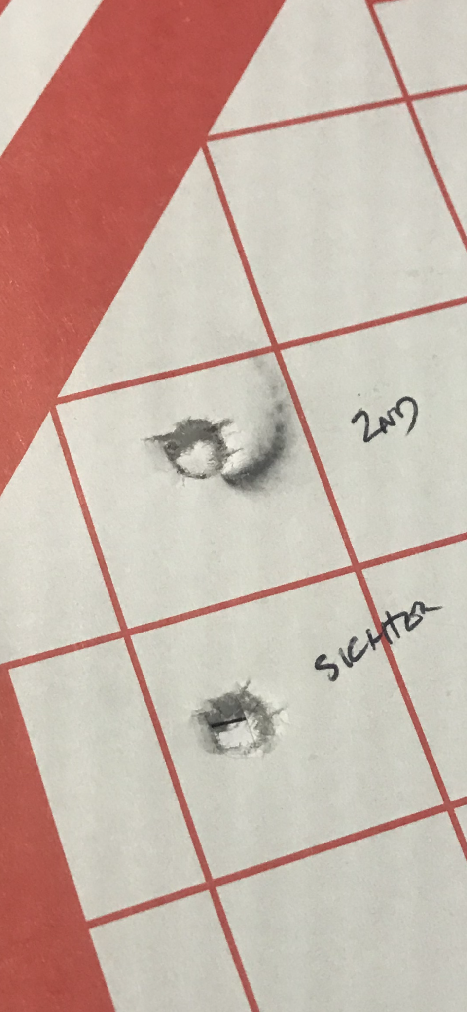

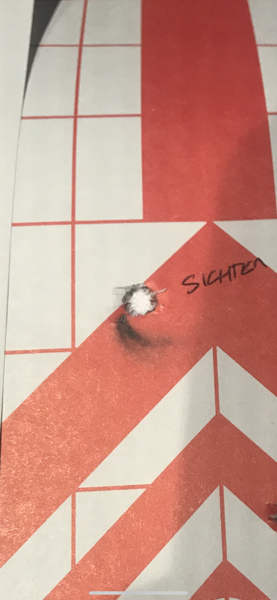

Range Report Hornady 147 ELDM blowing up
I have been running the 147 gr. ELD-M's in hand loads at 2860 fpm...the most recent bunch I am now shooting were purchased just before the latest shortage really got cranked up...like April? I have run almost 500 of them and not one has blown up. I'm not saying it ain't happening - I'm saying there is more factors involved as contributors. It's a Savage 10 with a 24" barrel and 1 in 8 twist.
VooDoo
Dear Abby,
The guys on SH are scaring me. A bunch of them are having problems with 147 ELDMs blowing up after leaving the barrel.
I'm getting a rifle re-barreled to 6.5 CM with a 1:7 twist. I also ordered a bunch of 147 ELDM factory ammo.
Should I be worried? It's too late to switch to a slower twist barrel. I suppose that I could use the factory fodder in another rifle.
Should I use that as an excuse to get me another rifle and shoot heavier Bergers in the re-barreled rifle if the Hornady stuff doesn't work out?
