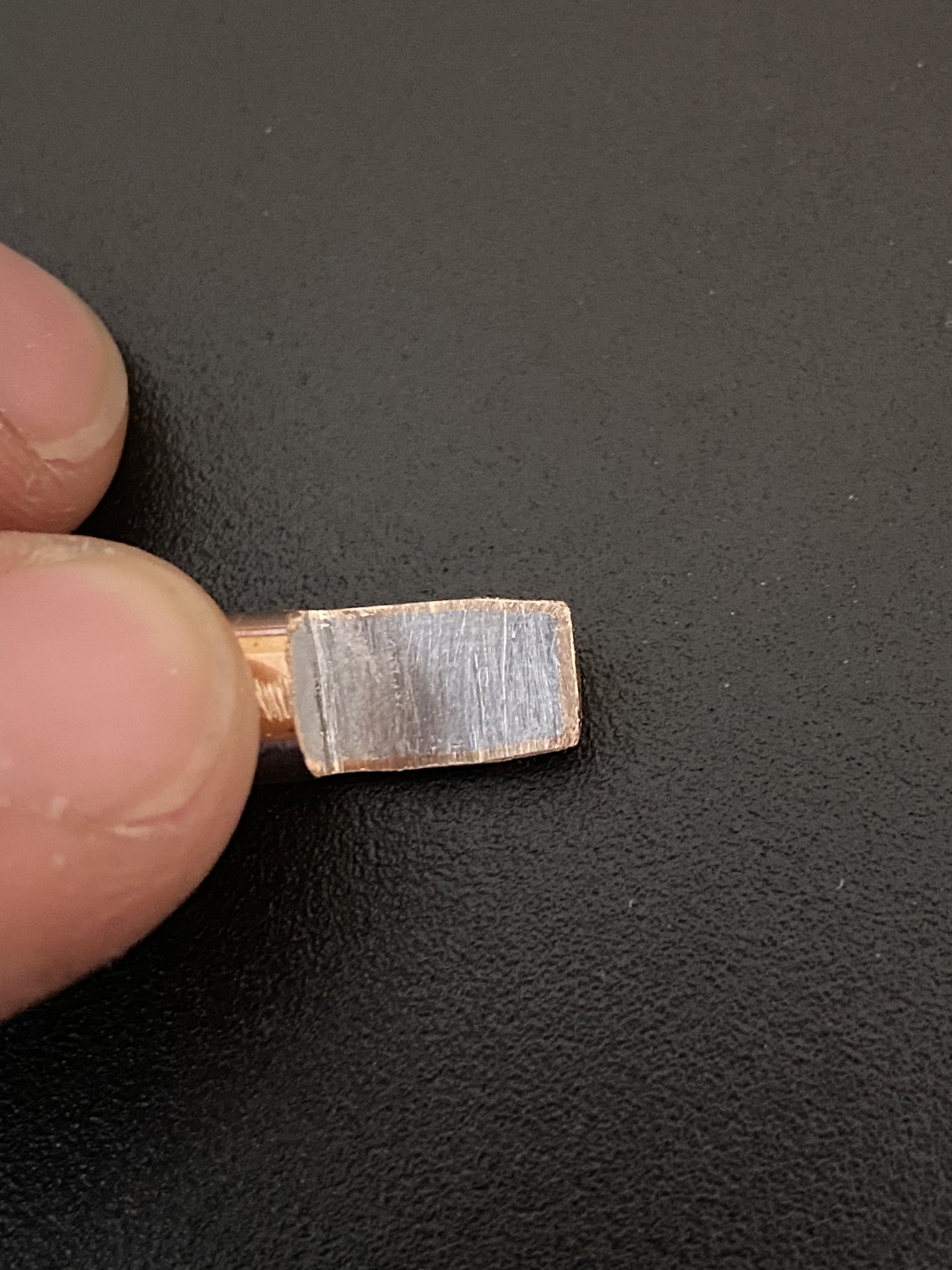

I will say the jackets are super think on the 153s, I have recovered quite a few of my intact rounds at 2000 yards and you can see the wad in my groove marks.

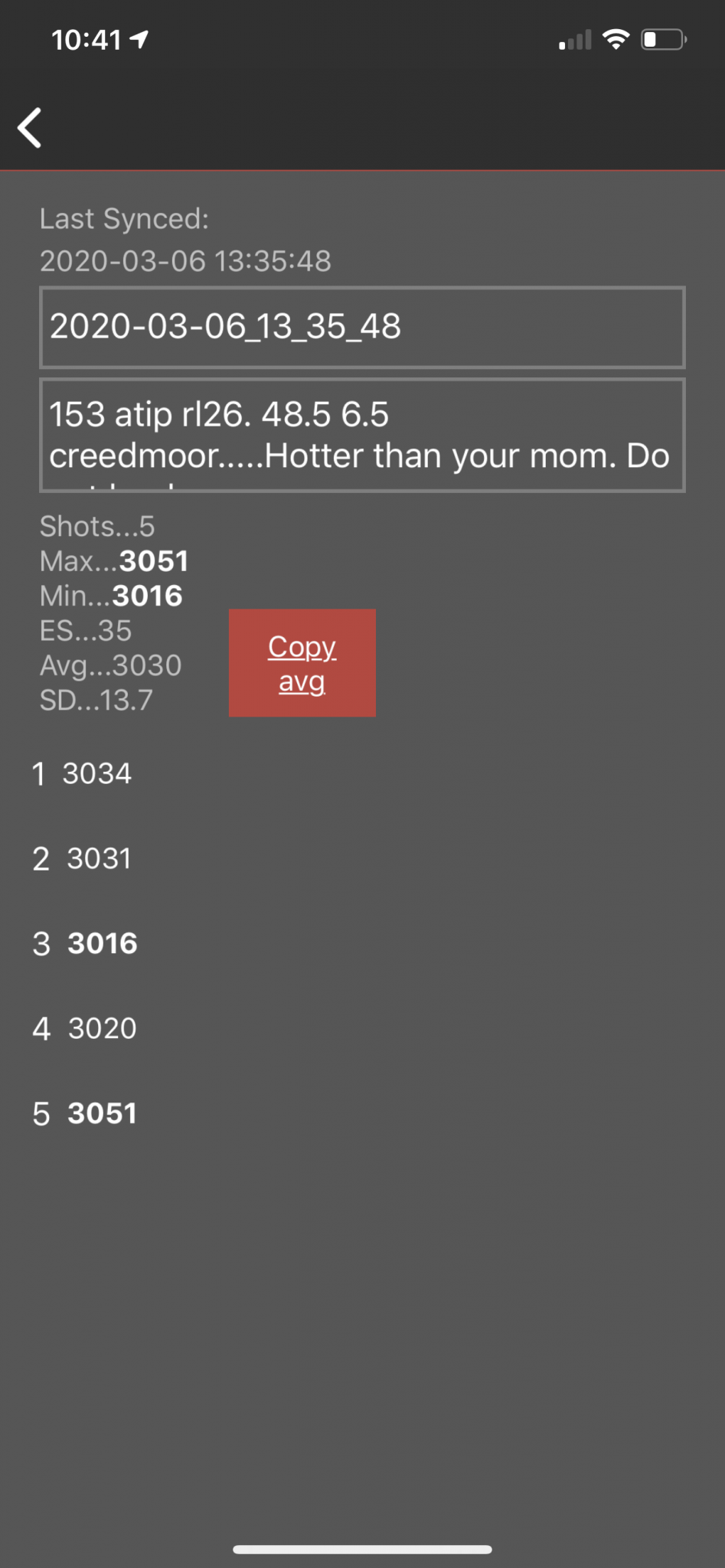

I’ve taking my 153s 6.5 cm with Rl26 up to 3050 FPS (way over pressure but wanted to test the limits) in my 1:75 twist barrel and didn’t have any issues. But I only shot 5 at that speed.
Really? Loaded how long? 153s in a CM at 3050 FPS? I’d love to see that, at a safe distance.
