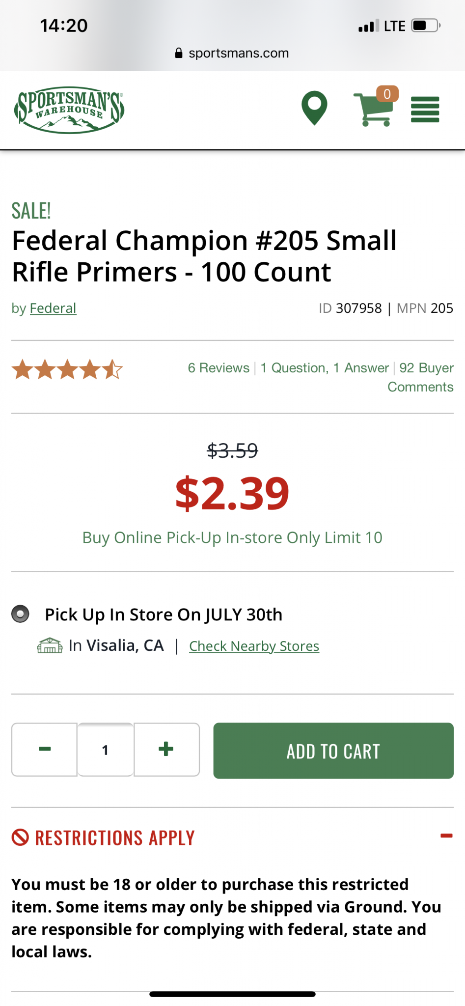

I’ve been consistently able to get 210-215’s at sportsman’s warehouse ordering online.
Order online but pick up in store. No Shipping. Closest one is 4.5 hour drive away. Shitty.
