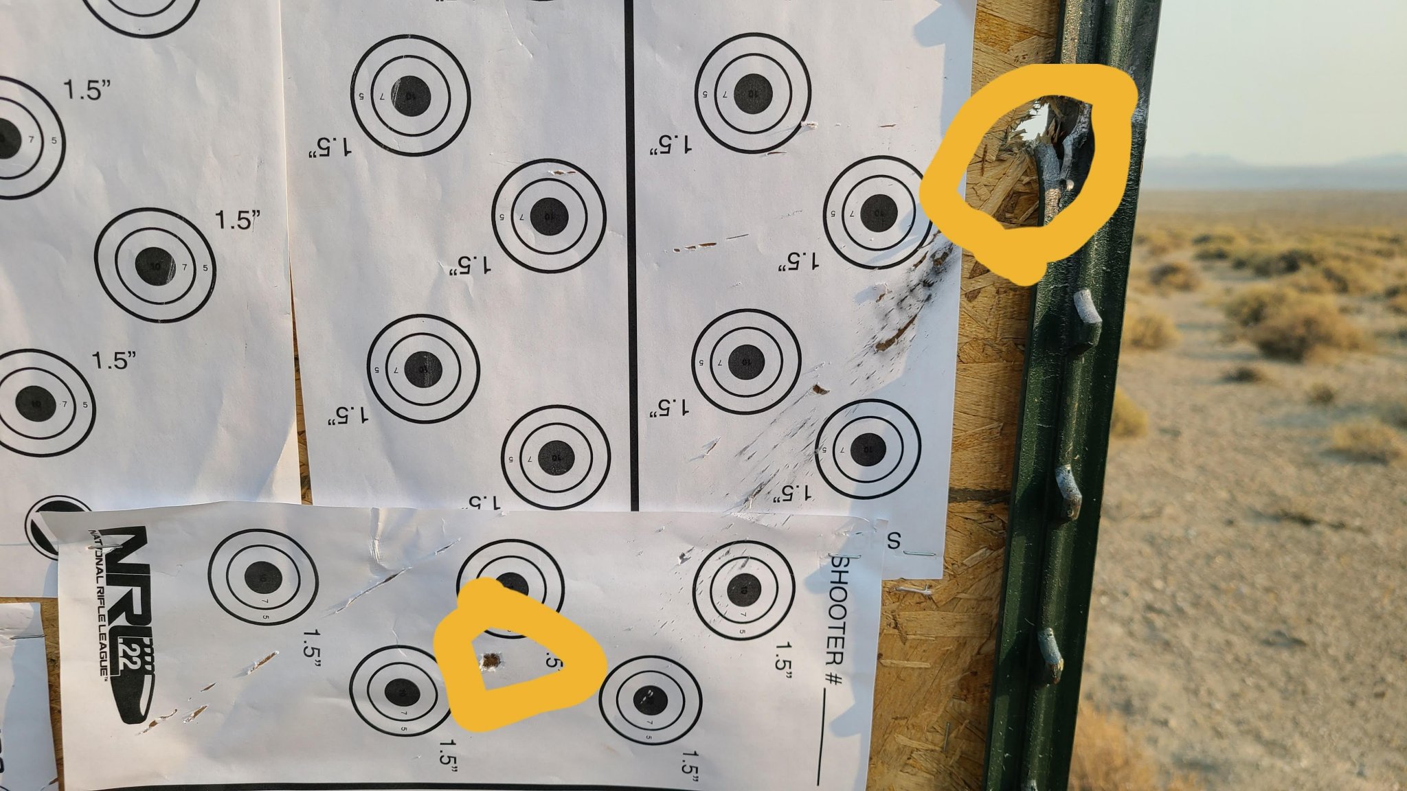

Range Report Hornady 147 ELDM blowing up

I have followed it from the beginning because the title caught my attention. The 147g ELD's are my go to projectiles. I have shot close to 500 of them alone this year, both in factory ammo which is 2690 fps and in reloads pushing mid-2800 fps with no issues, like many others that have also commented on this thread with no issues. I can't apologize for not having failures and neither can others only to say, too bad, so sad you're having them. Just because 2 or 300 hundred people have a blow out and are using Firestone or Goodyear tires doesn't cause them to sit up and be alarmed either. A lot of variables can cause that. Unfortunately the burden of proof often falls to the victim to prove the tire was the problem, same with Hornady probably. Not taking their side, just can't apologize for the many hundreds of people shooting them that are not having failures. If they have been alerted to the problem as you said, and they play dumb, then move on, they obviously aren't taking these claims or issues seriously and probably wont. How many here have had primers that were duds, or powder that was questionable? It can happen, but even if you have 4 or 5 primers out of a box of 1000 that fail, do you think that is going to make CCI or Federal do anything...? Maybe somebody famous like Jerry Miculek needs to do a video showing these bullets failing to get their attention. All I can say is that i've shot more than enough myself to have issues and haven't and so have many others. They work for me and others, if they don't work for you then move on for a while and try them again later. If they still don't work there are plenty of other options out there for you....

Seriously, thank you for confirming your comprehension issues, 147g are blowing up. Where inside your quote does it say, all, most, etc? Keep digging.
I'm not having issues with them, and more than a few that have posted here aren't either. People that are having issues are getting mad at people that aren't having issues. Sorry that you and others are having issues. But myself and those that aren't are just relaying our experiences with them, nothing more. So dont get mad because others aren't having problems with them like you are.

So I finally got my 6.5CM out to the range. Finished the build a few weeks ago after having the parts for a while. It's a 22" Craddock upper Bartlein @ 1/7.5 twist. Shooting the Hornady Match 147g.
So, lets start with the good news. Sight in was almost too easy. My Minox didn't even have to be adjusted to get to spot on the paper for setting a 100 yard zero at 25 yards. Then, I started shooting. First hole I was like...no way I don't need any adjustment!! Second hole...what second hole....3rd hole...well, maybe I see it. 4th hole..well, shooter error (yes, at 25 yards). Holes 1-2 were literally on top of each other with hole 3 off by 3mm!!! I was happy.
So, trying to keep round count down to break it in and then clean, I go to the 400 yard range to ring some steel. First shot...nothing. 2nd shot, hit IPSC target. 3rd shot, nothing, 4th shot nothing and I intentionally shot well below target (about now I'm like...round count dude...break in), 5th shot...nothing, 6th and last shot (nothing). I asked the two guys sitting down the way if they saw any impacts. NOPE...saw none, heard none, nothing. So, I'm concerned with 2 things: 1) I went with 1/7.5 because I wanted to shoot the 147g and even the newer stuff in the 150s. 2) I hope I'm not one of these people where 147gr are blowing apart.
Guy at the range was like...I shoot 147 all the time and never a single issue..."I've never even heard of that issue (where the hell has he been) and I don't believe it based on my experience and my dad's.
I'm going to clean the rifle up and try again on Thursday, maybe back it up to 200 yard plates or even 100 yard. Take these 147gr and some 143gr ELD-X I have.
If Hornady has this big of a problem, they're getting ready to lose a customer for life. I made sure to buy 200 almost every time I restocked other ammo. Yes, I put my eggs in one basket, I admit it. But one would think the people that brought it to market would be able to produce a bullet that works!!

In 6.5 PRCs I've seen that were blowing up 147's, they also blew up 140 Bergers, 140 ELDs, and 150 SMKs (sierras were just as bad as the 147's, 140's were less common. None has ever blown a 143 that I'm aware of.
All relatively light jacketed target bullets- except for the 143 ELD-X, which is a "hunting" bullet?

Jury still out on mine. However, I found the reason I believe. I'm not sure how walking from the 50 yard range to the 400 yard range shifted my zero other than I put it back in its case, but today at 100meter impact was about 12" high!!!!! USER ERROR!!!!!!!!!!! DOHHHHHHHHH.
That's not to say I'm not going to have problems. For now, it looks like it may be totally on me and I'll take that 8 days a week.
I'll be glad to report back when I've past the 1K mark. I'm just reporting what I have observed. At no time did I say that this was the best bullet ever made or that it defies gravity, cross winds and picks up speed on the way to the target.
This last weekend, I was able to hit a 4" X 8" steel plate at 1000 yards a few times. Heck, even my misses were darn close. I was impressed.
Now if the 111th round falls apart on me, I will report that.

Well, I'm totally puzzled at this point. Go out to range twice in 2 days. Yesterday I had a few 147 ELDM's left, shot. 100 yards and who TF knows what the hell was happening. ON paper, but....... not where aimed, then it was where pointed, then not. I'm not talking 2" here, but 12-13" spread.
Back it up to 50 yards. Now into my 140gr ELDM. Slightly better but I fold up early as it got dark and range closed.
Today, I finished the 140's and they seemed to be nowhere near where I was shooting. I switched back to 147gr and moved target to 25 yards. 1" group. Not great, but at least it's going where scope says it should go. I move it out to 50 yards. Shoot at the middle of my poster board where I drew a circle of 1" diameter. WHERE THE F is the hole? Cannot find it. Shoot again...ahhh, there it is 14" down from the drawn circle. Shoot again, 5" over the circle. I know this isn't me. Not when every other gun I can, with correct ammo (I'll discount Aguilla 55g in a 223), group at least MOA with any rifle I own barely trying - at 100 yards and no rear bag (the table setup at the range sucks for rear bag). How can I take a 308 out, zero at 25, be 1-2 mils off at 100, sight in again at 100 in < 10 shots from unknown position and I've blown 60 rounds now and have no clue where these things go when launch...just somewhere in a poster-board sized target at random. BULLSHIT.
WTF...are they really going unstable at 50 yards?????? (not keyholed though)
Tomorrow, I'm going to make the time to take one box of 143gr ELD-X out there. If they group fine, then HORNADY is getting a call. I cannot afford to go shooting what is now 2 dollar a round ammo and it group like a fucking shotgun. If 143gr sucks, then Craddock is getting a call.
I'm starting at 25 yards, moving to 50. If I can get a group of 3 at 50, then I'll take to 100. After that, I'll take to 400 and see if I can hit a 12" plate.
Sadly, I'm not sure now if it's the barrel or the bullets. F'ing nuts.
This is souring my 6.5mm CM experience - totally.
