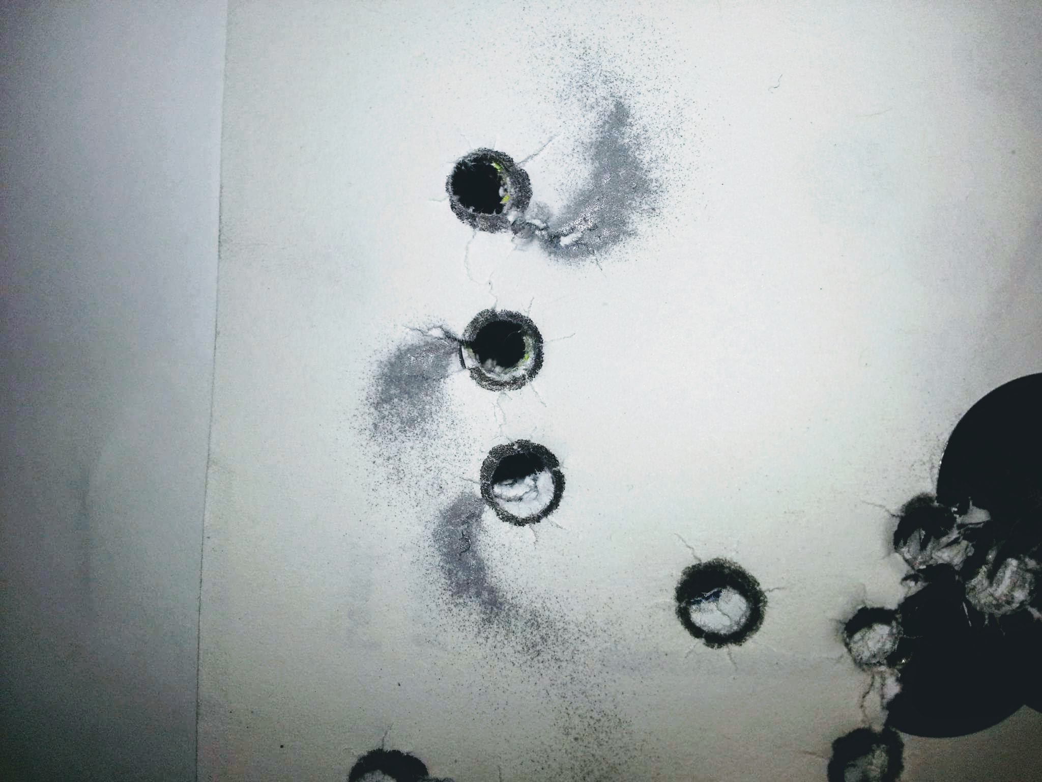

Well, I'm totally puzzled at this point. Go out to range twice in 2 days. Yesterday I had a few 147 ELDM's left, shot. 100 yards and who TF knows what the hell was happening. ON paper, but....... not where aimed, then it was where pointed, then not. I'm not talking 2" here, but 12-13" spread.
Back it up to 50 yards. Now into my 140gr ELDM. Slightly better but I fold up early as it got dark and range closed.
Today, I finished the 140's and they seemed to be nowhere near where I was shooting. I switched back to 147gr and moved target to 25 yards. 1" group. Not great, but at least it's going where scope says it should go. I move it out to 50 yards. Shoot at the middle of my poster board where I drew a circle of 1" diameter. WHERE THE F is the hole? Cannot find it. Shoot again...ahhh, there it is 14" down from the drawn circle. Shoot again, 5" over the circle. I know this isn't me. Not when every other gun I can, with correct ammo (I'll discount Aguilla 55g in a 223), group at least MOA with any rifle I own barely trying - at 100 yards and no rear bag (the table setup at the range sucks for rear bag). How can I take a 308 out, zero at 25, be 1-2 mils off at 100, sight in again at 100 in < 10 shots from unknown position and I've blown 60 rounds now and have no clue where these things go when launch...just somewhere in a poster-board sized target at random. BULLSHIT.
WTF...are they really going unstable at 50 yards?????? (not keyholed though)
Tomorrow, I'm going to make the time to take one box of 143gr ELD-X out there. If they group fine, then HORNADY is getting a call. I cannot afford to go shooting what is now 2 dollar a round ammo and it group like a fucking shotgun. If 143gr sucks, then Craddock is getting a call.
I'm starting at 25 yards, moving to 50. If I can get a group of 3 at 50, then I'll take to 100. After that, I'll take to 400 and see if I can hit a 12" plate.
Sadly, I'm not sure now if it's the barrel or the bullets. F'ing nuts.
This is souring my 6.5mm CM experience - totally.

Well now it started more often here two by at least three shooters. I for one started new batch of bullets bought last year and there seems to be a pattern of 1-2/10 simply not registering at target (shotmarker). It might have been an issue beforehand but we were shooting mostly steel so anything not making it to the steel was discounted as a shooter error/miss. What is funny is that some bullets arrive at target (800m) at wierd angle of °15 (this is something shotmarker warns you about as angles beyond 20 are not recorded). And while i was shooting guys watching alerted me that sound on the round that didn't make it to the target has a different pop kinda like muffled double pop not classic supersonic bullet crack - but due to terrain being grassy there was no visible fragmentation/splashes of bullet coming apart.
The funnier part was some of the shots fired from my rifle had a first 20m a trace behind them (see wwII fighter footage of their cannons firing and smoke traces) - not all just some shots, but they did make it to the target and within expected group at expected speed. Since i wasn't loading with flour, cocain or any other white powder and my RS60 powder is black and never left anything but a cloud of smoke it was obviously something that was on/off the bullet. Could it be vapor due to tumbling, pieces of jacket -> AOA or like fighter aircraft wing tips or leading edges while pulling Gs in humid environment? But the shots were within 1.6moa group i shot.
To note a colleagues shot that didn't make it to the target also did not register on labradar...
PS: After checking angle was due to sensor orientation (poor) of one of the frames other frame was ok.
The Lead,
The bullet blows up then the jacket hits the ground,
We had them blowing up close in too, we filmed it, was on FB with that video, it's in Slo-Mo too, you can see it cavitate and break apart

I sent a 147 through a 100 yard target sideways out of my creedmoor. It was running 2750-2800.
Thats crazy .. and still seems like it's been an on-going issue for a while. I have mostly Berger 140s and Scenar 123 on hand for reloading but I bough a case of factory 143 ELD-X for the next hunting season ... maybe should go with something else like the Fed Fusion 140 ...
Here is one,
HI Frank -in that vid it looks like the bullet fragments is what caused that splash of dirt....right?
Didn't you have another vid from lower behind the shooter that showed the bullet blowing up into a white cloud in mid-air.....or am I hallucinating again! haha
And only from a cool barrel....do you think that perhaps the bore was a bit tight when cold and damaged the jacket which would go away when the barrel warmed up and expanded a bit? Yeah, prob just speculation but wow.....this is still going on, yeah?
The times that I’ve been able to witness this were all from 6.5 Creedmoor shooting Hornady factory ammo. Two different guys, unrelated, shooting 143s with success for an hour or so and then moving to the 147s. Strangely to me, their bullets went poof much farther out than a couple hundred yards. They would get some hits and then...nothing, no splash, no indication at all that a bullet was fired unless you happened to be spotting and saw the brief poof.

Something like that on the video from my rifle but much closer to the barrel and the weirdest thing fucking lead dripping bullet made it into the group @800m must tell the rest of the guys to move all 9s to 10 or X :).
The worst part about it is, when I called the rep acted like they didn’t know anything about it. It was insulting after I’ve praised other products from them.
Offered to replace any bullets I had left but not the missing ones from the partial box...many of which exploded.

Yesterday's session with little more temperature sure did wonders for group sizes @805 meters. Basically 0 moa as when barrel heated up Hornady kept exploding. On cold barrel (920mb, 20°C 41.5gr RS60, 260rem, 72.2mmCOAL, 2850fps) ammo worked fine and i got cold bore off, another shot as a follow up, 30minutes pause and string of 12. I made it to around 6 and then disappearing bullet act started again and again (surely like 10 exploded in the row). Tried my ammo in friends rifle (same barrel - Lothar 7" twist SS, same reamer but sako receiver instead of tikka) 2 for 2 Houdini. Friends 147 performed better but one loads x47 lapua a bit slower and another 260 like 50fps lower. Big puff of smoke 30m from the barrel is all that remains of ELDM crap.
I will try again on the cold barrel and try to reduce charge to a like 40ish (2750-2800) to see if it makes any difference.
Yeah when mine were going poof I was in the desert and it was pretty hot. That night I threw a couple of boxes of ammo in the cooler, and tried again first thing in the morning, same shit within 5 rounds, poof!
