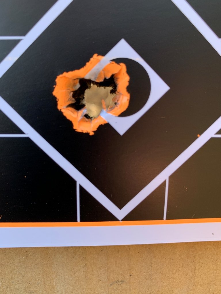

ATip, ELDm, Tac Hyb
Length 1.872, 1.740, 1.792 to 1.828
BTO (Hornady tool) 0.997, 0.937, 0.965
QL start pressure 9500, 10000, 10000. From Labradar data and peak pressures between 65 & 69 ksi. 24N41 for the ATip and ELDm. Retumbo for the Tactical Hybrid.
I agree that these bullets really are not for shooting 100 yard groups, but they seem to do it well enough. That's 5 from a 33XC.
The forecast has high winds at dawn for the next week, so it'll be a bit before I can test them at distance. I think I'll start testing at 3000 fps, which is a little faster than that group was shot at.

I tested these 300gr atips today and they were awesome, this was my first shots through the rifle so I just did a Satterlee and picked a few random loads to try.
with one of the loads out I got 7/14 shots at one mile and my saterlee load dev got me up to 2930 FPS (h1000 30 inch tube) without any pressure signs at all, but the loads I used were more like 2830 FPS
Here is my post on Instagram with some details.
Also one thing to note, they do not have the 300gr atip in the 4dof app yet, BUT using their bc calculator. It seems they are more efficient than advertised. using very accurate environmental from a kestrel and the bc calculator, it calls for 16.5 mils at one mile. But I'm getting there with 14.5 mils!
