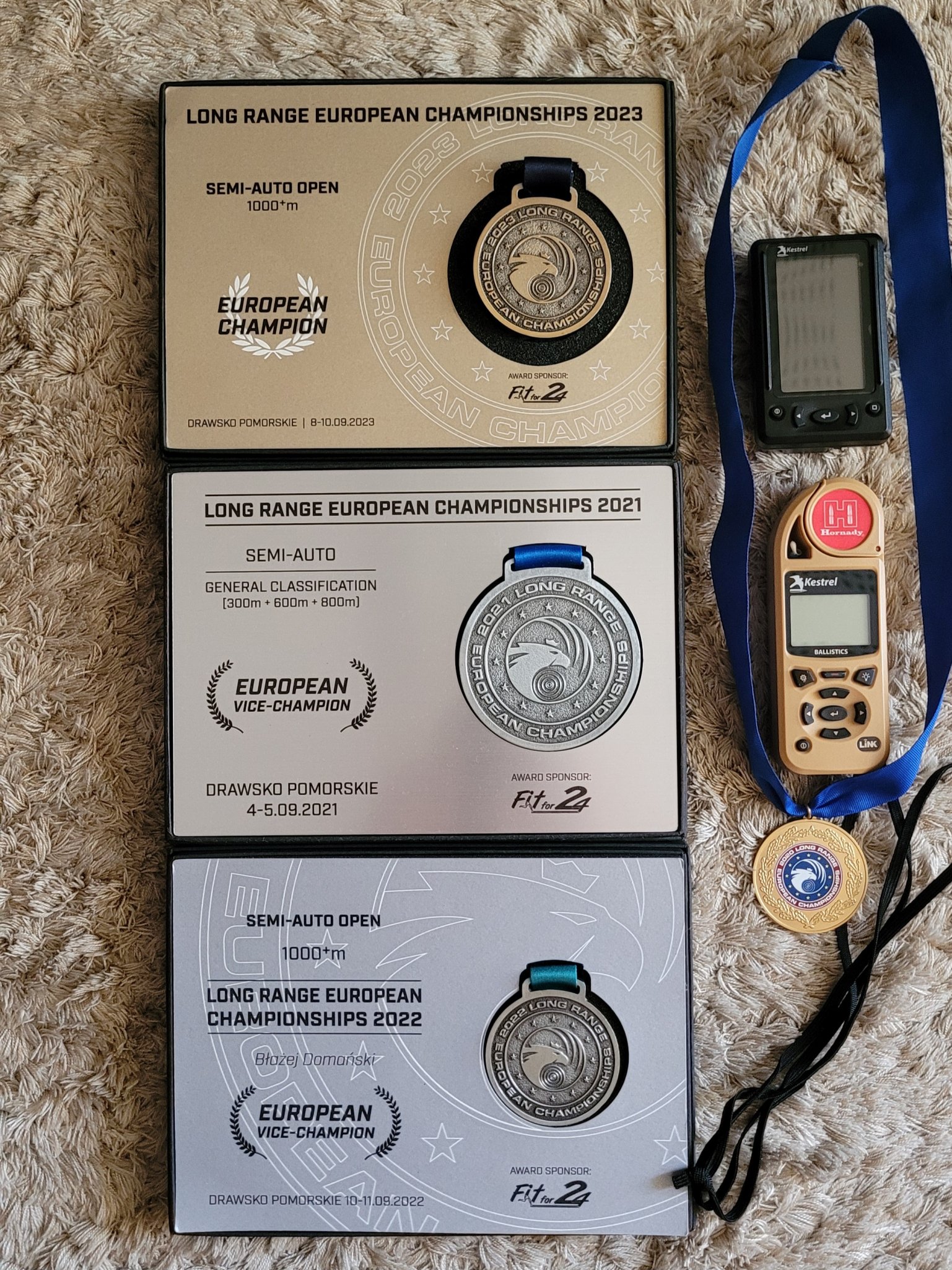

Recently I've start to use Kestrel 4DOF with Kestrel HUD. Problem is that max stable connection beetween this two unit is about 3 meters... any solution? Please Help!!! Firmware is up to date. Ive tried soft reset without any success

I have to repeat my question. Recently I've start to use Kestrel 4DOF with Kestrel HUD. Problem is that max stable connection between this two unit is about 3 meters... any solution? 3 meters at international competition is a small distance when 60 people shoot simultaneously. Please Help!!! Firmware is up to date. I've tried soft reset without any success
go here and start a tick for bluetooth connection issue
