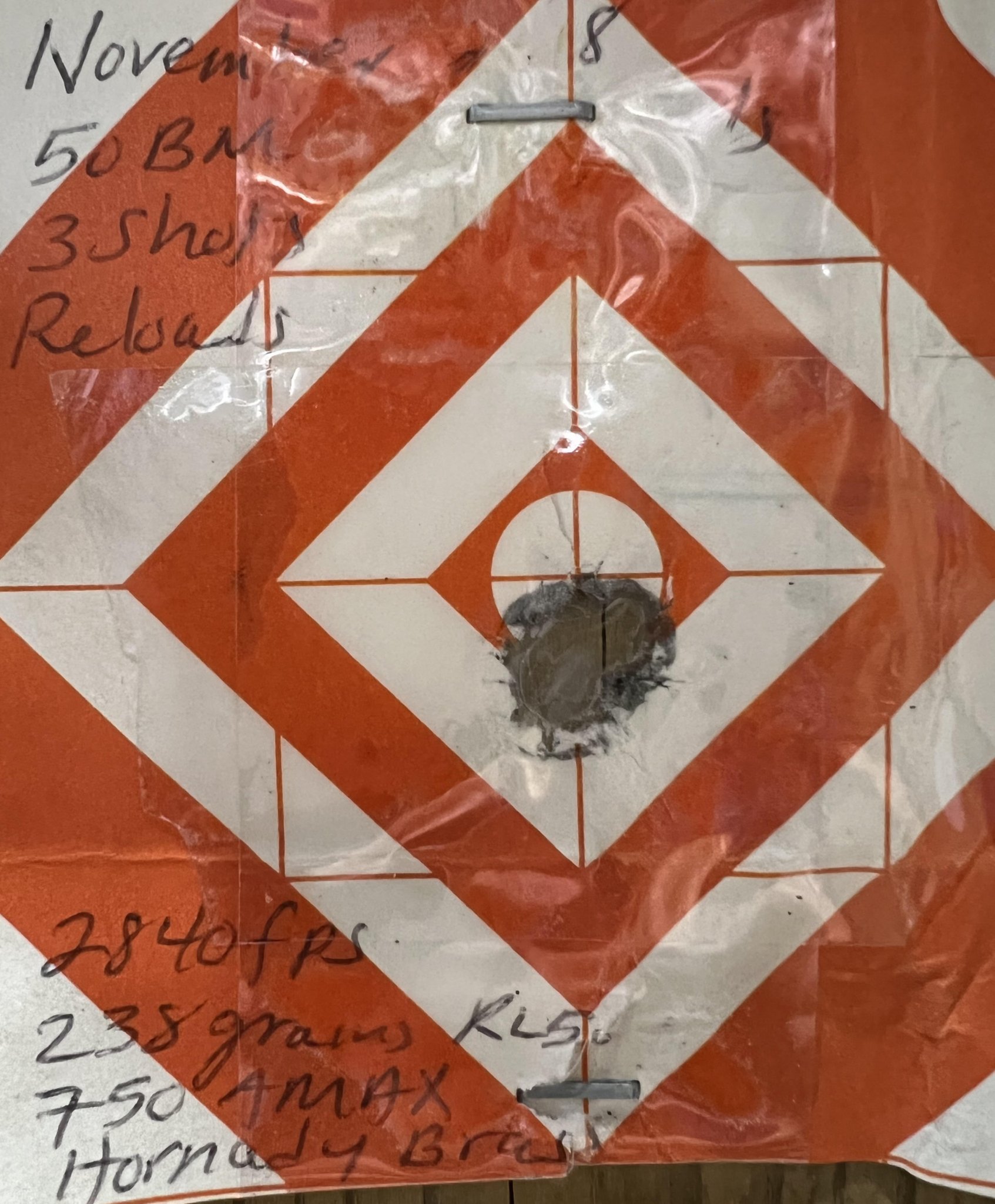

50-BMG .... eh? Of course you need to give that big-boy room to breath in the chamber. It's why real men don't wear tightie-whities.Following the conventional wisdom I learned over 30 years ago, and trying to load close to the lands has caused me more wasted time, money, ammo, and effort than perhaps any other "rule" in reloading.
Sometimes I think I just persisted long enough (like 300 rounds) that I eroded my throat and got the jump that the bullet wanted.
Even this past week, I was loading 10 thou off for 2 new barrels and wondering why accuracy and SD sucked. Old habits die hard. Gee, maybe I should push them in there 25 thou more?
My 375 CT (3 different barrels) likes .100" jump. My 50BMG with a 750 AMAX likes a 1/4" jump - that's right, 0.250". Here are the results
