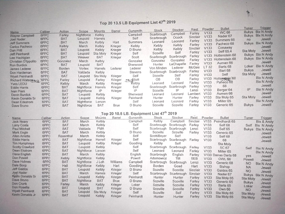

Definitely not "all" top F class and BR shooters uses tuners. At least two members on the Lapua Team don't run tuners. The world record holder for 1k yds BR didn't use a tuner....etc etc. And that's just off the top of my head.

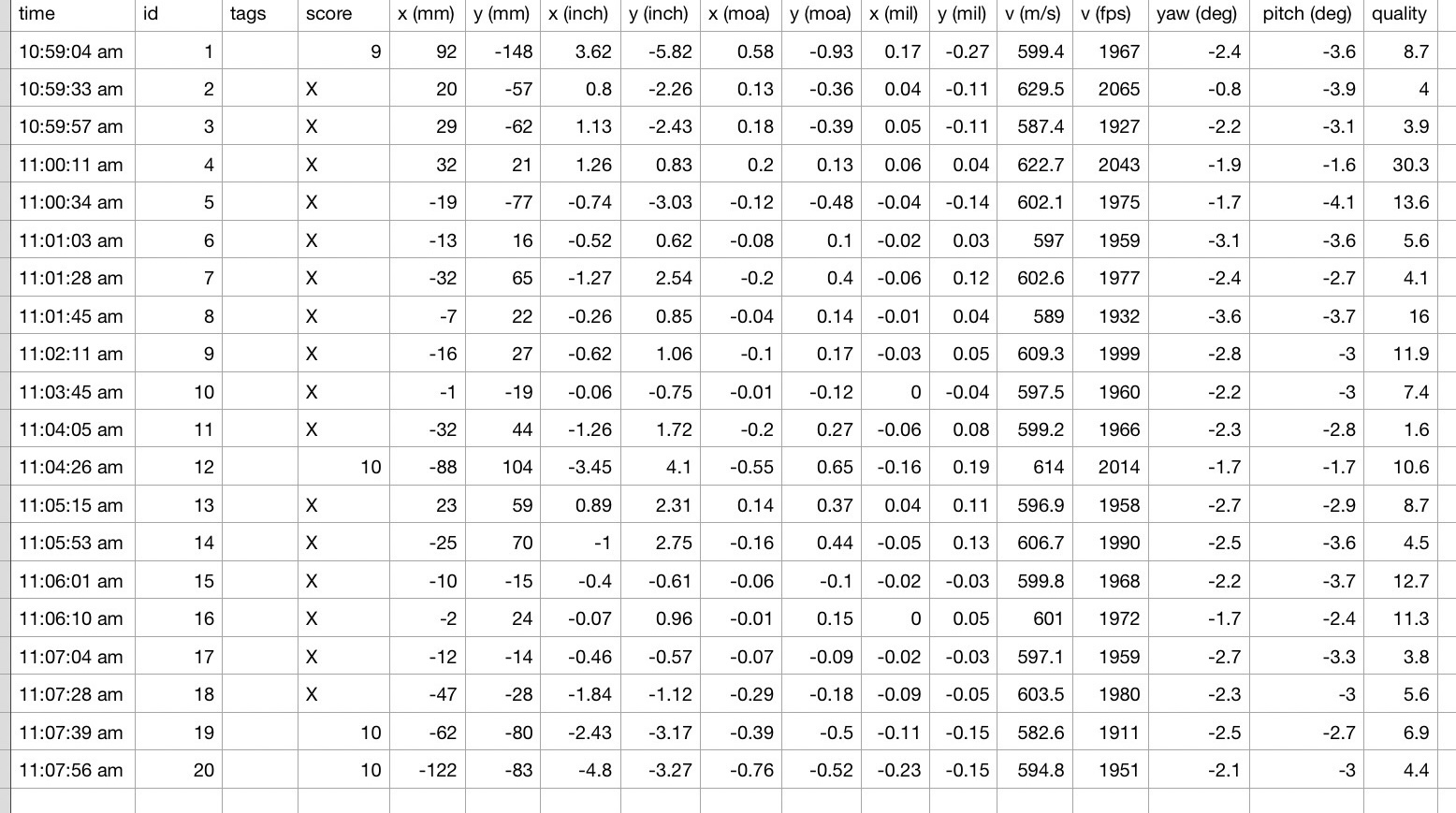

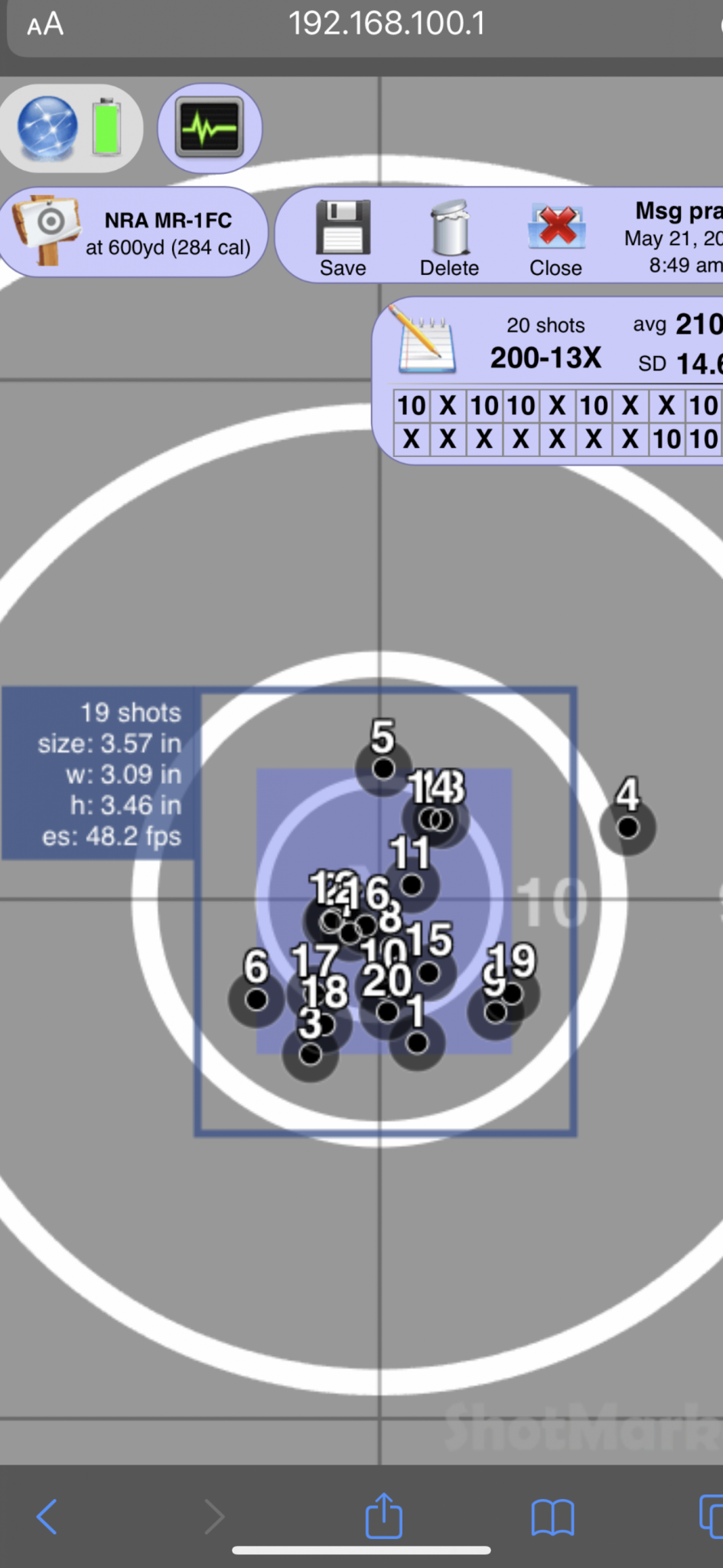

This is awesome data. Thanks for posting! I got a jupyter notebook that can give me CEP50, CEP95, and mean radius from the X/Y data from the app. (side note, it can be super tedious having to copy from the app, would be awesome if you guys had an export to excel feature or something). I prefer CEP over mean radius since its more resilient to fliers
Speaking of, first group posted. Even this group isn't really sub moa since 95% of the shots make a group larger than a moa. Tho I do need to double check the math since I had to make some quick adjustments for 200 yard calculations.
powder bullet combomean radiusRSDCEP50CEP95diameter containing 95% of shots
6mm ARC-110Honrady A-tip-28.0Varget0.3653760.1653420.3385360.7037911.40758

They’ve certainly increased in popularity over the last 5 years. This 2019 chart looks like the majority were using tuners and 3 of the top 4 in heavy gun used them.

I'm assuming the tuner wasn't responsible for that 4th shot "flier"?
Yah I can probably share it here, that will have to be done tomorrow tho
The first group was the one with sorted and "loved" cases had a total group size of 1.24" at 200yd. Mean radius .36" MV SD 8fps
The 2nd group with random grabbed stuff and thrown charges had a total group size of 1.42" at 200yd. Mean radius .36" MV SD 11fps
Both are pretty solidly sub-MOA.
