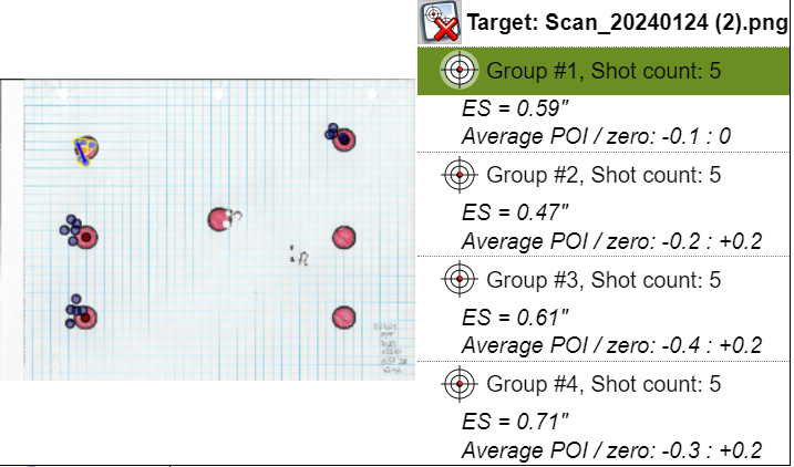

Anyone who is a talented group shooter, can you provide your data on your group sizes?
Say you shoot three shot groups, list all the three shot group sizes. Or 10 shot groups, list all your 10 shot group sizes.
Whatever you define as a group (three, five, ten, 20, etc.), specify that. Also, specify your measurement method (edge to edge, mean radius, etc.).
Groups should be for the same load, same muzzle device, same tuner setting, and same supporting equipment.
“I’ve got some really good data here.” Processes to display a dozen 3 shot groups.
*facepalm*

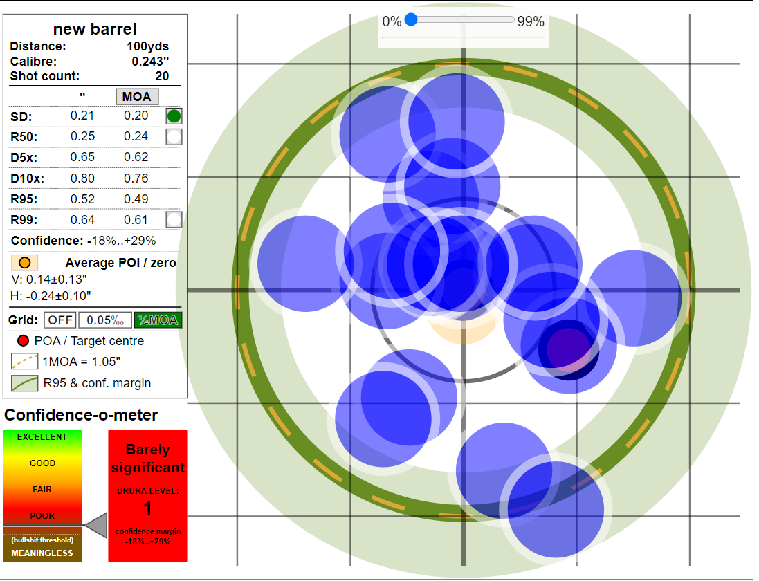

I’m working on shedding some light on why or why not it’s troublesome. I’m not a BR or F-class shooter so I don’t have any groups laying around to make some estimations.
The one point that is worth mentioning is the definition of a group size. If someone defines a competition to be of only three shots, then that’s the standard. If it’s 20 shots, then that’s the standard. Either way, we need a definition. Once we have a definition, we can collect samples.
Now, some will say, for instance, three shots isn’t enough. I would agree and if three shots is not enough, then we should have a lot of variation around the group’s center POI regardless of the group size but also in group size. There’s a variation of the group size itself and a variation where the center of the group is on target. This is the precision VS accuracy distinction irrespective of the scope’s zero. If people don’t track the variation about the group’s center POI, it would be hard to provide any evidence for or against.
I’m willing to bet a highly precise rifle is at least repeatable in its POI at low number of shots per group, but I wouldn’t maintain that assumption as precision gets worse. Since I doubt anyone has data that follows their group’s center about the POI, it’s an assumption I’m willing to accept.
“I’ve got some really good data here.” Proceeds to display a dozen 3 shot groups.
*facepalm*
Reactions: Tokay444
Eta: these are all at 200yd

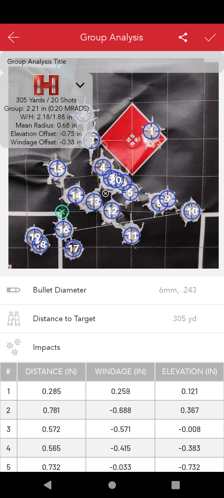

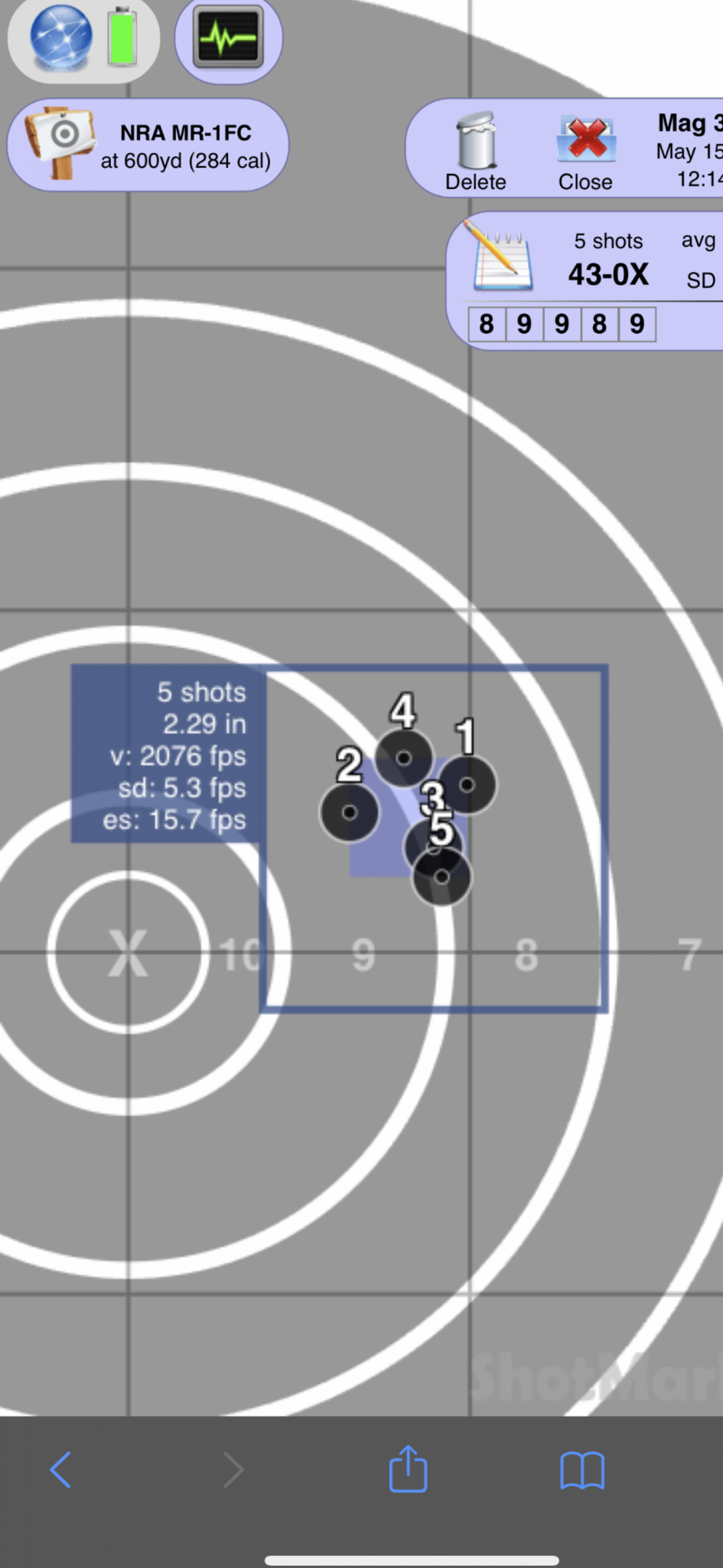

Without a shotmarker system, I haven't found a good way to get X,Y or other meaningful metrics (other than edge to edge) from a 20 round group on paper, so the overlaying 5 round groups and accepting some MPOI variation is my best compromise. If someone has a better way, I'm all ears.
You can use the Group Analysis feature on 4DoF like the one I screen shotted above, it will tell you the distance from the MPOI to the aim point in X and Y ("offsets" in the pic above), and will give you the X and Y of each shot relative to the aim point as well (the individual shot metrics that start in the bottom side of the pic).
You guys did a good job with that feature. Really saves a lot of time.
Reactions: Taylorbok
How repeatable have you found that to be vs paper?
Oehler 85 acoustic system and the Shot markers are both within about .020-.040" on an individual shot location vs. the same group shot on paper if everything is calibrated correctly. The shot marker system is probably more susceptible to errors depending on how far apart you have the mics, how rigid the frame is, etc... I'm speaking for our use of these systems. The 100yd and 200yd indoor tunnel arrays are guarded, rigidly mounted, and never messed with. The shot markers are on semi-mobile frames and exposed to heating/cooling/wind, but we've made a habit of verifying/correcting/calibrating them for each setup.
In fact if you scale the mean radius for the 4-port 30 cal at 200yd (believe it was .44-.45", I forget) to 305 it's an exact match with the Group Analysis mean radius (.68"). We see that trend repeat regularly when we do 100, 200, and 305yd testing of the same systems. The acoustic systems have been an absolute game changer for data collection. Very good tools.
In speaking with some other folks that know what they're doing, there are some optical systems that are more precise, but are also an order of magnitude more expensive. Bang for your buck we've been pretty happy with the acoustics.
I'm scanning targets into my PC and using TARAN, which does similar things. The issue is delineating individual bullet holes in a 20 round group shot at 100 yards, which is what I have conveniently available. For example, I can't pull a lot more detail from these 20 round groups, other than outside to outside.
By aggregating 5 shoters, I know it's not quite the same, but I can at least pull X,Y somewhat reliably.
Reactions: JB.IC and Ledzep

That's kind of the factory in a custom rifle through what I'd call "pretty solid" hand loading. You can get better than what I've posted, but I'd bet 80% of PRS shooters fall within the realm of these data sets. A few better a few worse.
This is awesome data. Thanks for posting! I got a jupyter notebook that can give me CEP50, CEP95, and mean radius from the X/Y data from the app. (side note, it can be super tedious having to copy from the app, would be awesome if you guys had an export to excel feature or something). I prefer CEP over mean radius since its more resilient to fliers
I don't suppose you have that notebook somewhere shareable?
As an aside... if anyone is into using R, there is a package called 'shotgroups' that can do some pretty interesting number crunching / visualization.

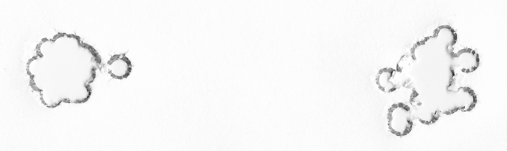

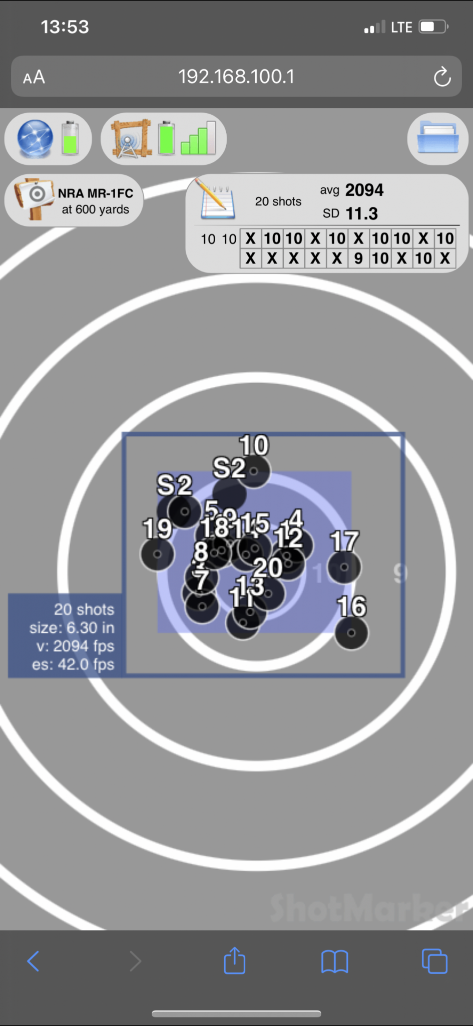

Hello again. Here’s some small groups from the tuner community. Enjoy - but I’m sure you know more than all of us and are shooting even smaller groups :)
Shooting small groups does not equal understanding the mechanism of why a tuner may or may not work. I don’t think anyone is out to say what y’all do does not work. Some just want to understand it and gain evidence that it’s repeatable under some condition.
As Jim has concluded, the act of putting extra mass at the end of a barrel can effectively shrinks groups under the right conditions. If that is true, the presence of extra mass is the assignable cause. Then a tuner’s functionality isn’t the cause. The mass of a tuner is the cause. Those two mechanisms are completely different.
Nice groups though. I’d be proud of those.
