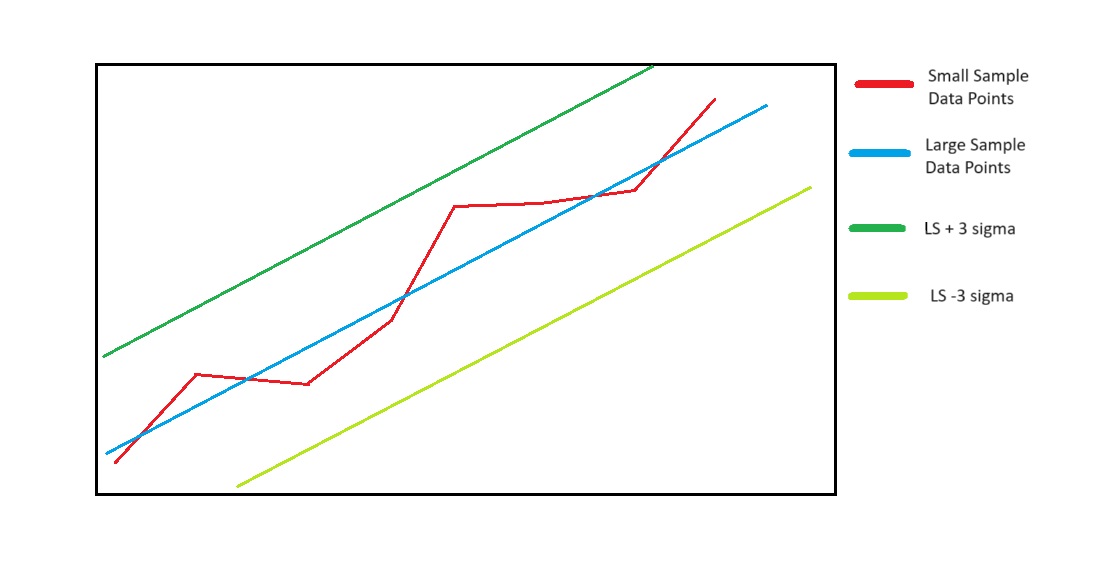

On aliasing...

On aliasing...

On aliasing...

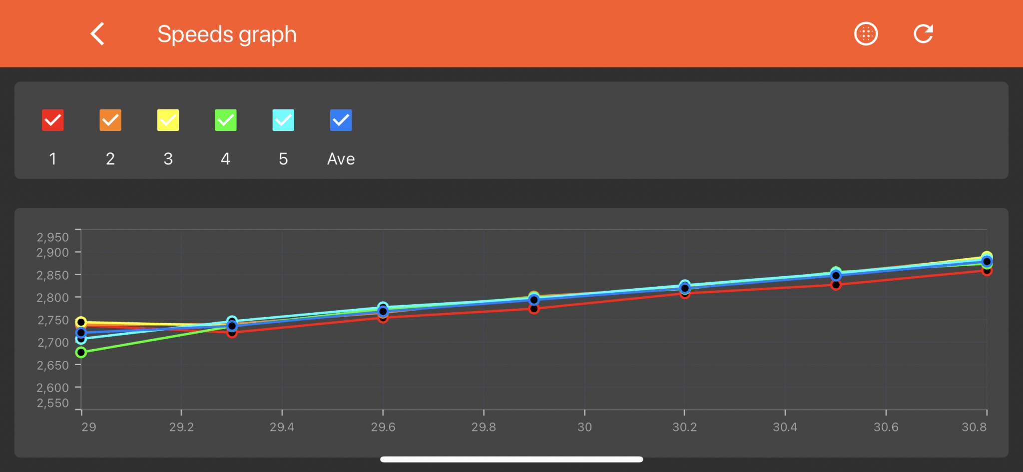

One thing I would add to my method of 2 shots with 1 grain difference on powder charge at 1000 was more to confirm tune with positive compensation. In the morning they hit level but in the afternoon they did not so a readjust was needed in a large temp swing . I kind if did something similar years ago while trying to get level velocities but what I was able to correlate was bearing surface variation and measure poi drop according to that variation . With .016 difference equaled 10 inches of vertical dispersion at 1000 yds . Did not seem to effect velocities though.

To be fair, it’s hard to capture a non-linear relationship with only a couple settings. Say someone tried only two settings and the group sizes are exactly the same, then that’s a flat line. But if you try three settings, the the first and last setting is the same result but the middle setting is either better or worse than the other two, the response is non-linear (assuming all else was equal). Now let’s pretend that many different settings produce results that are not the same. Some better, some worse.
Let’s pretend that the tuner is as sensitive as people say they are where very small adjustments have an impact. The number of combinations that would be required to test all those settings to get a statistically valid conclusion would be so damn large and expensive, it would not be worth even testing it. At worst, it wouldn’t be repeatable from one rifle to the next. So, you would have to spend all that time and money on the new rifle because your results from the last test would not apply.

So here's a fun one I did recently. I sorted through roughly 1500 6mm bullets to finally get 30x of each on the high and low end of weight variation (about a 0.5gr total spread). And if you figure my average velocity in my 6mm ARC is ~2750 and that because the KE equation is 1/2mv^2 the mass term should be pretty linear and you do KE1 = KE2 (assuming the powder charge [chemical potential energy] being the same will result in the same final KE) with the two different masses (108.7 and 109.2, for example), you should see about 7-8fps change in the average of those weight sorted extremes.
30 shot strings:
108.7- 2735.6fps
109.2- 2735.2fps
ES within 3fps, SD well within 1 fps between the two.
So big picture takeaway, the transition of chemical potential energy into KE isn't 100% efficient, and there are many factors included as to what makes the peak pressure happen, the duration of pressure, and the sum of all of it that finally results in the muzzle exit velocity of a particular shot. At least in this test, the effect of weight variation is being grossly out-weighed by some other factor(s). Unfortunately I didn't think to measure base-to-ogive on these before I shot them but I still have a bunch of the rest of them I could go through and measure to see if there's any trend there.
At some point, however, things happen that are out of our control on a scale that's not feasible to control. At some point the scale to which a tuner "must need to be" to be "in tune" slips inside of variation of the forcing function we see from P&V results and that's where my level of skepticism about the whole thing comes from.

The testing that Jayden did puts a pretty big damper on the whole "shoot 2, if they're not touching adjust the tuner...." until all 3 touch. We kind of suspected that going into it. The 3-shot strings do not correlate to the 20-50 shot strings (shocker). So maybe we aliased and skipped over the best settings, but what are the odds that we did it exactly 3-5 times per barrel to achieve pretty much the same results within the error brackets of what a 20-50 shot test will repeat to with/without/at different settings?
As someone else pointed out, to hit every setting with statistically confident results would take someone weeks of dedicated range use and several thousand rounds. To anyone saying we did it wrong, the world is just lying there waiting for you to do it better and share your results.
