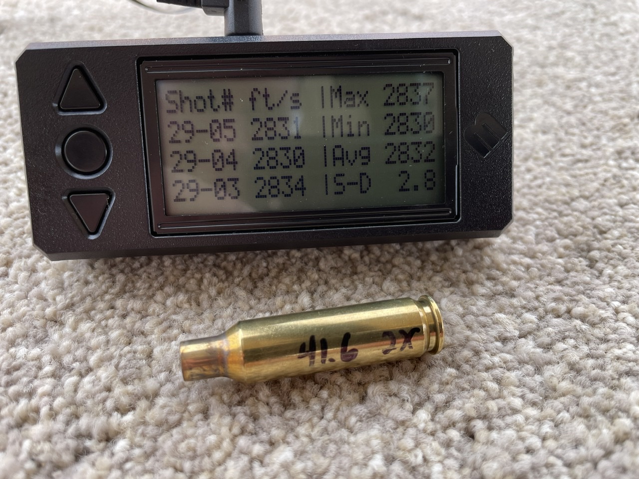

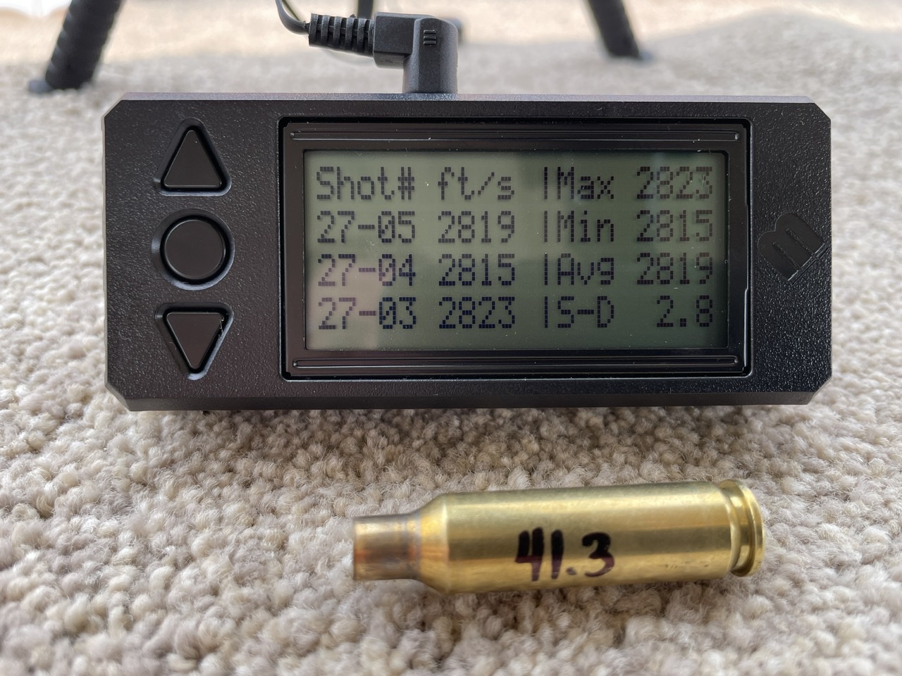

    I have not seen dramatic performance differences between brands of brass in terms of MV ES/SD or accuracy, personally. I've seen wonky results from military cases (may have been mixed lots but was all stamped the same year of production), especially eastern European steel cases, but all of the new commercial brass stuff is good with rare exception. I personally don't think the gucci stuff is worth the premium. YMMV, but I like losing Hornady or Remington cases on the range or at a match much more than Lapuas.

    If you have several hundred Hornady fired cases, process the brass including trimming then sort into 2-grain groups. Keep those groups together for the life of the brass and you will have close to Lapua results.
    You only have to do this once and the results are significant.
    Before anyone takes us down a rabbit hole, the correlation between case weight from the same manufacturer and internal capacity is over 90%.
    Good luck.
