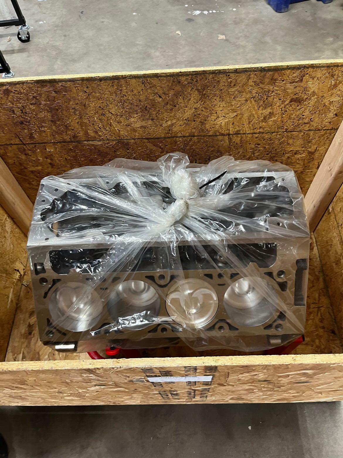

Yea the factory cranks at the power level I will be at ~300-350 are plenty capable. The bearing starving issue is why I will likely run an accusump as well as the baffle from Improved Racing. I will also likely drill the lifter buckets to let oil drain to the pan faster.
If I get a block thats clean, I will likely either dingle-ball hone it at the house or pay to get it power honed...or maybe not if the cross hatching still looks good...but at a minimum ill likely dingle ball hone it. The forged pistons from Summit are only like 600 bucks so they are relatively cheap. And again, the cast factory pistons are likely completely up to the task of my power goals... only thought on forged is for a bit more robust piston in case of detonation. Ill likely run a bit wider ring gap on whatever I run. Getting a block setup for forged pistons with a small cut and hone is likely at least 1k bucks in machine work... I would "like " to avoid that kind of expense... at that point getting a "cheap" used block goes out the window reman blocks from GM can be had for ~1500...and I dont have to waste time at the machine shop...
I have found a few decently price used sets of 821 heads... they should have hollow stem intakes at least. Titanium valves are probably well outside of my budget and purpose really. Not planning on doing anything to the heads but a light refresh with seals, MAYBE an 020 deck, and check the guides. Then throw new springs, titanium retainers and the yella terra roller rockers on them.

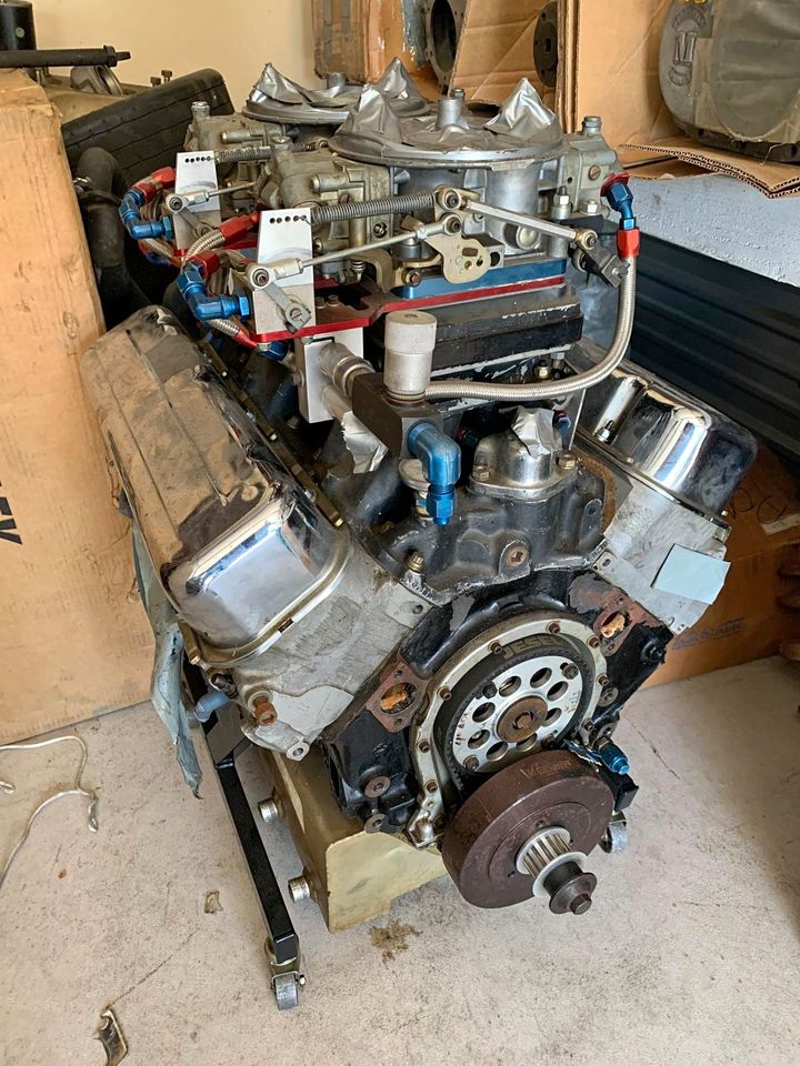

I'm just glad the damn thing started so I could get it off the trailer for its heart transplant.
Sounds more like piston slap or convertor/flywheel bolts (cracked flywheel/flexplate ?).
Usually a rod knock doesn't sound like that at idle but only when you *lightly* rev it just a tad.
Should be an easy check if you know how to be creative.
[edit]
Almost forgot.
I have seen balancers make that exact kinda noise too....that's a very easy check.

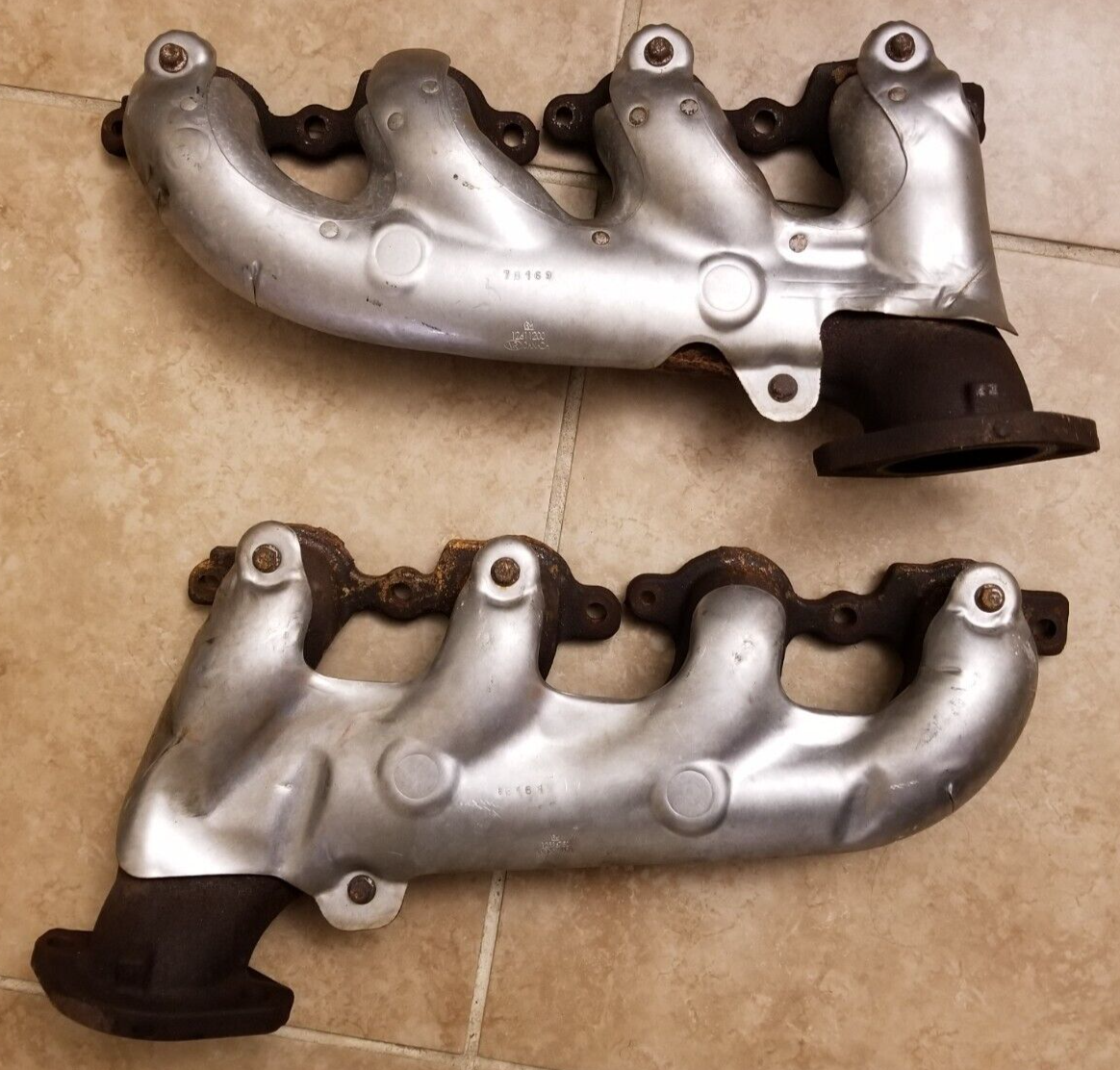

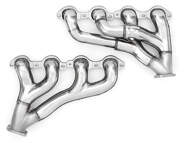

Can you fit the 2014-'15 Z28 headers? If not, then I might look at the various shorty/mid-length tubular header options for 4th-gen F-bodies or older GM swaps, since at least one of them is likely to get you an exhaust outlet in roughly the correct spot relative to cast manifolds. I haven't personally run factory cast manifolds at anything close to these revs, but I can't imagine that they are optimal.
Looks like the LS3 Camaro manifolds work and they can be bought cheap... They dont look "terrible" honestly.
If those work, will the LS7 Camaro headers also fit?
I dont think so... at least I havent found any reference.
Looks like people either use Camaro LS3, V8R headers or Sanderson supposedly makes a set of block huggers that fit.
Honestly the Camaro LS3 will flow plenty for the power I am trying to make. If this car has 300whp it will be a fucking rocket ship... Shouldnt be hard to make 400+ at the crank so like 340-350 at the wheels... Probably doing either a 3.31 or 3.55 rear...

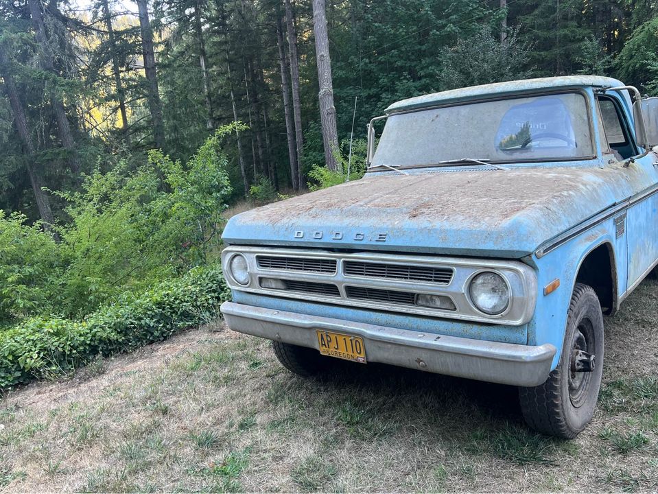

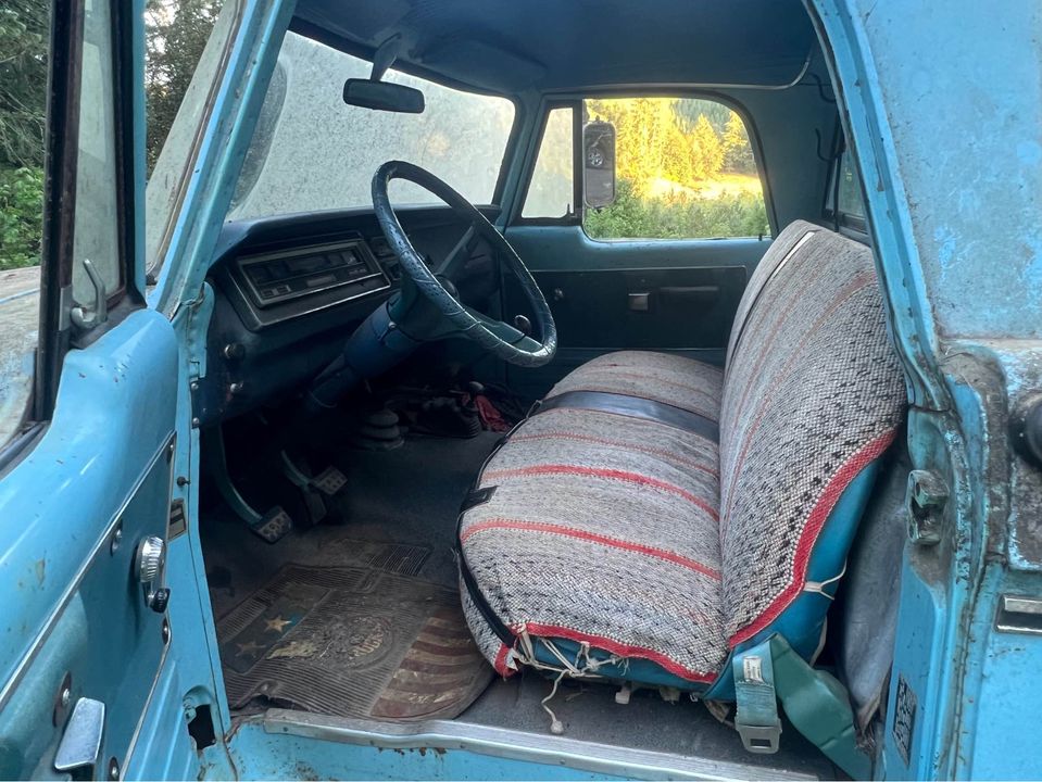

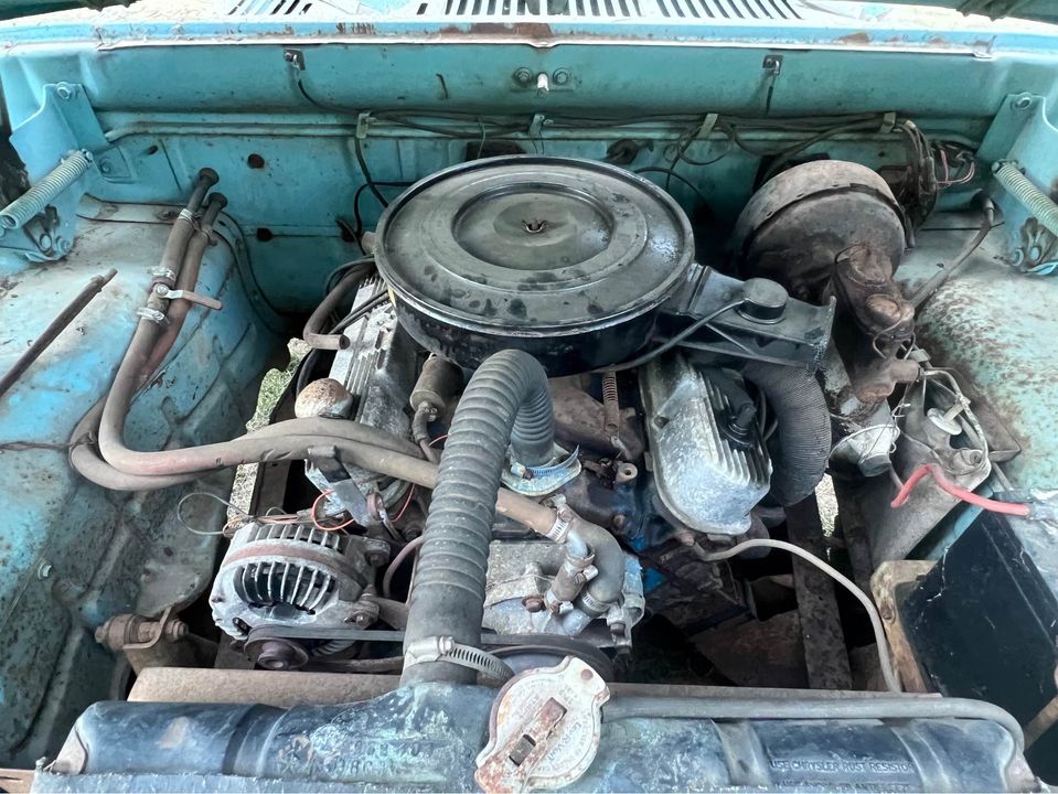

Surprisingly after 20 years of sitting in a barn it fired right up.
The thing about old Dodge pick-ups here in Oregon is that most of them went to work in the logging industry then got all used up and thrown away.
This particular unit is a one owner and as far as I can tell doesn't have but one single door ding in it.
Nor does it look like it's hauled anything in its bed.
