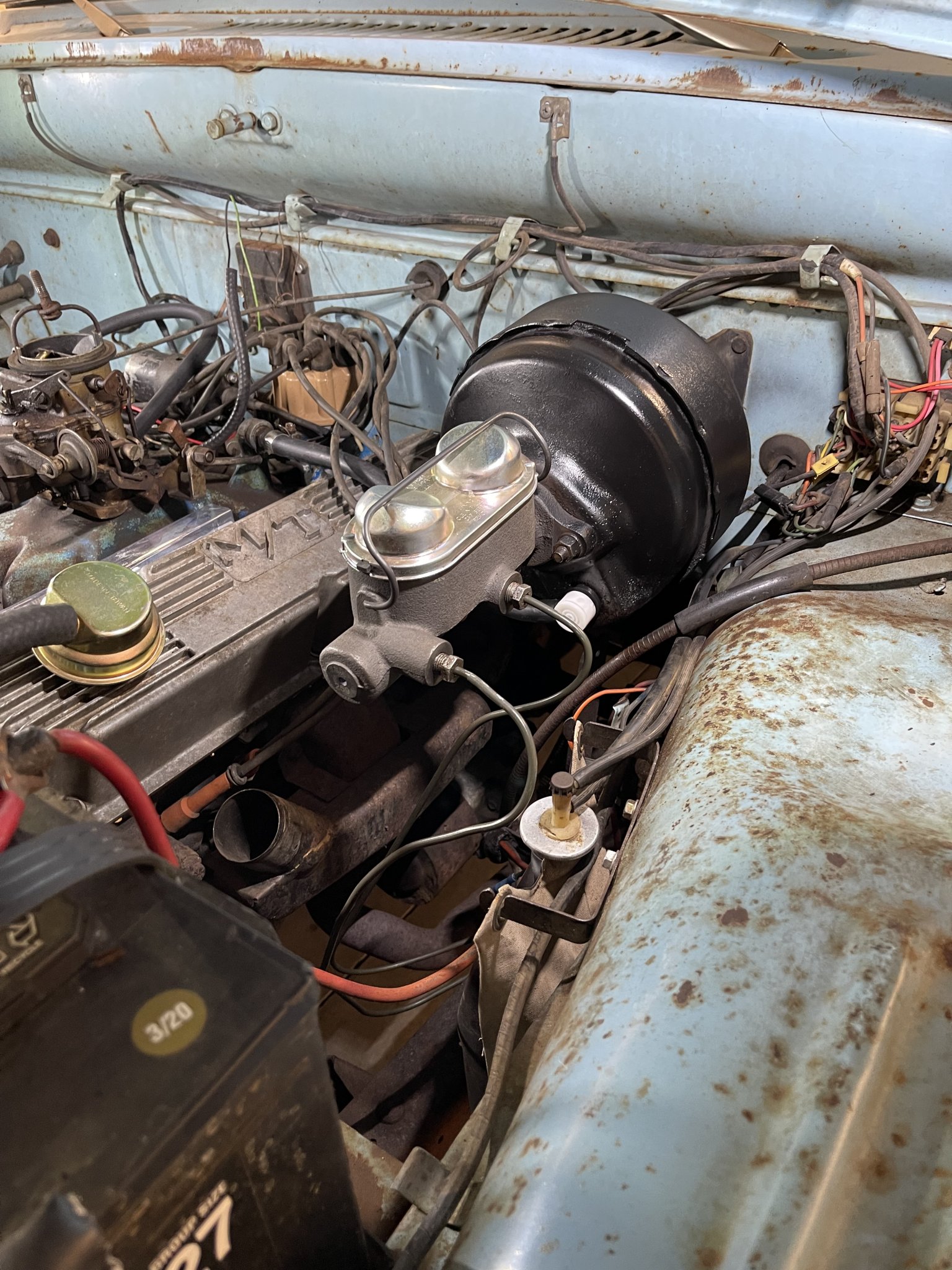

All new brakes and new scratchers.

I bet that thing rides like a Cadillac!!!
The old gal has no power steering.
Power steering was an option until I believe 1971 and then in 72 it was standard equipment.
E load rated tires pumped up to 80 psi and the 18 inch steering wheel help out on those parking lot maneuvers.
So yeah, drive slow, hang onto the steering wheel and slow down for the bump or dip.
Driving this thing makes you realize just how dangerous that old iron is to drive as compared to this modern stuff.

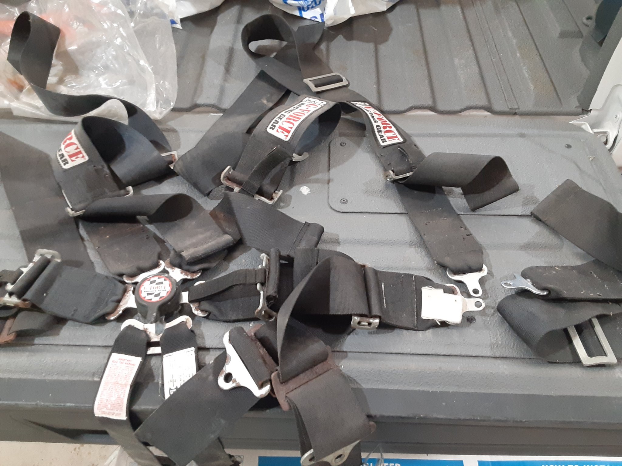

I need to chase down a set of outdated race car belts for it if anybody has a set laying around hook up brother up.

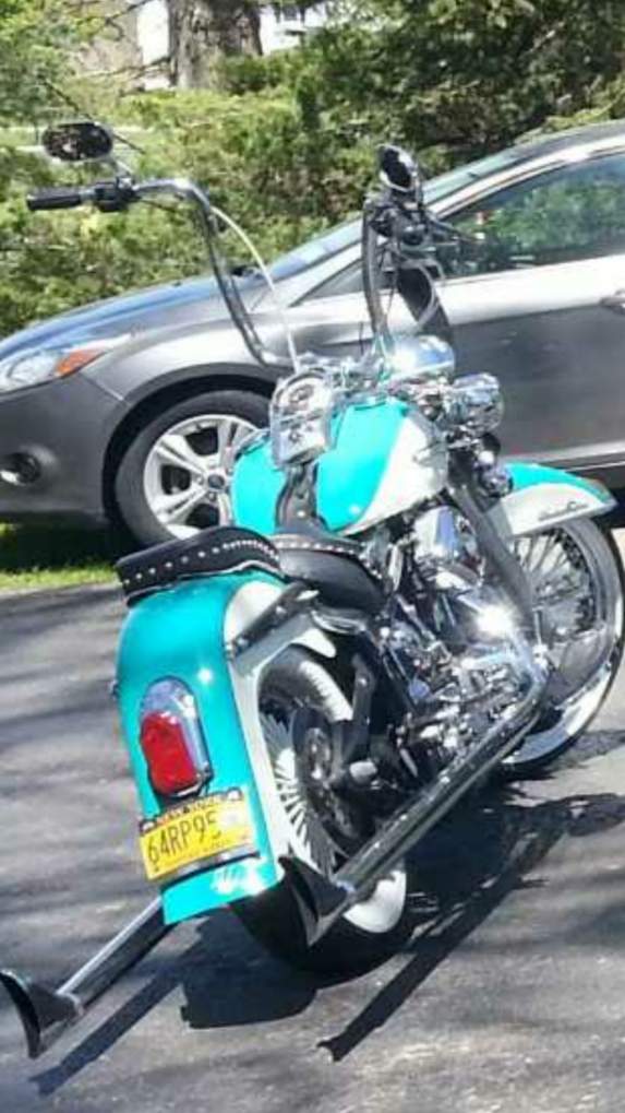

Got my new bike yesterday and this morning after adjusting the clutch we took it for a check out ride. Damn thing wouldn't start and the wife is like.. what is wrong? A few minutes and a twist of the fuel valve I responded with.. I'm a dumbass. I bet it'll do every bit of a sundial on the quarter mile strip but it sure is fun to ride.
80 cubic inches of Harley Davidson Evolution. S&S carb and an Andrews cam.
Exactly hpw mine stared out

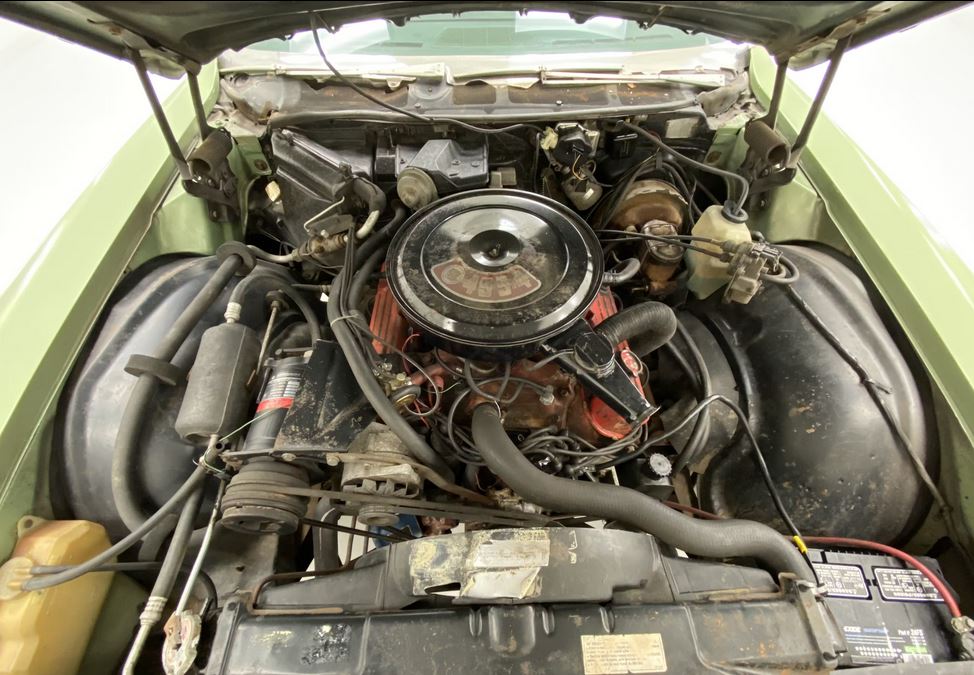

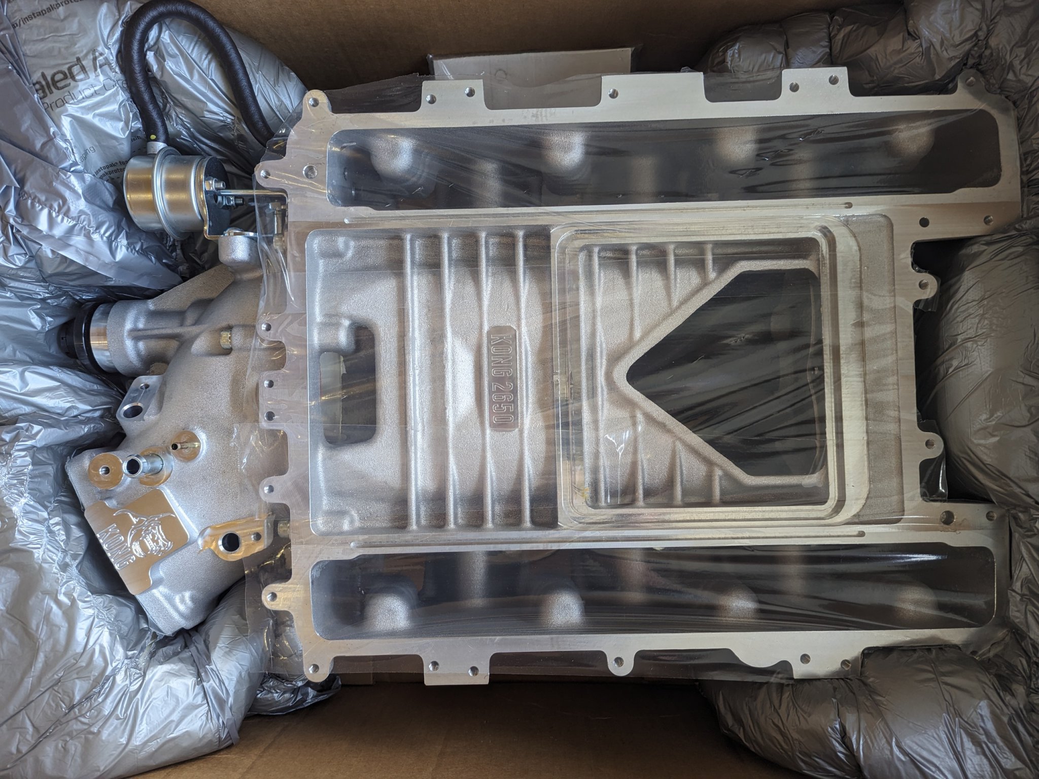

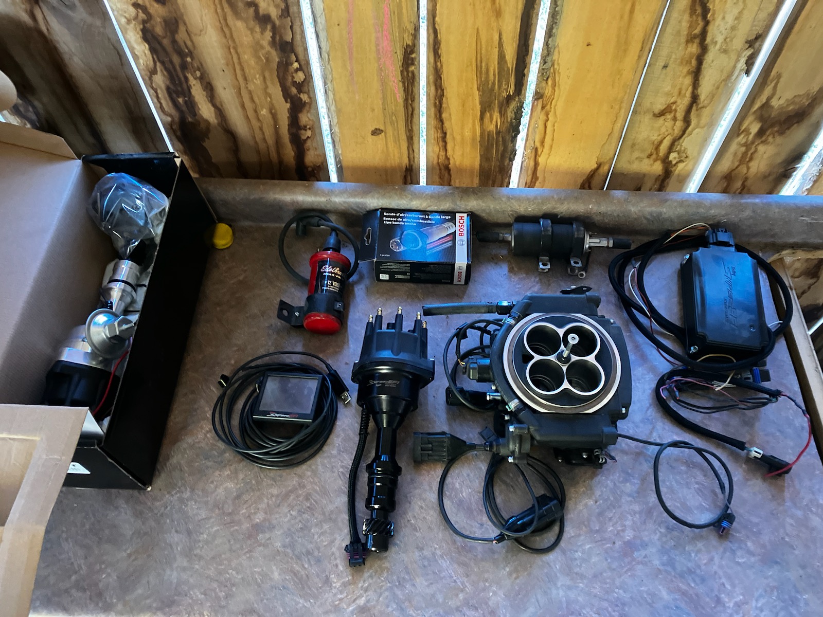

I got a deal on this whole setup for $500. Going to install it in the woman's Oldsmobile.
That’s a great deal for the money. I’ve considered FI for my ‘69 mustang but just can’t pull the trigger on a new setup. I’m seeing around $1500 minimum for new.
I always hesitate on used units that heave been pulled off something and are up for sale.
Hopefully this works out great for you, I’ve got a buddy running this on his SBC crate engine and he loves it.
I got it from a local guy that had it put on his 442 Olds. It was only on that car for a few months and not driven much. I think he thought the system was going to make his stock motor a top fuel race car. When he said that he'd take $500 for it. I opened my wallet.
$1500 plus the hyper fire integrated distributor. I also got a second distributor with it. I can sell that and recoup most of my $500.

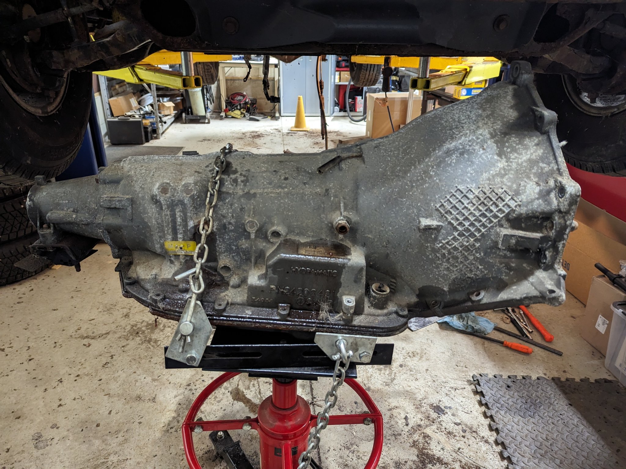

On the uglier side of things, I wrangled a 4L80E from the G2500 that I'm scrapping:
Hopefully it fits the floorpan of my '96 Impala SS better than the 6L90E that I was attempting to install. Pretty sure it'll go in with just some simple mods to the tubular crossmember I was running with the T56.
Hit me up with a DM if you decide to build that 4L80E for holding some power. I build lots of them for the local E85 + boost crowd in my AO. I can guide you through a lot of cost effective mods. Plus you will have the satisfaction of doing it yourself.
