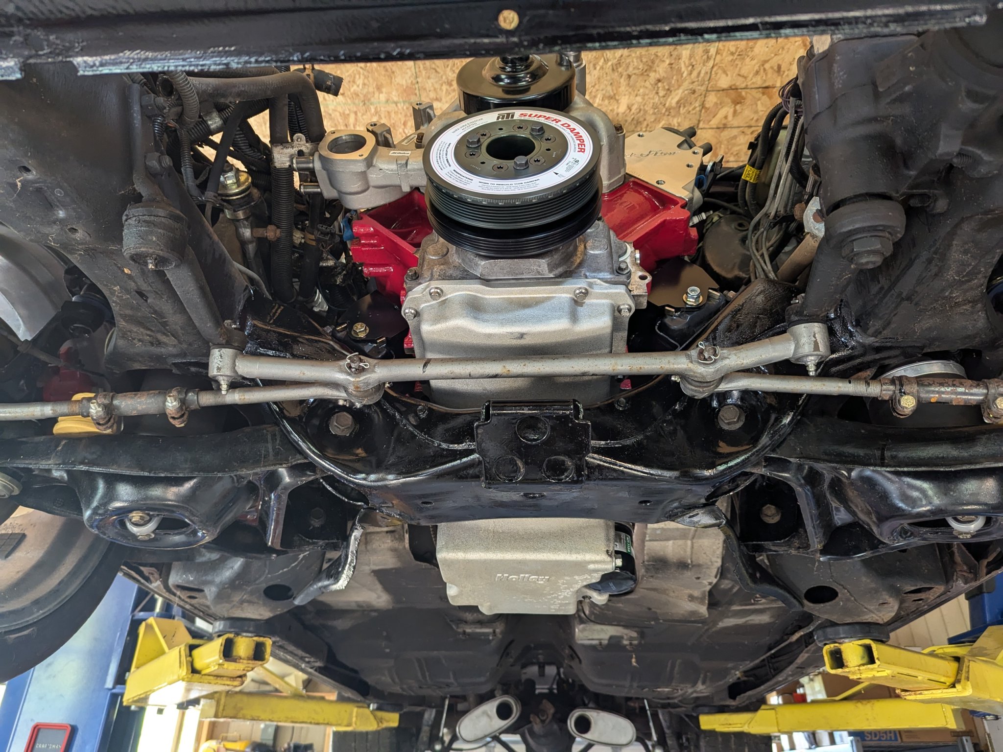

Building an aluminum Ford 8.8 IRS for my Miata.
Doing what I can to keep any case flex under control so I am putting studs in the carrier caps. ARP makes them and they are only like 35-40 bucks so just an off the shelf part.
The 8.8 stud is 3.125 in length and I was TOLD this is to short for the aluminum case as the caps are different.
I was TOLD that I needed the 9" H case studs which are 3.400 in length.
There is also the regular 9" version which is 3.250 in length.
Well this was what I ended up with with the 3.400 length stud.
Now I didnt torque the stud into the case as I wanted to be able to return them if needed, but I cant imagine I get anything more than 1/4 turn as torque on a stud is only like 10 ft. lbs. And of COURSE the battery on my caliper was dead so I need to grab a battery later. I used a micrometer to eyeball it and its at least .250 long. Nut is also not torqued onto the stud(which would make stud protrusion even worse). So I may end up 1/4 turn further in, but then when torquing simply regain that same 1/4 turn giving me essentially nothing.
Here is the rear cover I will be using(ford performance cobra 8.8)... I dont have one on hand to actually measure for clearance. Just from looking at the picture I ASSUME I have enough clearance for at least the nut sticking out past the case. The caps stick out past the case as it is.
So with these 3.400 being obviously to long. My estimate is .250 to long. Do I go down to a 3.250 stud and have .100 estimated protrusion from the nut? Or do a I go down to a 3.125 and have the stud down in the nut a little bit(estimate .025)?
The other thing i have seen people mention is there is enough hole at the bottom that you can run a bottoming tap another ~1 turns in the hole which I think would eat up ~.07 of my extra .100 length and thus give me only .030 protrusion which is almost nothing.
I can get both other lengths to try, but I would like to avoid needing to do that if I can as returning them is a pain.
You're supposed to fill the entire length of the nut with full threads, which means that you'll typically want to have 2-3 threads protruding from the nut (the first couple threads on a bolt aren't guaranteed to be full due to manufacturing). So if you've got 20 TPI threads on the stud, you're typically forced into 0.100-0.150" of protrusion if you want to follow the rules. (Note: ARP themselves do not always follow the rules.)
Tapping the case with a bottoming tap is a fine way to start. You can also face the portion of the stud that goes into the case and pick up a bit of additional insertion (don't go crazy, obviously - just take off the "cup" that typically exists at the end of a rolled thread). That might get you sufficient clearance. Beyond that, I'd personally explore some options that involve ditching the thick washer in favor of a thinner part, shortening the stud and accepting the loss of the broached hex recess but also understanding that it's unlikely to be removed ever again, and/or clearancing the cover as necessary. The older I get, the more I find myself grinding the cheapest part first.
Guy on another forum with a very similar setup says my current protrusion is fine and will clear the cover I am looking at. I still think I am going to swap to the slightly shorter stud and have about .100 protrusion.
Reactions: E. Bryant
Got the other studs that were .200 shorter... perfect as I am going to get.

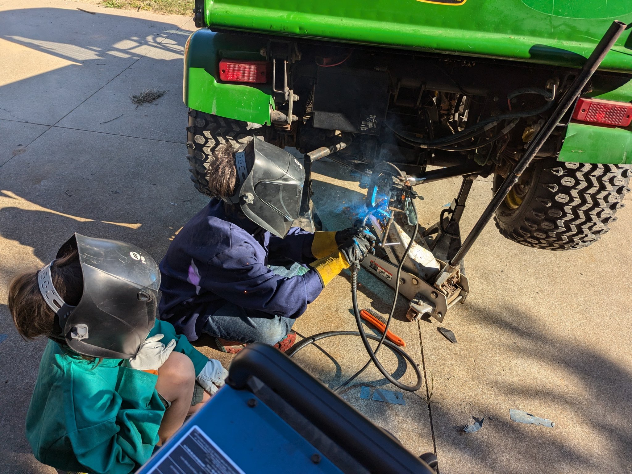

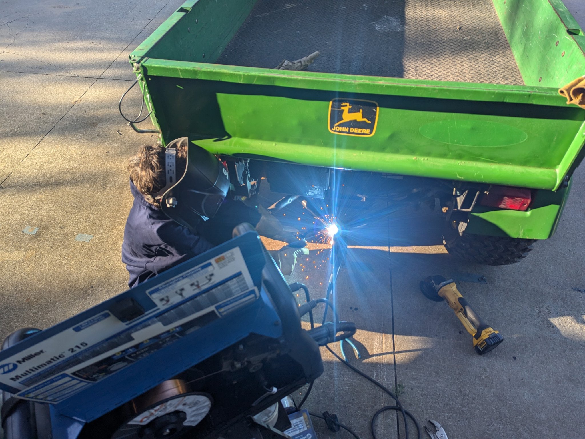

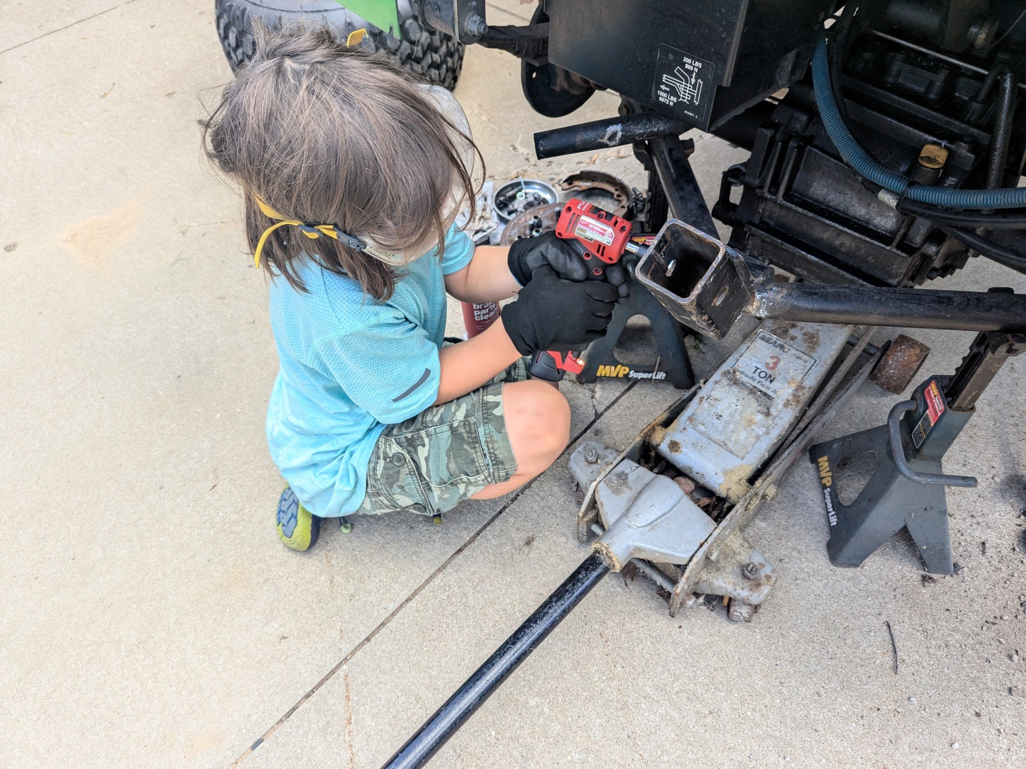

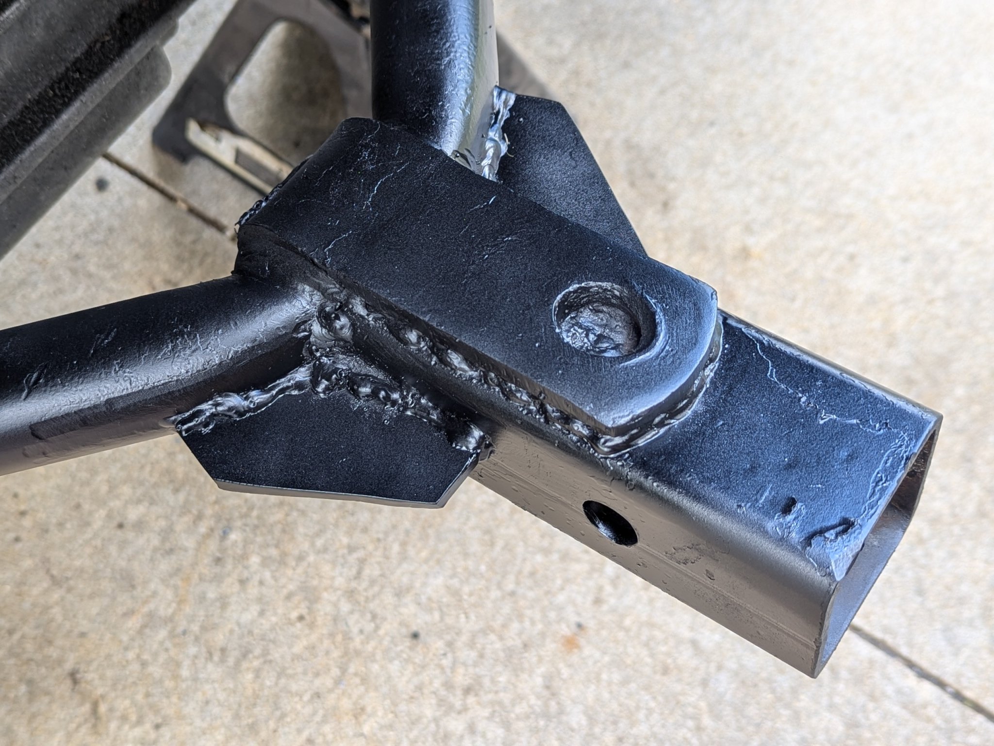

I bent and broke the hitch on our John Deere ProGator due to some inadequate fabrication by the previous owner and maybe a bit of abuse on my behalf. Fortunately, the older boy earned his Welding merit badge at camp this summer and is ready for more practice.
Yes, the younger one is wearing shorts and sandals. He's been warned several times, but has always been the learn-by-personal-experience type when it comes to these things.

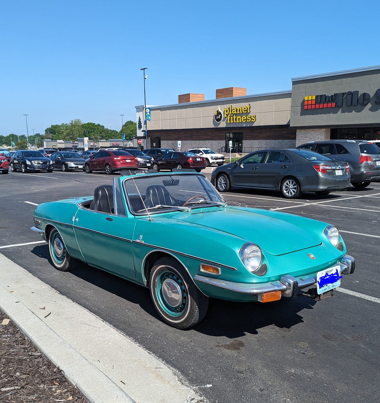

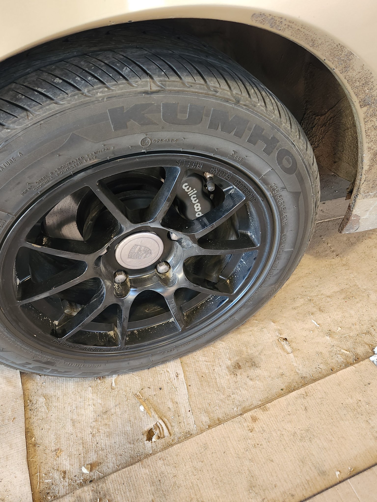

You all likely know I have a little Italian car. It really is quite fun despite being a few years younger then I am.
It is not in the best shape, but it is a fun little toy.
I have owned this thing for roughly 10 years, and I bet in that entire time I have put 100 miles on it. Now that I am retired I find myself driving it quite a bit more. If it is nice out I will take it if I need to go some where, so in the past 3 months I have done almost 300 miles.
I figured it would be a good time to really look over the car and make sure the wheels don't fall off (more on that later). When I got it I put it in the air, gave the car a good wiggle test, pushed and pulled everywhere and made sure things like tie rods, wheel bearings, it has king pins so no ball joints, but you get the point. Everything SEEMED fine.

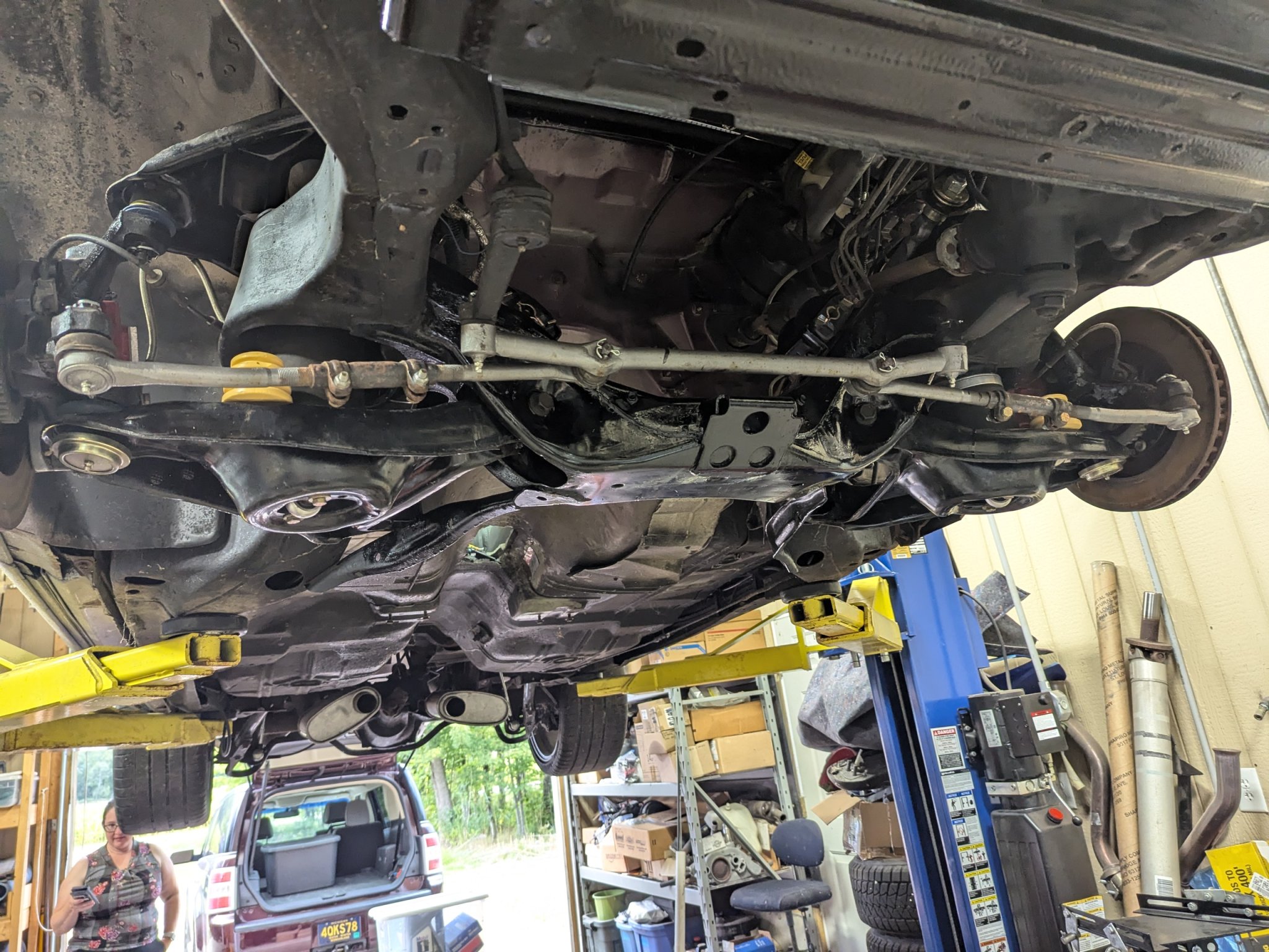

Well today I decided I should really re grease the front wheel bearings, I had never done it, and while it feels tight, parts for these things don't grow on trees, and they are expensive.
Well on the left side of the car the front spindle nuts are normal, righty tighty leftie loosie. On the right side of the car it is the other way around, like on a car with knock offs. There is also no cotter key so you give the nut a hit with a punch and that is to keep it from backing off. To get the nut off you can just muscle it off or try to hit it with a very small chisel or something, generally you just twist hard.
This was looser then hand tight.....but I could not get it off. So I ended up cutting the nut across the top of the spindle as to not muck up the threads, there is a flat spot across there for the washer. It turns out I had no need to worry about messing up the threads, they are nuked.
I know what happened someone went lefty loosie and stripped the fook out of it. These nuts are not all that tight, I can't imagine how much force this idiot put on to strip those threads.
All that said, I thought everything was ok, but it was pretty far from it. I have a feeling the brake hardware was keeping the wheel from falling off.
I am not sure how far you should dig when you get a new "old" car, it did pass the wiggle test for bad bearings.
Just figured I would pass that on.
So now darn near $300 for a new spindle, and bearings for both sides (like why the hell not at this point) and the parts should be here in a few days.
I really doubt if I had paid for a "pro" to do the PPI I doubt he would have found this. Not sure what the take-a-way is from this long story, should you do a total tear down on the car, no that is stupid, would I take the the front end this far down next time before I buy, doubt it, but after the car gets home I think I will check to make sure that everything that holds the wheels on is done correctly.
The grease was pretty hard and the bearings nice and tight, so going in was a good thing to do, now to fix what others have done before me. Oh well, at least the parts are light.

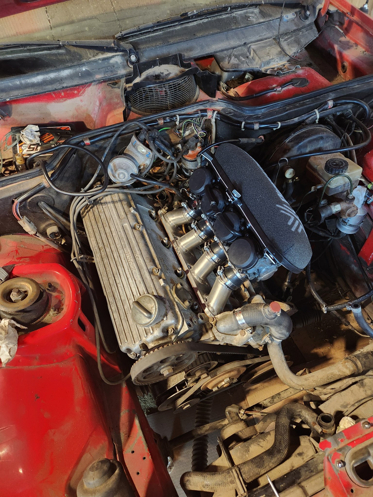

Loving the ITB life also. The sound is wild for a 4 cylinder. Video doesn't do the intake sound justice.

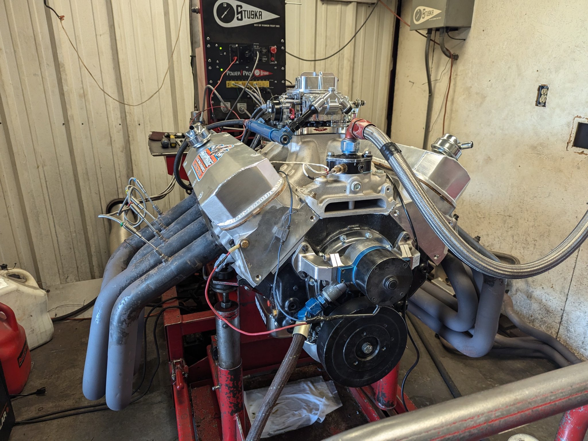

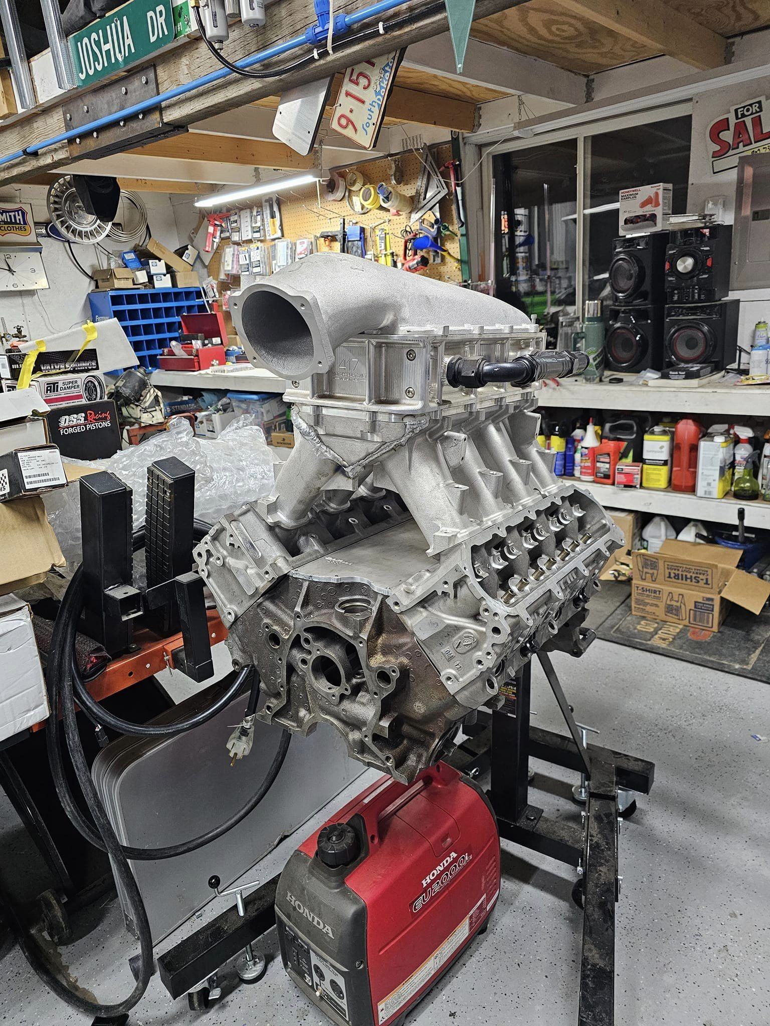

Something a friend has been working on and he tolerates me to sticking my nose in it here n there...
A Ford/GM marriage of sorts. "Ebony aaannnd Ivory. . ." Lol.
Windsor block with a pair of GM LT heads that I whittled on to fit. An earlier attempt with conventional LS heads slapped onto a junkyard short block with a "Woohan Wheezer" turbo netted near #### digit numbers on the dyno before the rods decided to leave the chat. With that one, the biggest expense was being laughed at by the cam grinder. It had to be made because LS valve orientation is backward from Ford. This new one however is easy money by comparison. LT valvetrain setup is identical to Ford so the camshaft options are wide open.
Cutting the intake in half and stitching it back together was interesting, but not a big deal. My winter project is exploring what it'll take to adapt the GM DI fuel pump to the Windsor block. We don't "need" it, but it would be stupid cool to be able to keep Direct Injection as there are some significant gains when using it. The intake has bungs as well so throwing the onion at it with a dual injector setup won't be hard at all. He went all in for this round. The heads have been worked on significanly and the bottom end is all baller stuff.
Nerds and long winters are fertile soil for dumb shit. Lol.
That lower plenum should be outfitted with a spray bar or two and fog all of the things through it
ITB? Like SCCA ITB. I ran an 1st gen MR2 in ITA in the late 90's. Then built an Opel GT for ITB, it stayed that way for one season, then has things started for its move to Fprod. Then my back went kabang. Racing days are over. I can't get out of the car without help.

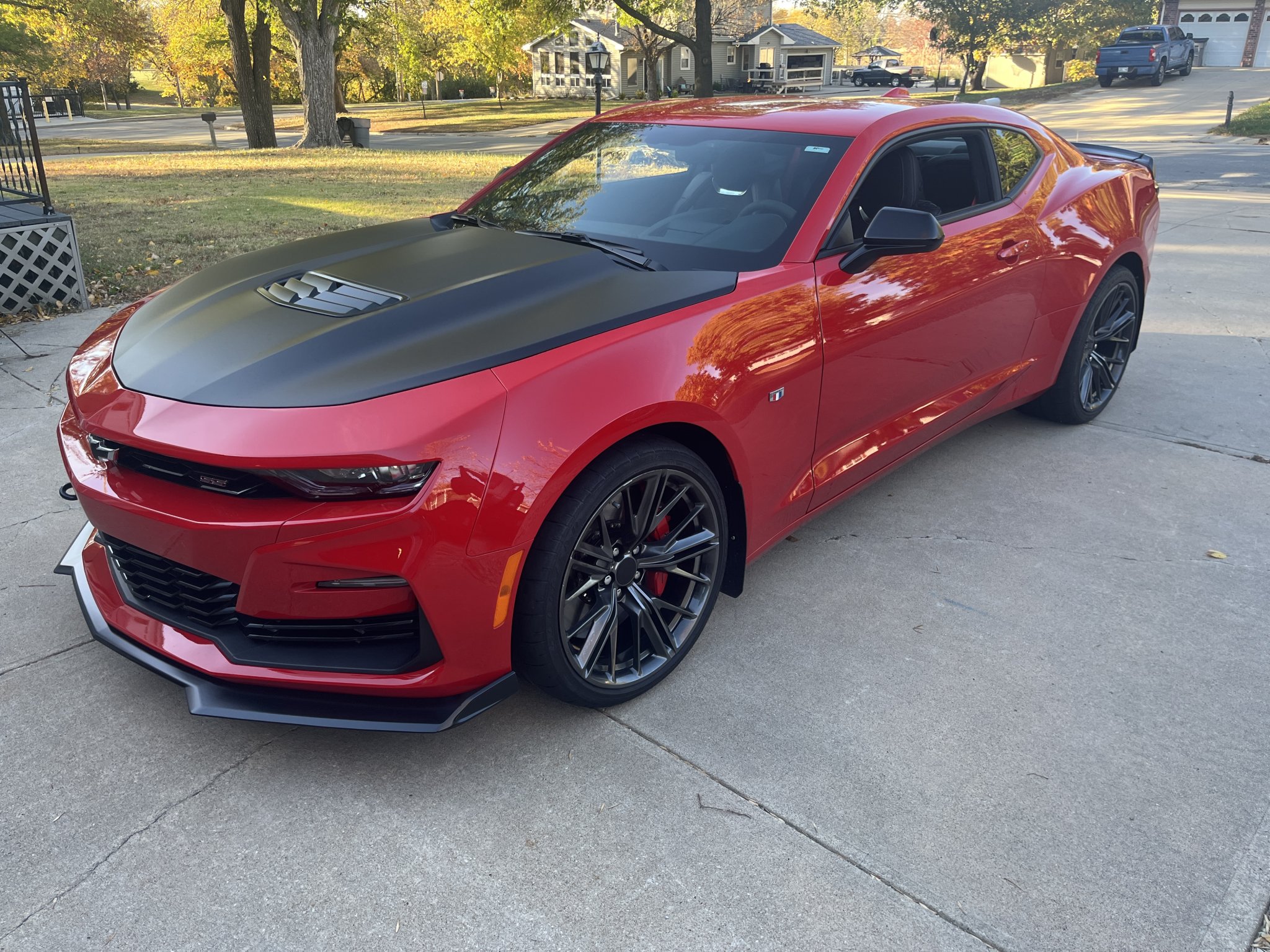

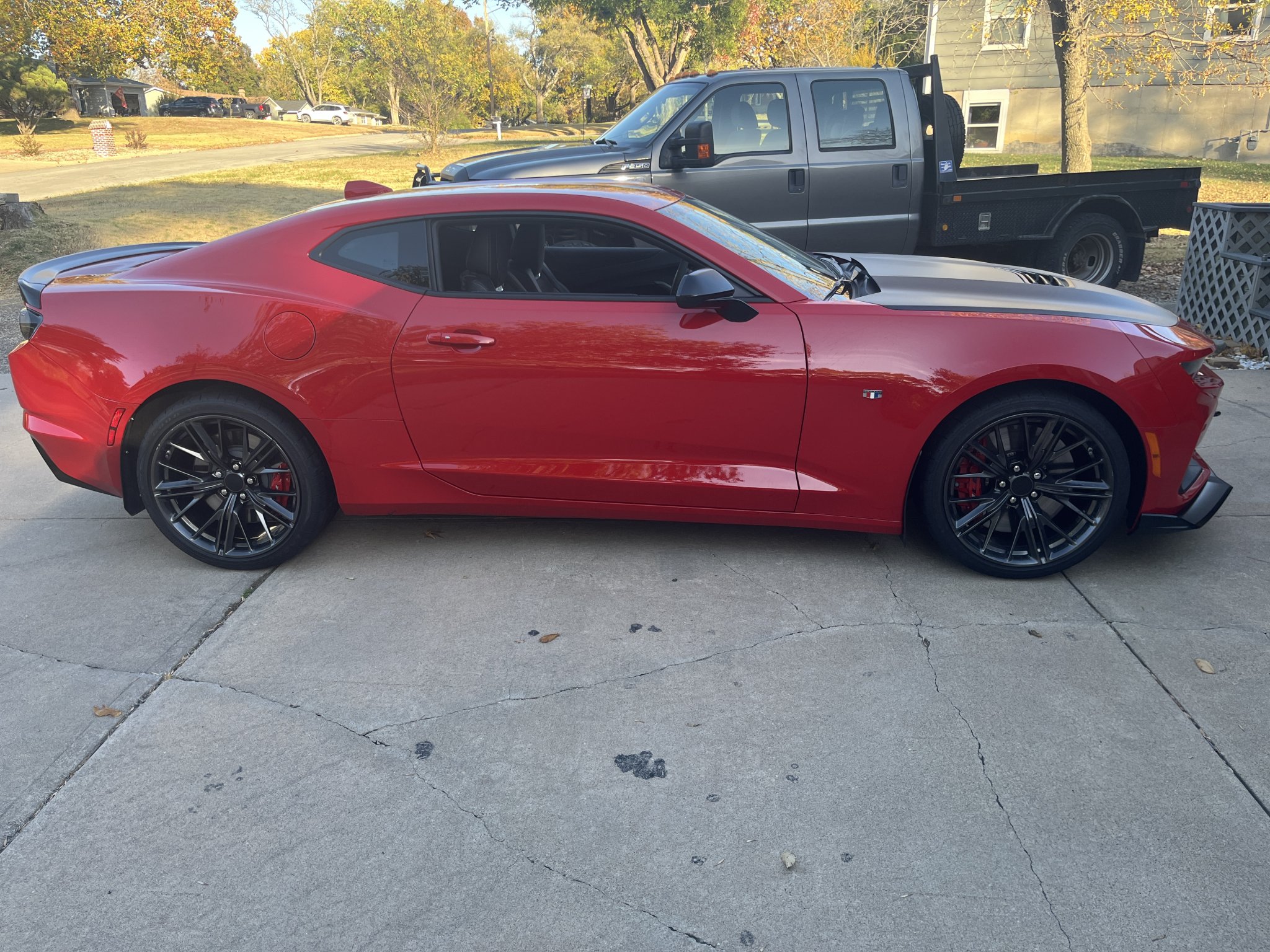

I got some ZL1 wheels with nearly new tires for cheap. I like the look of these more than the SS1LE wheels (which are awesome, in their own right). The ZL1 wheels were from an early model and have some paint chips and the clear coat isn’t great. Perfect to be my track wheels and keep the originals in better condition. When these tires are trashed, I’m planning on reconditioning the wheels.
Stock SS1LE:
Current setup:
