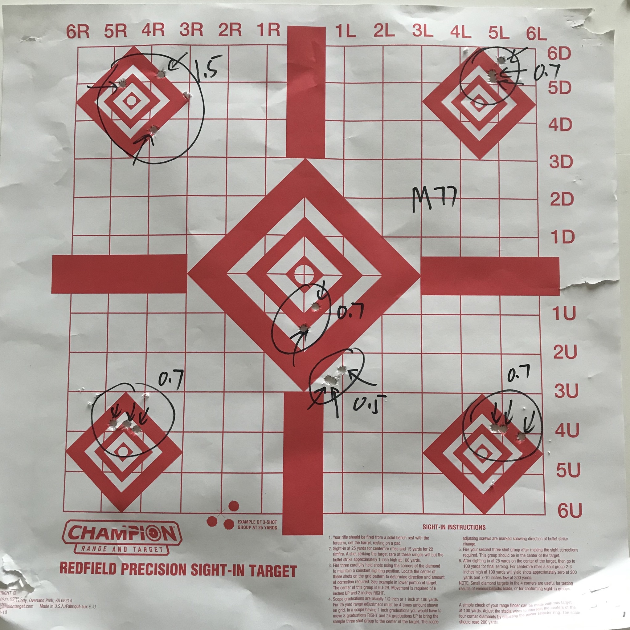

I am new for shooting. Just bought my first rifle, BCM 14.5 middy, last year. I had a NF NX8 on it.

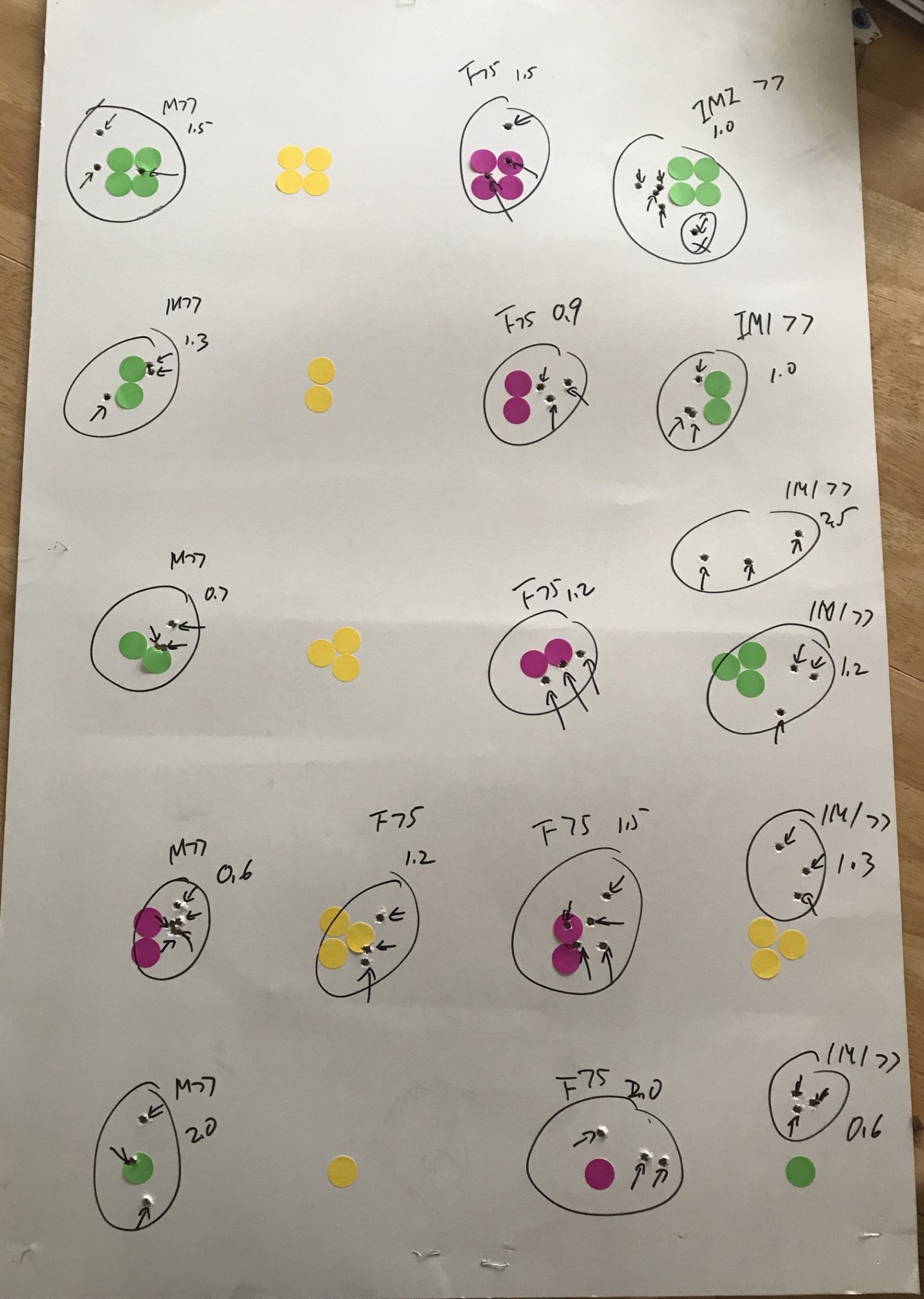

I tried several different ammo at 100 yard. As I show in first picture, I tried M77(Magtech 77gr OTM), F75(Frontier 75gr) and IMI77(IMI 77gr OTM). I was able to shoot several sub-MOA groups as I show in second picture. But my problem was there were always some groups which were very bad.
My question is how could I improve to shoot more consistently.
Thank you for any suggestion in advance.
