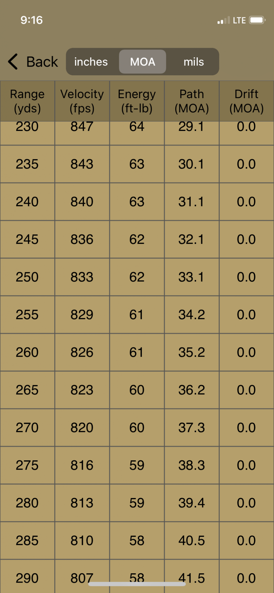

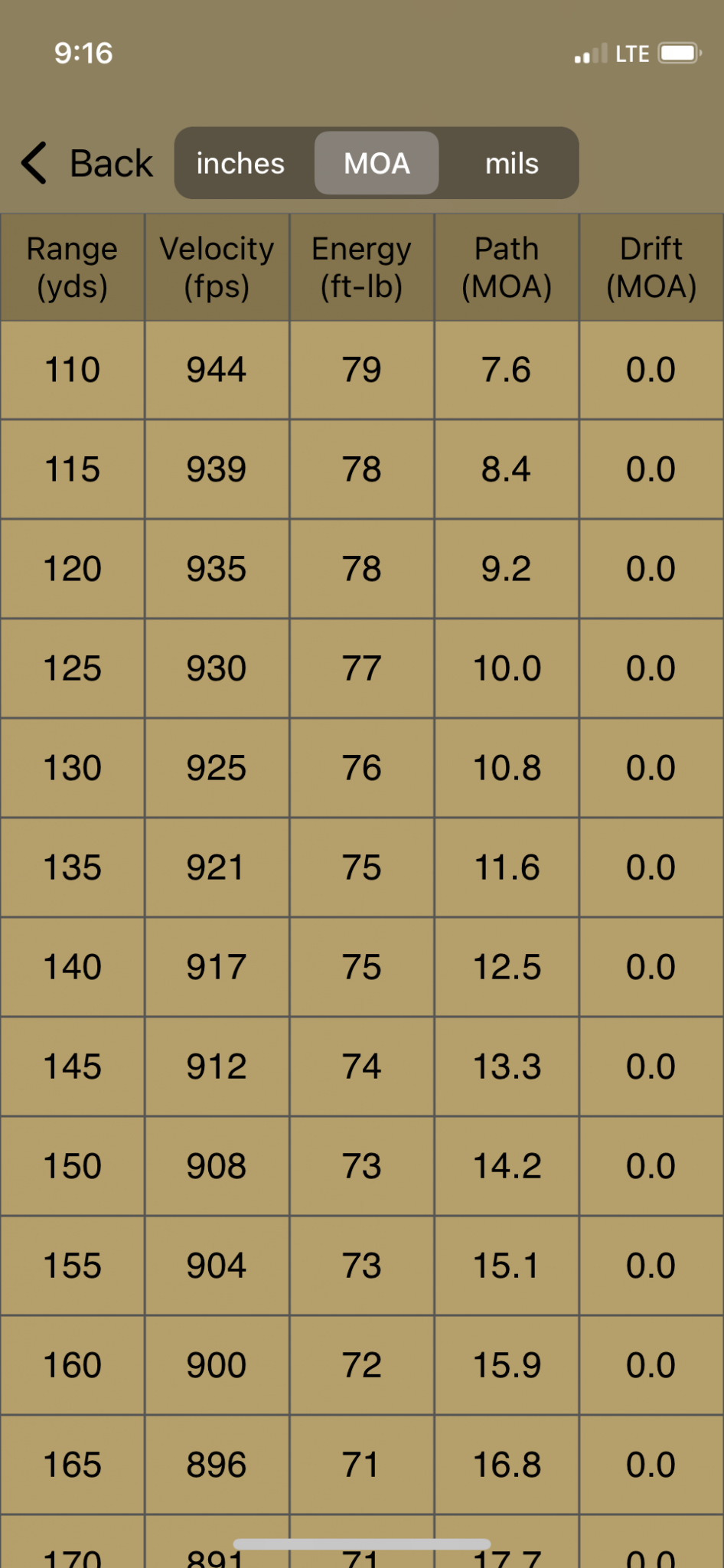

Hey guys, finally got my EGW 40 MOA rail for the T1X. Looks great and functions even better. I got everything mounted including my Vortex SE, but how do I find dope for my rifle? This is the first time ever zeroing a scope like this, and I need help. Also, I plan on getting a kestrel eventually, but where is a good place to start for ballistics applications?
I plan on taking her out to the range for the first time this weekend, so any help is appreciated!
I'd recommend getting the ballistics application Strelok Pro for your smartphone (assuming you have a smartphone 🥴 ) and play with it for a while to get to know it before you try inputting data. You'll certainly want a Kestrel, like a Drop 3 that can pair with the Streloc Pro that give you information on atmospherics or the larger Kestrel that also give you wind speeds. Also, you'll need a good chronograph like a MagnetoSpeed or if you need to go much cheaper, the ProChrono would be a good choice. You'll need those devises to get and record your ballistic data.
Here's a video on the Strelok Pro that you might find helpful regardless which app you might be interested in:
I'd just start by bore sighting it when you get to the range. Depend on the distances your range has, you can get actual Dope. But I'd start at 50 and go from there. Get it zeroed and record all your data at each range.
As for ballistic apps. I've got streloc and I've got GeoBallistics. They both have their pros and cons. I'd start with the free version of either.
Reactions: Nicholas Baio
there are some free apps. you can also find ballistic charts for various ammo and use that as a starting point.
I have an iPhone!

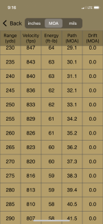

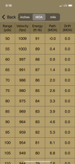

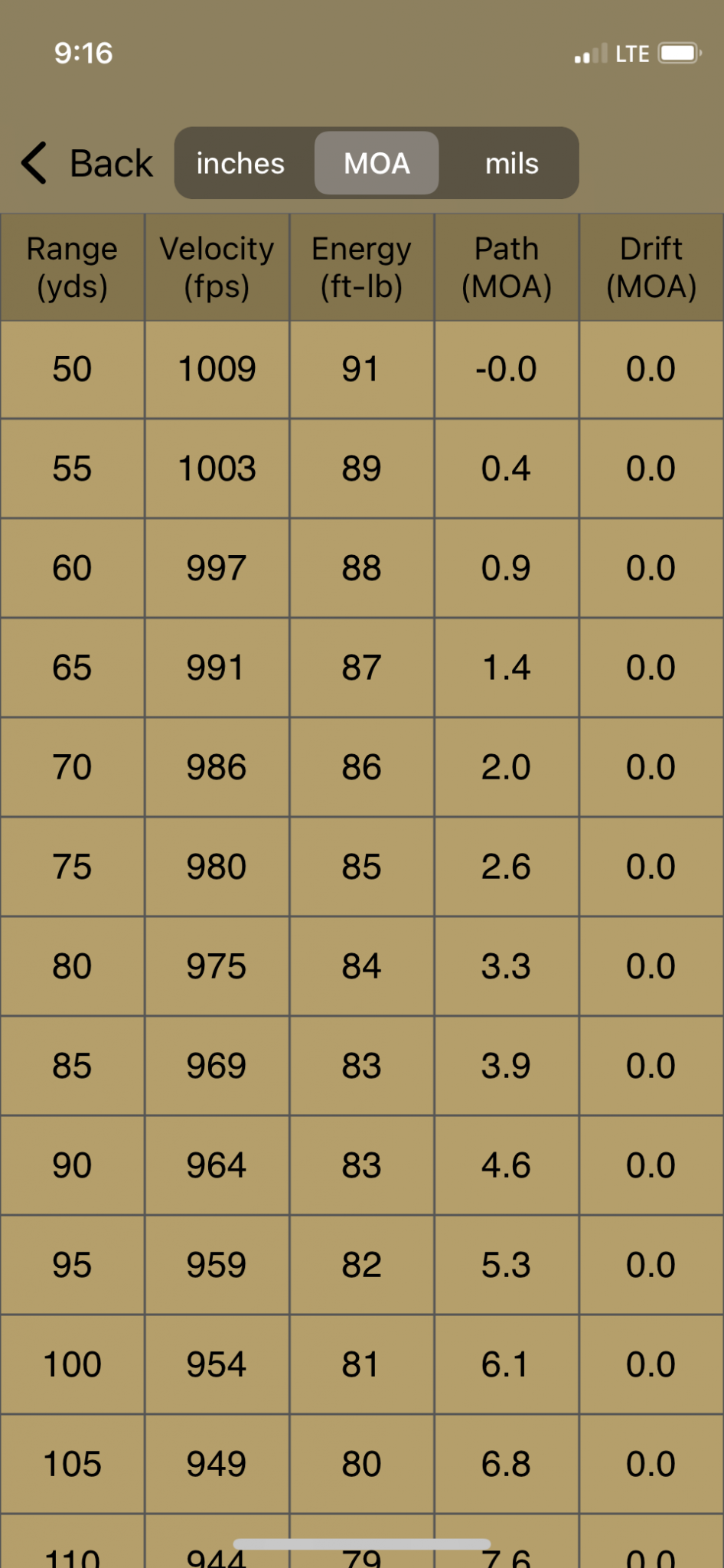

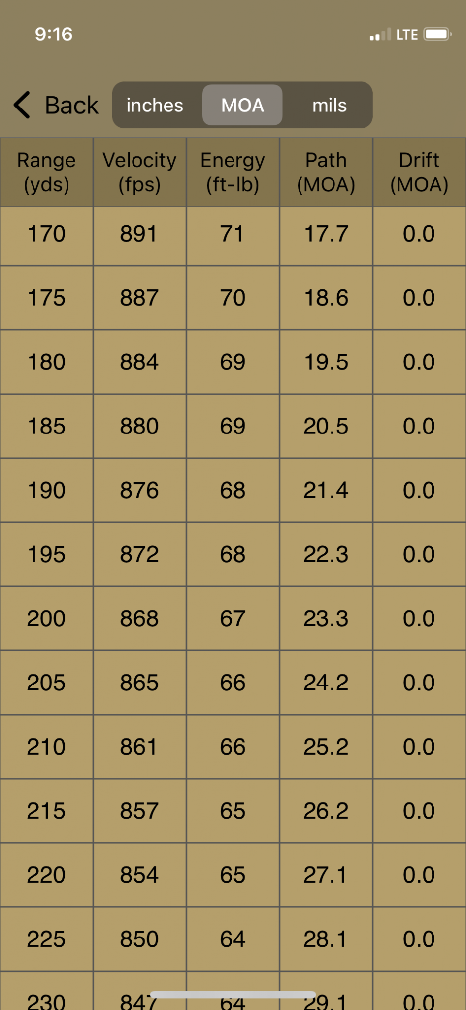

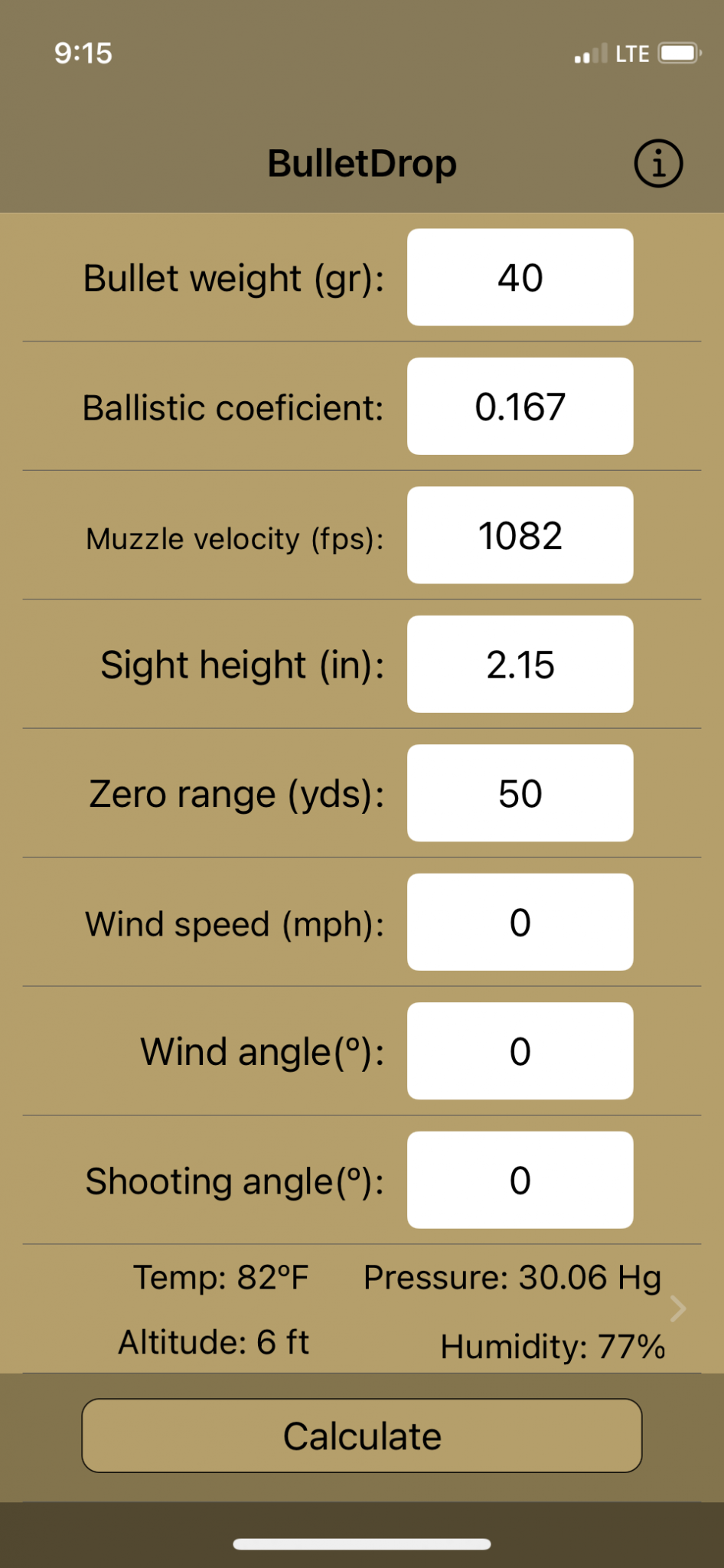

How do get validity numbers without a crono?
You to have some valid numbers to work from, it’s all math.
In my case the temperature and my particular ammo seem to run very close: 72F = 1072 FPS, 57F = 1057 FPS
This gives me a baseline on match day when I can’t shoot through a chrony.
If you have your documented hits at various ranges, with accurate clicks, you can still get extremely close. Just remember, every bit of info you read off some site, post, ammo box, etc. must be verified before you can trust it.
I can give you all the numbers I’m using, but even with identical equipment, it would still be just a starting point.
Thank you for the offer, I will start from scratch since I shoot lots of different ammo brand and will be a new learning experience for me.

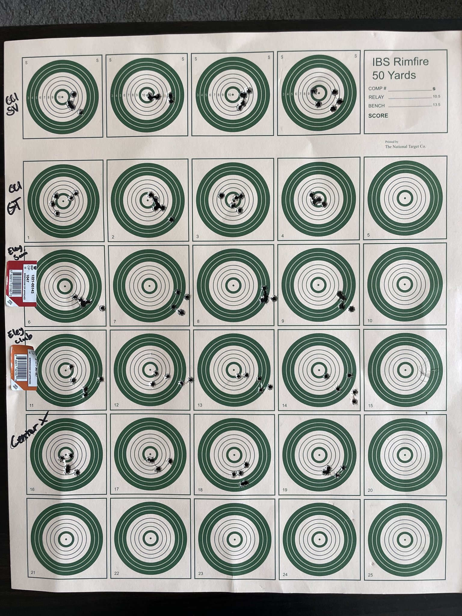

Hey guys, took her to the range here in north Texas and here were the results at 50yds! The advice to bore site at 50 was a huge help. Very quickly got on paper and then started testing some different ammos.
I am running a Q Erector .22 with these groups.
Funny enough, I ran into a very kind gentleman by the name of Wayne who shoots at North Texas rimfire. I noticed he was shooting a badass setup, mixed up his RimX for a Vudoo, but nevertheless started talking and asked him where I can get started around the area. If you shoot at North Texas Rimfire, it would be awesome to get more insight from you!
Thanks everyone for the suggestions. I’m ready to have some fun!
