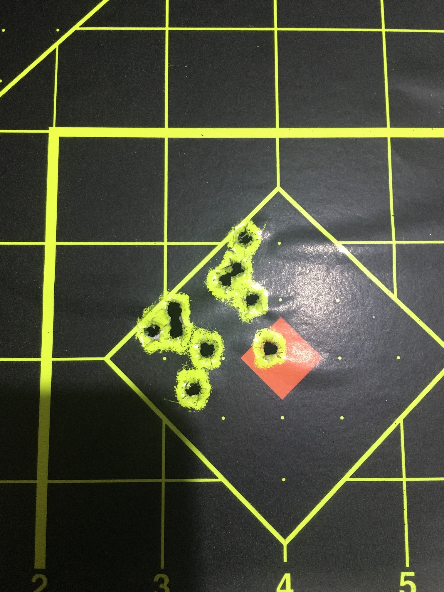

of old, improperly stored or dropped rimfire ammunition. I was lot testing Eley black box...
eugSOPvGySI-Zq2B2YN4zKcmsZ-Z9ysN6Z7VXbmwrixO9lXri_sXI20USoiCuiipDcawBRGj9KKBwlxNvQ=w708-h440
Different labeled mv's to determine which fit the rifles harmonics.
Problem was poor consistency. 3 or 4 shots in the same hole, then a hot round confirmed by the chronograph.
I was not impressed by the quality of the ammunition sent to me for testing. No how, no way.
Dialed off vertical to maintain point of aim for testing,
and this was typical of all boxes delivered.

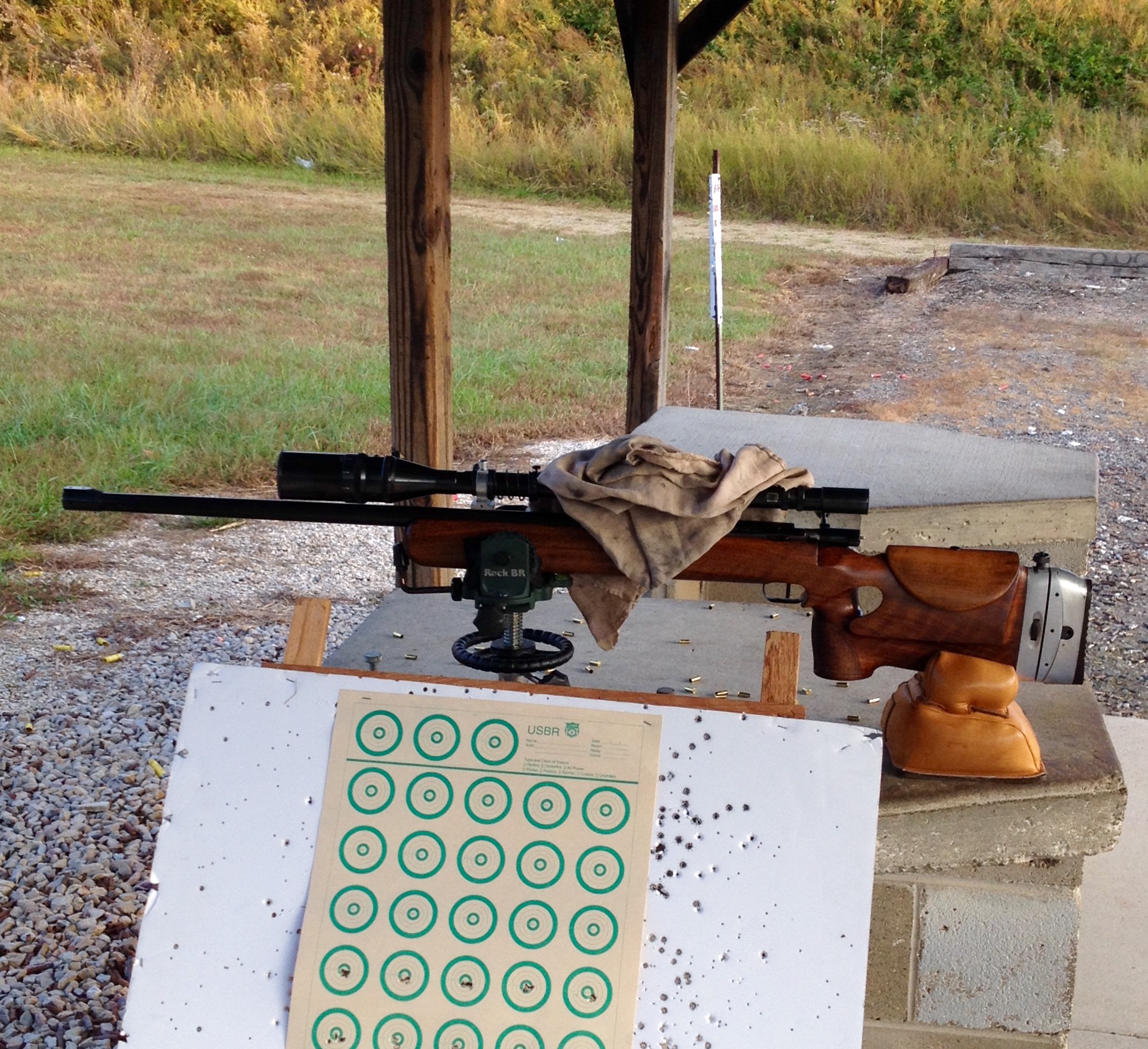

I am not a BR shooter but do go out and play with some nationally ranked BR shooters from time to time who live at my local club range. They all shoot Eley Black except for one who mostly shoots Lapua CX. Just an observation. The guys with the $4k hand bilt rifles with match spec chambers in hand-lapped bbls all choose Eley. I often use Eley black for local matches also. It always seems to out perform Tennex for me but this is counter intuitive. Fresh bricks that have not been stored in hot warehouses seem to shoot better and with fewer flyiers also. When I am working up a new rifle, I like to shoot 25 rds consisting of 5-shot groups after I have fired 5-10 rounds to foul the bbl. I will usually test, Lapua CX, Midas-+, SK std+/rifle match, Wolf Match Tgt and MX. Then I will test RWS R50, R100 and Norma Match. Finally, Test various lots of Eley Blk and Tennex. If the rifle is a serious piece, like an Anschutz, Winchester M52, Vostok CM-2, Match grade Remington, etc, I will usually not venture outside of the list above and generally if I am lazy, I will only test the Lapua CX and Midas-+ and the Eley Black as usually with those three, I will find a winner. Plus if a rifle will shoot Lapua well, then it will also shoot SK and Wolf well but just not quite as well. It takes a very serious rifle for me to tell the difference between Center-X and Midas-+ but the M+ does shoot slightly better on a windless day. If it is windy, the difference is lost in the noise. I also seem to find that Eley which almost never groups the best in any of my rifles, does shoot really well in windy conditions like the hell hole we have for a match range with its diabolical winds. I think this is because of the different Eley bullet shape. My testing is usually in dead calm conditions but my match shooting is in all different kinds of conditions. What I see in Eley is the groups are usually round clusters where most others including Lapua are in vertical clusters where 3-4 shots are in a tight hole and one strays high or low. Where Lapua seems to excel is that I less lot to lot variance. Eley varies more but they do give you the test MV as an aid to choosing lots your rifle might like. Once I have found a brand the rifle likes, I will test various lots until I find a winner. Our ammo supplier publishes a list of available lots monthly. He will ship or deliver one or more boxes for lot testing. Once you find the magic lot, you can buy as much as your budget will allow. You can clean or not between brands. No need to do so when testing between lots in my opinion. In my opinion, old or poorly stored ammo is never going to group as well as fresh, properly stored ammo. I have seen lots that grouped great last year which sat in my hot, hot, hot garage thru only one summer, fail to repeat their performance after only one year of Hot/Cold storage. Anybody else notice this? I attached a couple of pics of one of my better rifles and a series of 5sh groups it shot at 50y with Wolf MX. Good not great ammo. These are not its best work but representative of what what a good factory rifle can do with decent ammo which it likes when shot from a solid rest in low wind conditions.

shot so many diffrent brands , likes Eley match the most but to expensive to hunt with
Pretty much my CZ455 tacticool with Federal Hunter match (pretty cheap here in AUS)
its my hunting rounds as it hits rabbits hard enough
and will do this all day at 100
its got a 1.6inch spread vertical but i was facing a wind coming from 2.3 oclock ,, but all day every day that is Rabbit Minute of angle at 100 :)
