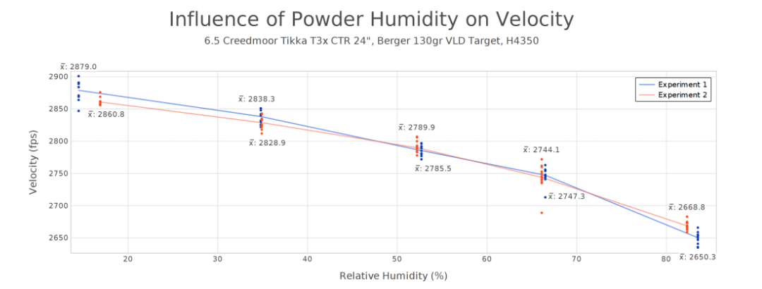

How does humidity affect powder? A new experiment
mc10
Feb 27, 2021
38
125
Boston
chronoplotter.com
The humidity of your powder can have an impact on your load's performance and consistency. But there's little in the way of actual public data about it. I wanted to collect the highest quality data I could, so I sent 120 rounds downrange to measure just that.
I tested H4350 at five different humidity levels and measured how moisture affects the velocity and pressure of a load (spoiler: it's significant). I then isolated and measured exactly how much of that effect is due to the change in weight of the powder vs. the change in burn rate.
Let me know what you think!
I love a good graph, excellent work. Backs up what everyone has always said but with some decent data... though I never imagined that it would effect it to that extent! 200 fps is crazy
Its very substantial if you live on one of the extremes for humidity. I live in semi-aid desert. I will notice a 5% diff in powder from opening a 8lb keg to the powder at the end.
(I literally did a ton of testing from weighing both and counting the actual kernals and 5% was the diff. That was equal to roughly 1.5 gr of powder for this particular powder.)
I live in a very dry climate, and I know that before I started humidity stabilizing my powder I would get a 40-50 fps velocity increase from the first rounds I loaded and the last rounds I loaded that had been sitting at the top of the powder hopper for 2-3 hours drying out. That was with Varget in a BR, so small changes to powder can make a bigger difference due to the smaller charge weight.
After humidity stabilizing my powders, my powder charge weights actually decreased noticeably for the equivalent velocity. My Dasher load for 109 Hybrids at 2875 fps is only 31.0gr of powder, because the dryer powder has more propellant when measured by weight (and has a faster burn rate). My max load in Dasher with 105's was only 32.4gr of powder at nearly 3030fps, much faster than most published data specifically because of the humidity differences. Stabilizing my powder, however, has ensured that the first and last rounds I load are the same velocity along with every round loaded in between.

Thanks for doing the research MC10, superb write-up (commented in your blog as well). Your solid scientific approach is very impressive.
Live on the Gulf Coast so relative humidity (RC) is often high: 55% to 65% is typical, but when the blue northen wind blows in early winter, RC can drop to the 30 % range, or below. Have figured out some time ago that storing powder in the garage is a bad idea. So now i have a thin sided wooden storage cabinet built to spec in my reloading room, and the combo of AC and a large dehumidifier machine keeps humidity reliably between 45% and 50%.

Thanks for sharing your testing! The results are convincing. I wasn’t expecting that much change within just 24-48 hours. That can throw off a load if you’re traveling to a different environment, especially if you chrono only once ahead of a multi-day match.
Norma also published results from a loaded ammo humidity test in their article. They didn’t measure weight but did observe significant velocity swings over time.
Humidity testing loaded ammo is definitely on my to-do list. I’d be interested in learning how neck tension plays a role, and re-confirming sealed vs non-sealed (like in your test). Then repeat over different time frames. This may be quite a few rounds…..

That is great data. Appreciate all the trouble to do the testing and record and present in an accessible form.
Keep in mind, relative humidity refers to the amount of saturation that particular temperature of air has. The dew point is the temperature at which the air is fully saturated (100% relative humidity). The actual amount of moisture in air having the same relative humidity can be drastically different depending upon the dew points. That is why dry climates with 100% humidity can still be dry, but 80% humidity in the during the summer in the east coast are pretty wet (and FLA is even worse), esp. when compared to the west coast.
So unless your dew point remains constant throughout the year, working solely off of relative humidity will be very inaccurate with real world shooting. One really needs to combine the relative humidity with the dew point during the testing period in order to come up with how moisture in the air affects powder for repeatable results.
Good info about the dew point. I’ll track that too throughout the year. I’d been meaning to do this for thankat few years anyway.

Sealing a case (with primer sealant) to make it water tight helps and hurts: Humidity soak goes away if you seal every case properly (not so easy in practice), but then neck tension becomes more variable: Sealant acts as a glue. You probably have to use very little and apply it exactly the same on each loaded round to see a net benefit, and not so easy to do by hand. I will not use it in future for target ammo, but will continue to use it for hunting ammo.
‘Bullet weld’ is real and is the dominant effect that dramatically changes bullet grip and therefore ES goed way up, so recommend you load long and reseat the morning of the match.
It might help to transport loaded ammo in two double sealed ziplock bags with a humidor pack inside for humidity control (pick a relative humidity value similar to your reloading room conditions).
Or simply ignore the problem and learn to live with your ES. Trying to control water content of loaded ammo is going yet another 10 feet deeper into the proverbial rabbit hole…. Where does it ever stop?
Been obsessed with this lately too. Playing with 49% humidity packs. Most of my opened jugs (Utah. Humidity in garage usually about 20%) registered about 35% RH with a D2 drop. It takes a couple of days to equilibrate and get a good reading. I was taking out a sample into a mason jar and putting in a humidity pack for a day or two before reloading but it was getting tedious so I said F it and just dropped 2 humidity packs in each 5/8# jug. One pack seemed like it was taking too long to equilibrate to 49%. I haven’t shot this ammo yet but have long wondered what, besides powder temp sensitivity is giving me variable velocities between batches. Hopefully this works.
I selected 49% packs because from what I’ve read, powder comes from factory at about 50% and 49% is what amazon had.
I used to be pretty careless about leaving powder exposed to environment in many ways (eg leaving charged but unloaded cases laying out overnight or leaving powder in the dispenser). Not doing that any more!
For they guys drying out powder or putting desiccant packs I’ve thought a lot about that and concluded that’s a no bueno idea. I worry that book and QL data may overestimate your safe load/pressures if their data are based on test pressures at 50% RH. (Indeed I’m surprised the QL program doesn’t have an input for RH%.). OTOH, if you have a load that’s safe with say 10% RH, there’s pretty much only one direction it can go namely slower/safer. I decided to go with the middle ground, ~ 50%
Interested in others’ thoughts and observations.

Likewise, I've been giving the issue of humidity a lot of attention lately, like since the first of the year. Here around Phoenix, AZ the RH tends to run between 10 and 20%. Sometimes below 10% and on a few occasions when monsoon rains happen, it can jump to 90% and stay up for a few days. That low RH around here acts like a dry sponge and really pulls moisture out of things fast (an issue hikers tend to underestimate).
Using a Drop2, I found the RH for some of my powders that I've been using were between 35 and 40% and my never opened jugs and bottles were 45-50%. I'm still collecting data to see what kind of difference it makes, though I'm sure there is a difference, just hard to see when shooting in variable atmospheric temperatures. When charging cases, I've never left my powder out or exposed for very long, but now I'm making it a point to get the powder back in its container ASAP after charging and covering all the charged cases with the bullets before seating to further minimize exposure to the low RH.
Recently, I've put a 49% humidity pack in a couple of those containers with powder that's at ~35% and will see soon see what kind of performance difference I'll get.

Good to see people monitoring the RH in the jug. So far, I haven’t seen any changes in baseline RH except for what may be measurement error (+\-.1%) in my jugs in atmospheric humidity ranges from 40-100% and temperatures ranging from 30-70 degrees F. One interesting thing I found was smaller powders have less RH relative to larger. My small N133 had ~56, N135 ~58, and RL26 ~60. I wonder if kernel size is a factor in powder humidity?
bolt action reloading on youtube did a video 4 months back testing humidity vs velocity. looks like humidity has a huge impact in that video also.
I think I watched that video too... If I remember correctly (and that's iffy nowadays) he surmised that once opened, and over time, the powder will "soak up" humidity/moisture which increases its weight... So each individual kernel of powder gets heavier than it was when it was sealed in the container... So as time goes by you end up dispensing less powder to arrive at your selected charge because the water adds weight.
So even though the scale says the charge weighs the same, there's less powder.
Or something like that.
Mike

That's correct. And in addition to that effect of less powder per weight, the additional moisture in the powder slows down the burn rate. The inverse happens when powder dries out and often why we hear about reloaders using powder for quite a while and finding that it's faster than before (or slower in cases where they're in areas of high humidity).

^^^. That’s substituting one source of variability for another IMHO
Don’t want to start a food fight, but what little i remember from chemistry class, the volatile organic compounds (that weird chemical smell you get when you open a container) which is present in the powder kernels will slowly evaporate inside a recently sealed container, while some vapor at the same time gets reabsorbed back into the powder, until equilibrium is reached, and the process stabilizes. This should already happen at the factory. I suspect that leaving a container open for several months will cause the vapor to continue to escape and slowly change the chemical composition of the powder, possibly changing burn rate, but i don’t have the equipment to prove this assertion.
I do know that powder manufacturers ship their product in containers that are often far larger than needed, to maintain a specific “vapor space” above the solid powder. Powders like 4000MR are shipped in containers that have almost 50% more space than “needed”, which increases shipping costs. And if you call them, they really don’t want you to add together 12 one pound bottles (even from the same batch number) into one 8 lbs container and fill it up to the brim. [You have to wonder if a near empty container has a different burn rate than a half full container, because the vapor space is so much different.]
It seems to me that off-gassing might be a problem, so i would not spread out powder in a cake pan and leave it like that for days or weeks… or leave containers open for long periods of time, but i have no scientific proof one way or the other…. maybe keeping a container open for 24 hours is ok, but i would not leave it open for a week.
Would like to hear from a professional chemist with experience in formulating rifle powders!
Thanks! Hope this is helpful to folks.
For the folks who do not have time to read the ‘dissertation’ posted above:
The initial hypothesis that some rounds can soak up moisture appears to be true due to a minority of leaky cases being present in each batch of hand loaded ammo (possibly due to deep scratches inside the neck - have a look with a bore scope, you already have several such cases). [These scratched are caused by powder kernels being forced between case neck and bullet, as the case neck diameter start to enlarge, just before the bullet has time to get going.]
Water content of the powder inside the case affects speed (a proven fact) and therefore will push up your ES some moderate amount: In my first experiment, the moisture soak seemed to add 14 fps to the ES - but that is true only if you are outside the node, it is far less if you are in the flat spot (node) on the speed graph. Wide nodes matter, but it hints that it is not the only effect: Variable neck tension and powder weight differences also drives ES. ‘Leaky’ cases contribute too via humidity changes. Higher neck tension helps to avoid moisture soaking into loader ammo, but it does not cure the problem. Hard to detect unless you drag a milligram scale to the match, which probably is not really practical…
Sealing a case to make it water tight helps and hurts: Humidity soak goes away if you seal every case properly (not so easy in practice), but then neck tension becomes more variable: Sealant acts as a glue. You probably have to use very little and apply it exactly the same on each loaded round to see a net benefit, and not so easy to do by hand. I will not use it in future for target ammo, but will continue to use it for hunting ammo.
If you want/need to reduce bullet weld, try testing a batch of ammo without wet tumbling and removal of the carbon in the case neck. I’ve said for a long time that wet tumbling is counter productive for this reason.
Cold weld (not the same thing as galvanic corrosion!) relies on two very clean surfaces in close contact under pressure. In wet tumbled case necks, we have all of those present. The simple solution is to remove the “clean” part of the equation- either by leaving the carbon in the neck, or lube on the cases, etc. Some things work better than others, and as you found some things like your sealant don’t necessarily prevent cold weld.
Reactions: NamibHunter
