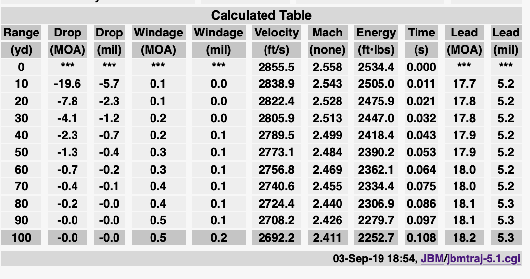

On my scope when I dial the turret up the POI goes up when I dial it down the POI goes down . Eventually it hits the zero stop which is as low as I can go .
You sound like you have no clue,
Shots inside 100 yards require you to dial UP, you have to overcome the mechanical offset of the sight over bore situation
You said you have 4 mils below zero, that serves no purpose at all
