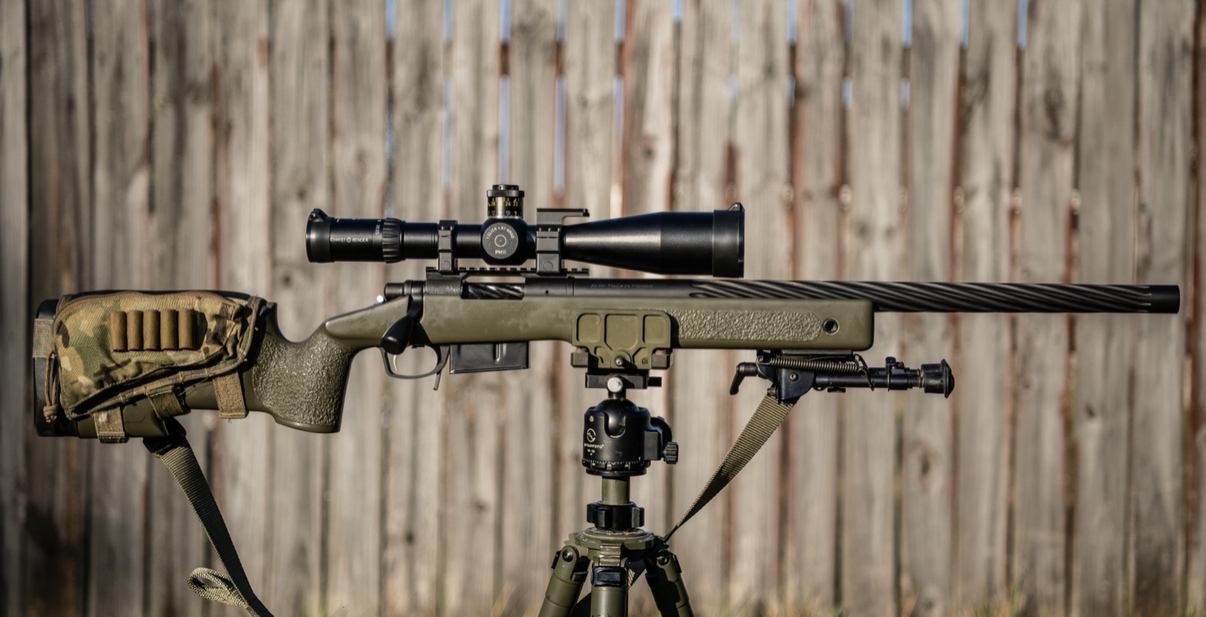

    Yes I’m running a 24” barrel and pushing 130gn VLD’s 2725fps~. Very accurate and consistent.
    My rifle isn’t set up for “true” PRS shooting, but it’s just such a fun gun to shoot, I hate to change much about it.🤙🏽
