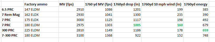

I was looking at possibly getting a 7 Rem Mag rifle but then I just decided to look at the 7 PRC. The 7 Rem Mag has more case capacity for power, uses the same bullet sizes, but I was watching a video and saw this and the PRC is kicking it's butt.
Was thinking of grabbing a Bergara B-14 HMR for $900. Would that be about the best 7 PRC rifle for under $1000?

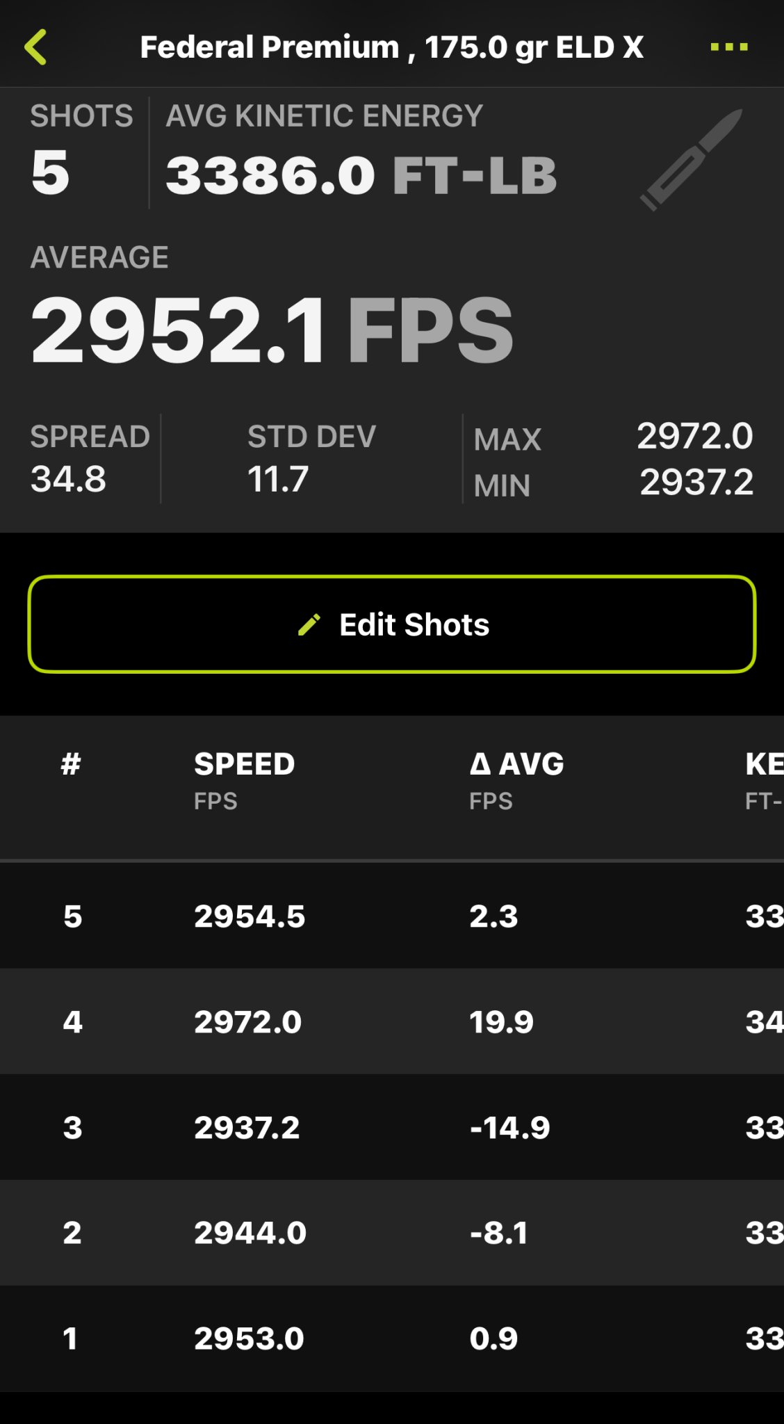

Late last year I did a good amount of research and was torn between 7 Rem Mag, 7 PRC and 300 PRC. I used factory data to help me calculate dope to 1 mile. Based on available data the 7 PRC was the winner due to having less recoil than the 300 PRC.
Fast forward to today, about 250rds into my 7 PRC with 24" barrel, I CANNOT get close to Hornady's advertised MV even with handloads. I can only get low 2900's using H1000 before seeing pressure signs and groups opening up. I am over 150 fps short when using Retumbo at max charge per Hodgdon's website. Your results may vary.

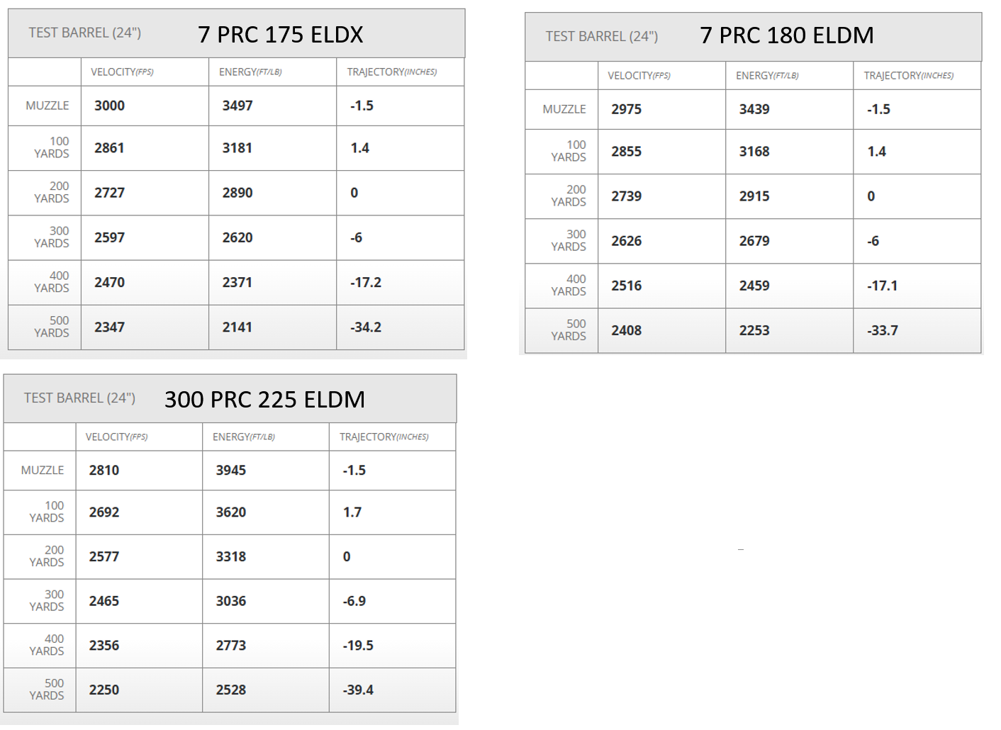

The answer to this question is easy.
The SAAMI specifications for each cartridge spell the difference.
The PRC is designed specifically for long, heavy for caliber, high BC bullets.
The Rem Mag is designed for lighter, shorter, lees efficient bullets (what they had when it was developed).
A 162 grain factory load is considered heavy for the rem mag with a few 175 grain loads available.
A 175 load is standard for the PRC with 180 being pretty common.
A standard bullet for the RM is the 139/140 class make up the majority of loads.
If you handload and have a custom throated RM barrel, there is no benefit in the PRC over the RM. Of course if you lose your ammo on your trip, your relegated to lighter bullet weights and a long jump to the lands with factory loads.
Will these PRCs stay on top for a while or will we see another "better" calibers in say 3-4 years?
Hornady has done a great job with basically every cartridge they have released, the likelihood of a new 7mm magnum appearing that is "better" is pretty slim.
Although I could see a short action 7mm magnum cartridge becoming popular but that wouldn't be better, unless you wanted a short action.
All things being equal, the PRC isn't going to get you massive gains over the Rem Mag. The PRC is better designed to shoot heavy for caliber 7mm bullets better than the Rem mag. I've noticed I cannot seat bullets out as far in my Tikka in 7mm Rem mag. So if I decide to rebarrel, I'd probably go with PRC.

Fast forward to today, about 250rds into my 7 PRC with 24" barrel, I CANNOT get close to Hornady's advertised MV even with handloads. I can only get low 2900's using H1000 before seeing pressure signs and groups opening up. I am over 150 fps short when using Retumbo at max charge per Hodgdon's website. Your results may vary. View attachment 8460524
From what I've seen box speeds are usually based on a 26" tube, which would be good for about 60 fps (or more) over a 24. Personally I'd keep increasing charge weight until I saw pressure signs and then back it off from there (obviously be careful).
Looking at your charts I'd say 2810 fps from a 300 PRC with a 225 is on the slow side, I'd imagine you'd get 2900-3000.
Also the 7-300 PRC i've seen are closer to 3200 with a 180.
No, not in this case. All data that I extracted during my research PRIOR to settling with a 7 PRC are from 24" barrels. Even Hodgdon's and Hornady's reloading data are 24". No way a 225 ELDM can get close to 3k out of a 24" 300 PRC. My buddy's 30" 300 PRC is maxed out at 2990 with 225 ELDM with H1000. He run's em at 2950 to be safe.
