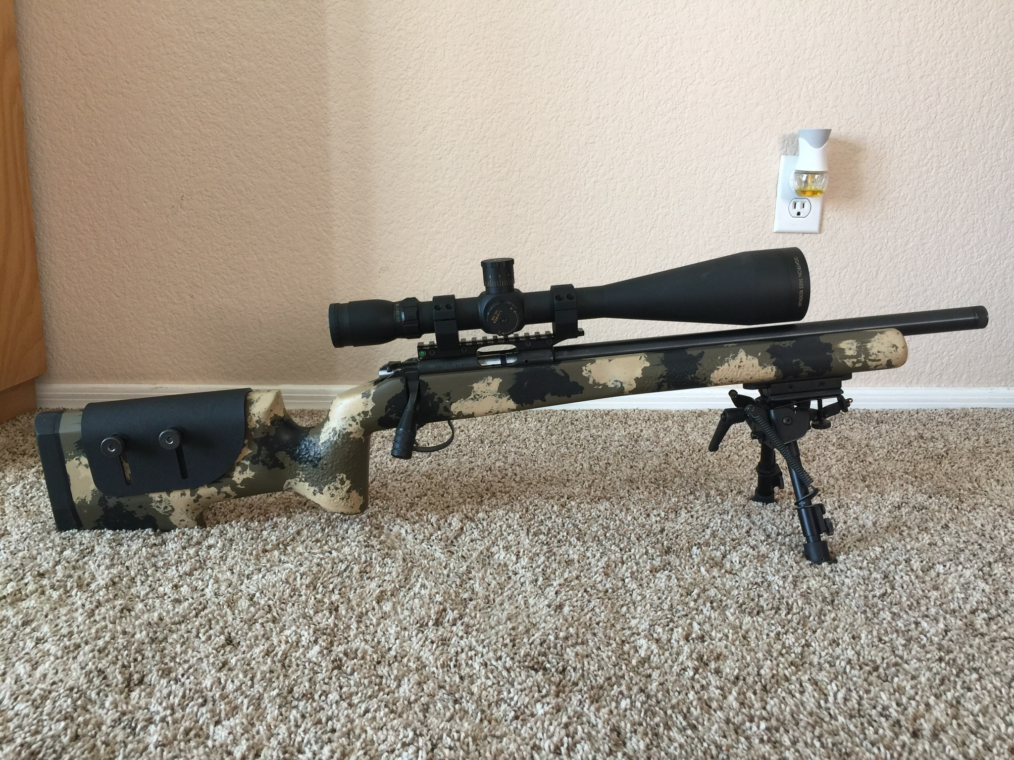

I ended up buying a Sightron SIII 10-50x60 I had the 8-32x56 but struggled below 40 yards I really liked the glass so figured upgrade and focus down to 13 yards. Once I get it and mount it I will be going out to sight in and start shooting toothpicks and cards.

Got it all mounted up and I am loving the 10-50x60

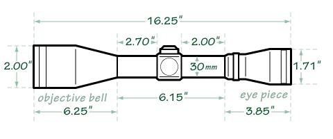

I first ran into these while shooting my first intro club IR50/50 Match. They allow up to 32x with 1/8 MOA clicks in all but the lowest daytime light conditions.
Specifications
Part # MT83244 Eye Relief 4.0″ Length 16.25″ Weight 26.0 oz. Tube Size 30 mm Color Matte Black Lenses Fully Multi-Coated Magnification 8 – 32 × power Objective 44 mm F.O.V. 9.3 – 2.5 feet @ 100 yards Parallax 10 Yrd Min Click Value 1/8 M.O.A. (40″ @ 100yds over-all on both W/E)
That is a good looking scope.....I put a 5 X 25 S&B on my Annie......but I'm gonna have to look at this one
